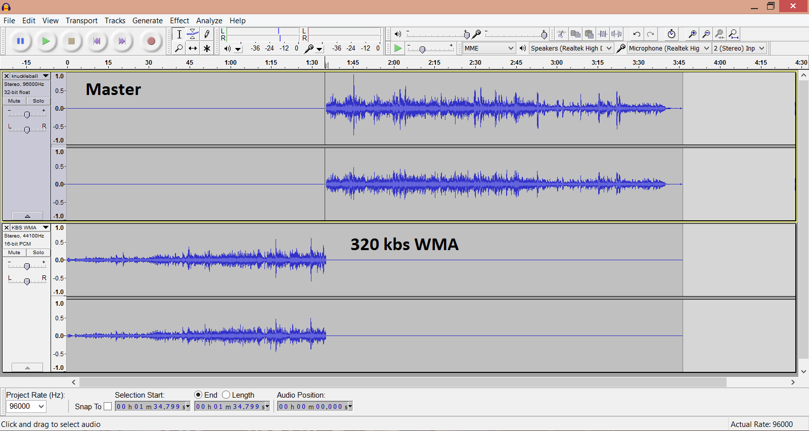

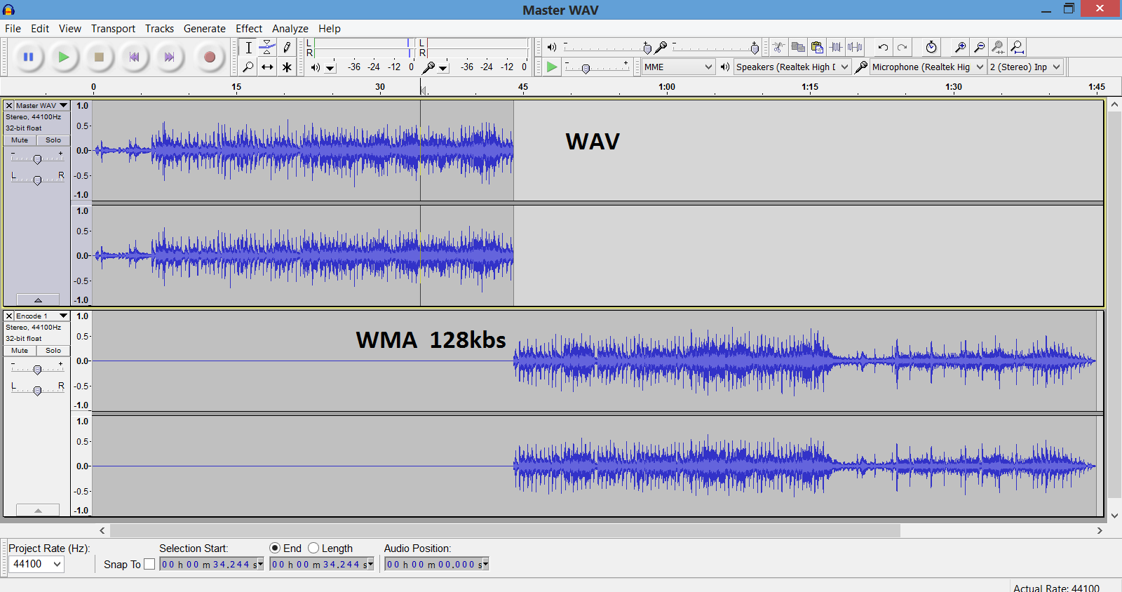

So this is what you were all listening to.
The title of these was 'Just For Fun' and in a way that's all they are really. Now that you know what they are, you might be able to look back (or listen back 😀) and hear the effect/s for real.
The first track starts off as a direct rip but switches part way through to a lowly WMA of 128kbs. Listen carefully to the sibilance and the backing tracks around the area of the change. Its quite noticeable. I suspect some would perceive the WMA as 'preferable'.
SY's test track in many ways highlights the effects even better but in a different way I thought. The latter half of the track is the original master and that really does come across as more focused and a little cleaner. Listen to the vocals at the changeover point. Its quite an obvious change, almost as if the timbre has subtly altered. The master copy seems to have a slightly narrower but more focused width or soundstage than the compressed.
Again, thanks to all that listened and contributed.
(this thread raised questions for me... I was surprised that Audacity allowed two different file types to be worked on like this... but it seems it does. I even went as far as loading parallel tracks of different formats and bit rates and they all played simultaneously)
