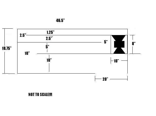

I have two KEF B139 that I'm trying to design a horn for, for a fixed space under a sideboard at home, gross dimensions available are: 46.5"w x 16.5"h x18.75"d. I live in a tiny house-so please do not suggest any other designs as this is the only space I can allocate to the enclosure.
I plan to mount the drivers isobarically mag-2-mag (to use the mags as bucking mags, old CRT sat above enclosure). The face of one subwoofer will be at the throat, the face of the other in the mouth. The enclosure I mentally came up with is pictured (crudely) below and the T/S specs I've pulled of the drivers are below, averaged from the two drivers and then the net figure from wiring the speakers in parallel to get down to a 4ohm load for my amplifier:

Hi TheBaronGroog,

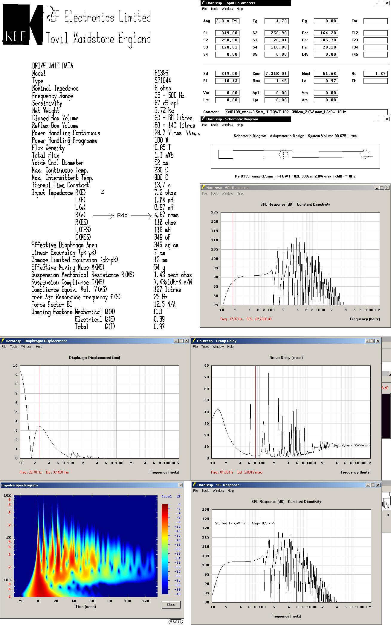

There is a problem with your dimensions, the duct section widths plus the (5) board thicknesses add up to more than 18.75". Anyway, I stuck your fold into a drawing, and derived the input values for Hornresp.
As I do not have the T/S parameters for an isobaric pair of your Kef B139 drivers I entered the same parameters as bjorno (for a single driver).

Hi TheBaronGroog,
For what it's worth, the enclosure seems to work fine as drawn, and the mouth is plenty large enough in respect to the Sd of the driver.

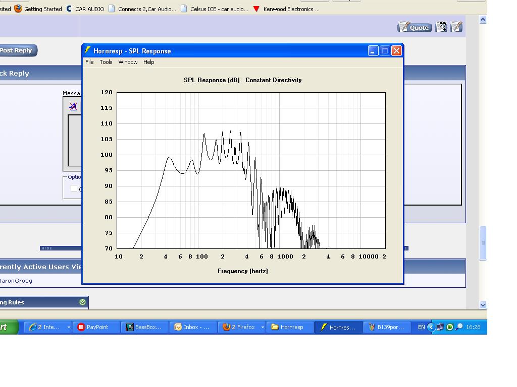

Yes, seems to, quite a lucky guess then on my 1st forray into horns! -I'll try it with the drivers in the isobaric config-what differences would you expect to see?

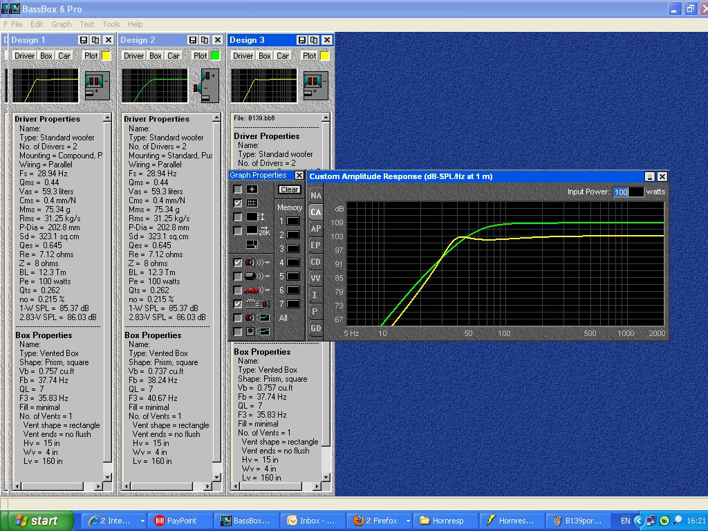

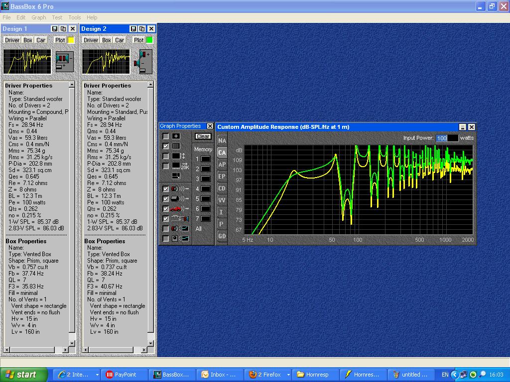

I also ran sims in BBpro, in both clamshell and non-compound vented enclosures-using the same outer box dimensions and 15"x4" vent 160" long, see the results below, on set of results include port resonance-comments would be appreciated as the vented enclosures seem to have a 3dB gain over the TH, which I found odd! Other than output what would be the pros/cons to each design?
Hi TheBaronGroog,
The TH is driven 1W/8Ohm (Eg=2.83V) / 2pi. What are the conditions for the BB6Pro simulations? It looks like it says: Input Power 100 watts.

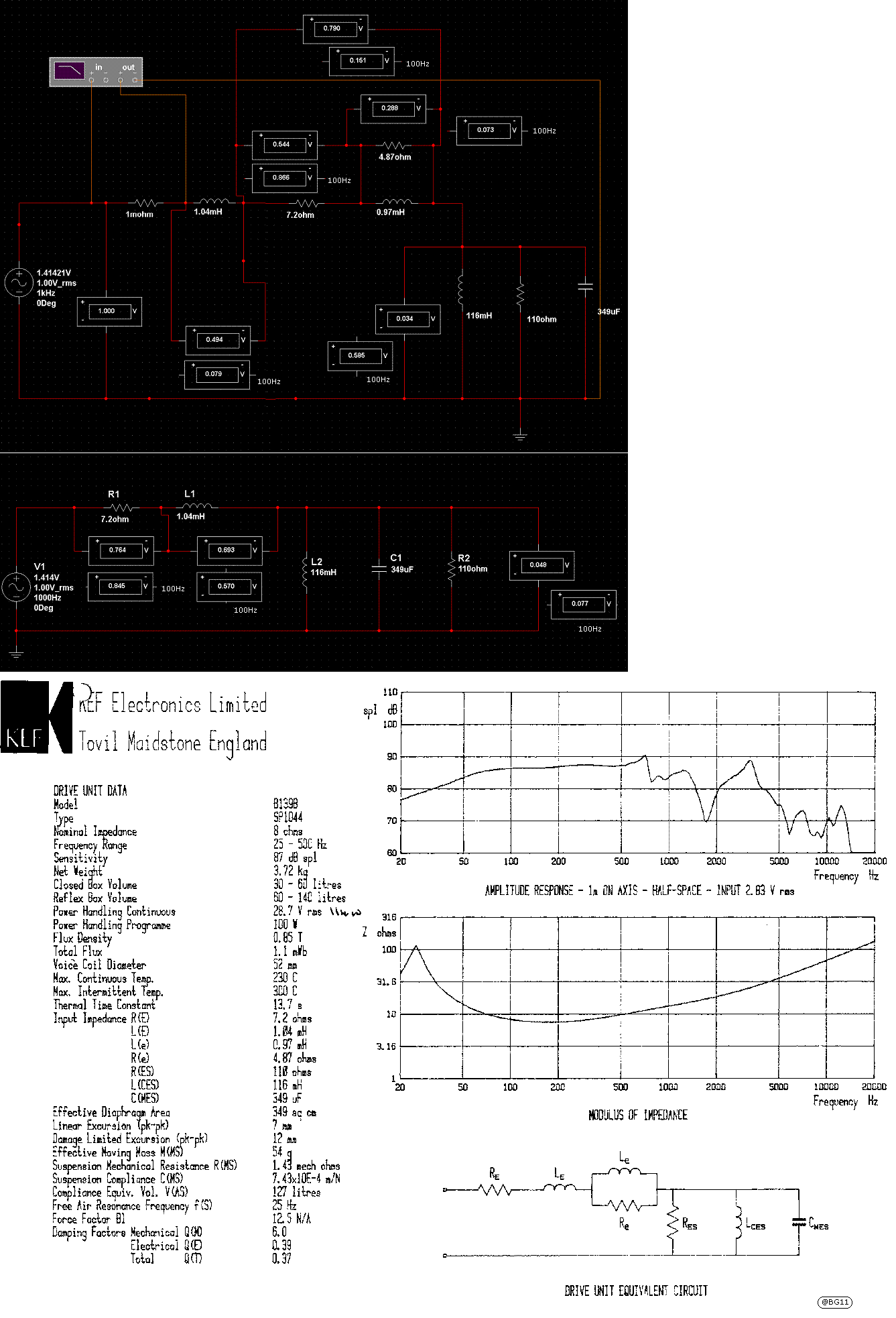

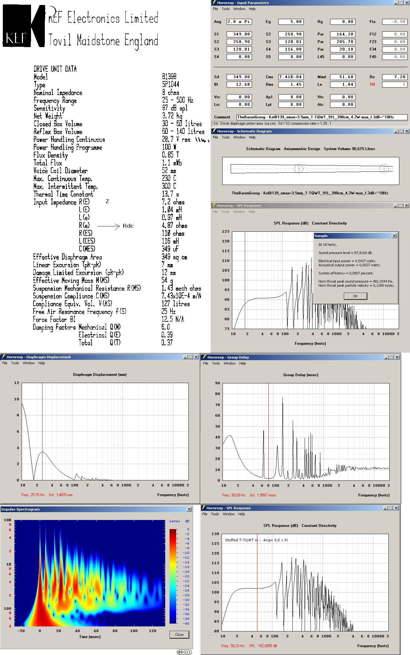

...FYI: Re=Rdc= ~4.9 Ohm for Kef B139B..See the simulation data example when used in a one driver T-TQWT:..

Discard the picture in post #6:😱 4.9 Ohm for the KefB139b is not true.. ..should be 7.2 Ohm..Sorry for the mess..😱 Updated picture:
