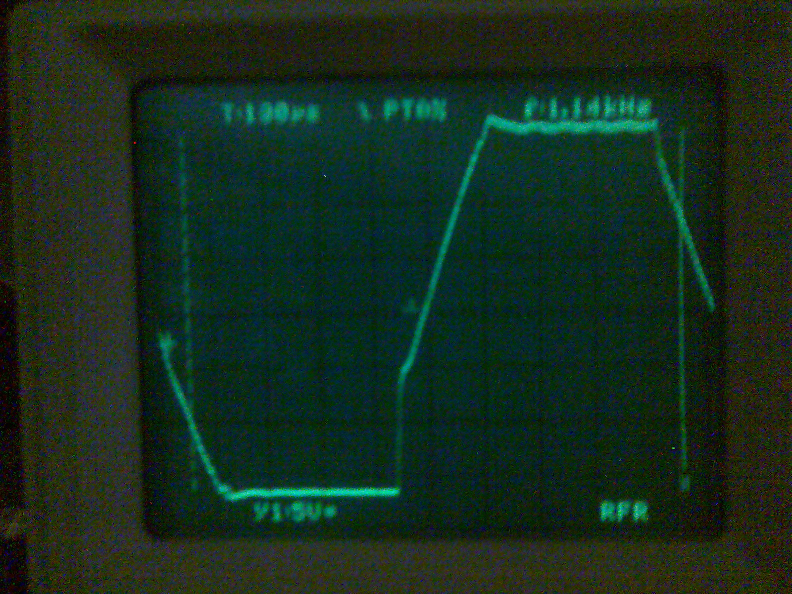

This picture shows what happens if negative clipping is left uncontrolled. 1Khz open loop gain is 72dB. There are integrators in the circuit...
Your amplifier is so clean because it's not really clipping.

My amp[basically with a clocked modulator frontend] is very well clipping as one can see the waveforms in my post.

Oh, don't worry, small quantities of these prototypes are already in the powered speaker US market, it has far more advantages than disadvantages, some customers think that it outperforms many rack mount amplifiers. You are just persuading me to add a pre-clipper like yours in the next PCB revision, which I'm about to finish, and make it even better ;)
The modulator itself is probably the oldest part of the design, it calls for an update. I have also discovered slight overshoot in the square wave response that I want to get rid of. This thread motivated me to do many performance tests. My will to offer the best performance is at least as strong as yours :D

Keep saying it as pre clipper[Since you are unable to figure out what exactly i use to get clean clipping ], as it will help you alot;)

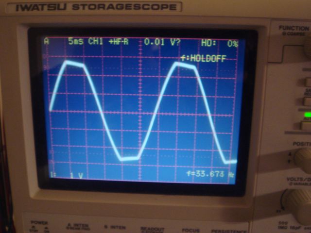

Well, isn't it more interesting on how does the amp behave BEFORE it clips?
Clean clipping isn't that hard unless you go for higher post-filter feedback, like 20dB@20kHz.
Nothing wrong in pre-clipping and letting some stages stay below clip level...
The signel is already spolied anyway.
Clipping recovery behavior tells a lot about amplifier transient response. If the loop has poor stability, it will become evident at first glance by looking at 1khz clipped sine. Square wave test provides the same information but at the expense of increased amplifier stress.

As Eva said, non-linear element in feedback loop work well to achieved good transient response...Other way is to have small gain switching amp with hight voltage swing front end...No need to pre-clip anything with booth option.
I am going to try an analog switch in feedback path, which turns a global prop-integrator feedback into low feedback proportional whenever internal overload (slew overload, clipping, overcurrent etc.) is detected.
The diodes/zeners in feedback path always degrade THD before clipping in my scheme.

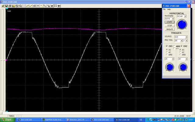

I will make the start with two of my oldies:
My current design approaches are simply not ready yet and still just
on the level of simulations.... so I hope you are not bored by my old stuff.
It is just an example of how I would love to see you turning your comments into a technical discussion.
1. A low feedback solution, providing approx. 30db feedback over the entire audio range. Well 30db in the shown load case (clipping into 2R5), which makes the weak supply sagging from +/-55V down to approx. +/-30V...
Clocked design.
Feedback structure is mixed pre & post filter feedback.
Already the natural clipping behaviour is absolutely blameless.
Related Schematic: schem_lowfeedback.pdf
Related clipping screen shot: clip_lowfeedback.jpg , (10:1 probe)
2.
Mostly the same but with less gain in the inner loop (more rugged vs. disturbances for the breadboard design....) an additional OP amp and nested feedback structure. Well and with a stronger supply... The additional OP enables symmetric input, higher input impedance, higher closed loop gain and at the same time higher feedback.
Feedback structure is nested.
Overall we may simplify (well, for details we may not.... feel free to simulate..) it to a feedback somewhere around 60db at 1kHz, but with mostly integrating behavior over the audio band.
Clocked design.
Clipping behavior is showing a medium level of "stickyness", but still not catastrophic to my ears. The shown screen shot shows clipping at 500W into 2R.
Related Schematic: schem_highfeedback.pdf
Related clipping screen shot: clip_highfeedback.jpg , (10:1 probe)

I mean "natural clip" because I can get many important info on it.
Sure, you can force limiter pre-clip for clean (loss efficiency), on commercial audio and high power ,this is possible and help reliability.
In High fidelity is important show natural clip as clean possible because use this area near vcc.(dynamics is not controllable).
Then, to get a clean clip is not easy, this depends on many factors.
hysteresis, NFB, delay, phase shift (input / output), Deadtime (time and phase).
and last .. modulator (if clocked yet other factors). trw linearity and geometry.
this if I want perfect class D amp. or supplies with +/-80V and limit at 60vP out.:)
