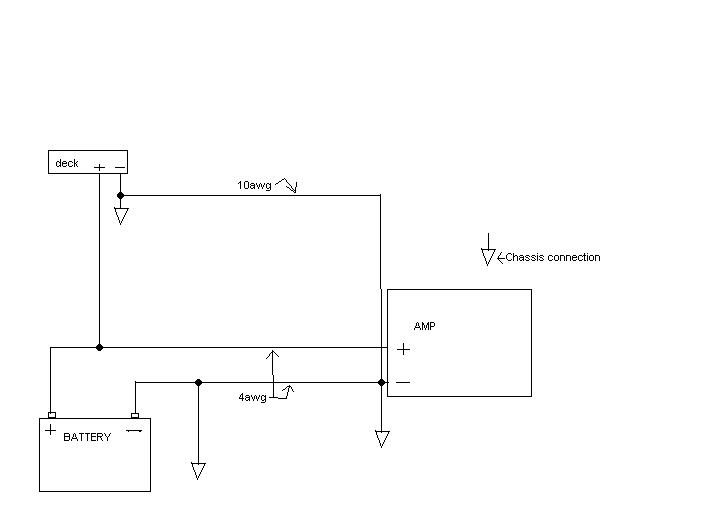

The headunit is grounded by the harness, which I assume is grounded by the chassis. So I should ground the HU directly to the battery? Should this solve my problem?
I always connect every peripheral to the battery. That way I know what my ground is. Also, I ground locally to the chassis as well.
If the amps is still squealling after that, there may be something else going on.
1) How old is yor car? More then 10 years ? (are there emi protection in spark distribution?)
2) DO NO CONNECT GROUND DIRECTLY TO BATTERY BUT WITH AS SHORT AS POSSIBLE CABLES TO CHASSIS (the chassis is the best "wire" you can use)
3) Remove the ground connection to the end of signal cable (near the amp) ... in my experience this will be the best solution (if point 1 e 2 don' t make effects).
At the end you can try small 1:1 signal transformer, but I don' t know where to find (installers?)..... this is the quickest solution but is the most expensive.
Hope this will help

car is a 1997. Could you explain step 3, I don't understand. Thanks for your help
Spike, read my reply to this on page 1. I'll explain this best I can. This not written in stone and I'm sure some will disagree. Rinox..step 3.. he is suggesting you cut the ground conductors of you RCA interconnects which goes along with what I was saying in the reply. Though I wouldn't cut it, ya don't want your wiring all chopped up. A 100 ohm resistor in series with the RCA ground would work but, thats just a patchup. You want the grounds of the deck and the amp to be as close to one another as possible(ELECTRICALLY!). If the deck were in the trunk, 6" from the amp, both their power ground leads tied together at a single point them the noise wouldn't exist would it(Uh Oh... that'll draw some disagreement)? So wire them as if they were right next to each other. However, the ground lead of the amp must be the path of least resistance back to the battery and then the deck ground tied to the amp ground at the amp(ideally). If it is not, it will find an easier way, like through the RCA signal ground. This large current draw through the RCA ground causes a voltage drop across it, which looks like an input signal to an amplifier. See above or RINOX step 3. So why is it noisy only when the engine is running? Batteries supply DC power, alternators supply raw RECTIFIED AC or in other words DC with lots 'O ripple. When a signal caused by a ground loop appears at the amplifier's inputs....it amplifies it, but not all of it, ONLY AC(!), i.e....music and noise. Most audio amps won't amplify DC(as a whole). While a good battery is supposed to filter this out, a bad one will not be able to as well. Loose connections between battery and alternator may make the ripple worse, possibly creating a EMI/RFI induced noise problem. So now the deck ground and the amp ground are closely tied to one another
and the alternator is makin' all that noise and ripple... Fine. Who cares, as long as they BOTH see that noise on their grounds, etc. Oh and Rinox #2...yes i guess a big enough piece of steel will provide a better common ground than thin copper wires. I scratched out a crappy drawing with paint for ya. Hope this helps. Sorry for rambling. --Nine

(Just a FYI,while i'm thinking about it)
One other thing a friend and I discovered a while ago on his Mazda..
There is a Ground strap from the engine block to the firewall (connecting the chassis to the engine block/battery)
This was the *only* ground between the engine and chassis!
This wire was ~12AWG,and was *MELTED* on both ends!
NOT SUFFICIENT! :hot:
We added some more ground straps,and a fat one from the Batt (-) terminal to the fender and 99% of his problems are gone!!!
This might be something to look out for! :smash:
I went and cleaned/tightened the existing ground straps on my car,and added one more big one directly from the batt to the frame.
My car already had decent strapping,but I did it for the peace of mind.
