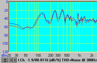

Exhaust builders and tuners claim that the exhaust sound has no influence on the gas velocity, but we know that any pipe can be tuned to match a sound wave, is it possible to tune an exhaust to match the engines exhaust ports sound wave?
What kind of calculations would one need to use?
If this is the sound waves from the engines headers.

Actually that does help, I 'm trying to make an exhaust pipe that has the same resonance as the headers, the idea being to get the lowest impedance in the exhaust, I do not know how Pipe Organ makers or tuners build pipes to vent certain frequencies like 80hz, I am looking to have an exhaust that will resonate at 120Hz 240Hz and 440Hz as these are the main sound waves from my engines headers, I know this sound crazy but I have time and I have never found an acoustically tuned exhaust on a car.

Thank you for all the responses, the engine in question is turbo charged so the scavenge effect is different from a naturally aspirated engine I think?
The strange thing is the engines main resonance in the headers does not change with an RPM speed increase, it gets louder and quicker for sure, but the 120Hz 240 and 440Hz are are still the main sounds regardless of engine speed, this is what confused me and lead me to ask the question, can I tuned a length of pipe to this wave lengths.
I drove the car with the turbo vented to the atmosphere in the engine bay, no turbo flange cover or down pipe of any sort, this made the turbo spool up very quickly but the actual power was down in the high rpm range, I then weld on a 3 inch down pipe and the longer I made the pipe the more power the engine developed until I connected up the rear back box, it sapped the life from turbo spool up time and dropped the power under boost, I know the silencer function is to reduce sound pressure but it removed so much power in the process, I though there must be a better way.

I understand this theory well and agree with it in theory, but in reality cold air in the engine bay slows the exhaust turbine, this is why I was losing power without any pipe.
Originally posted by martin clark I've had a succession of tuned turbo Saabs, amongts othe rtoys, and what seems to work well is a downpipe that expands smoothly from the turbo exhaust flange to a diameter appropriate to the target HP flow (eg 2.5- 3") - hint, smoothly.
The car is also a Saab using the B202 turbo engines, I fabricated a very smooth flowing stainless steel 3 inch turbo down pipe all the way to the back box, but as soon as I connected the box it reduces or delayed throttle response and power at the top end of the engine.
The whole point is to experiment with this theory, I just want to find out if I can match the resonance of the engine by tuning the exhaust, I sampled the sound from the engine exhaust ports, then the headers and then the down pipe, I'm not sure how I could make an exhaust that would have a resonance of 120Hz 240 and 440hz, these are the fundamental harmonics from the engine.
