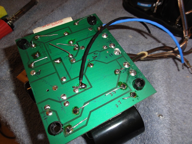

mundorf supreme resistors (20W)
I notice you have 10W resistors. Did you change them to 20 as well?
Did you find exact values for your coils? Is close enough, good enough?
From what I understand cross branches are not as important. In my lower and upper woofer thats where everything is with the exception of two coils. I understand the two 1200uf caps are not that imporatant to swap out.
Does anyone know if the other three cross branches are worth upgrading or are they not as important as the two 1200uf caps?
Any help would be great
the mundorf supremes are 20W, that is what I used
I have an inductance meter, you should match them as close as you can, or it will change the crossover points

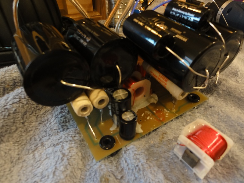

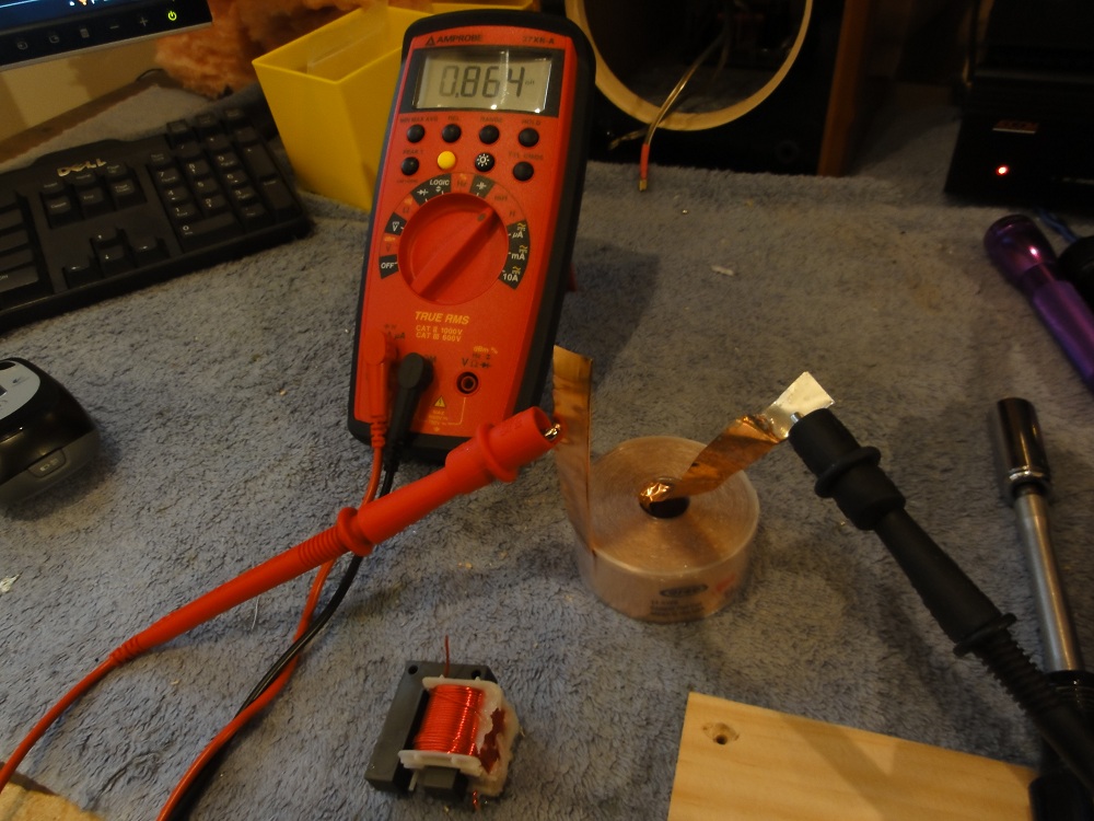

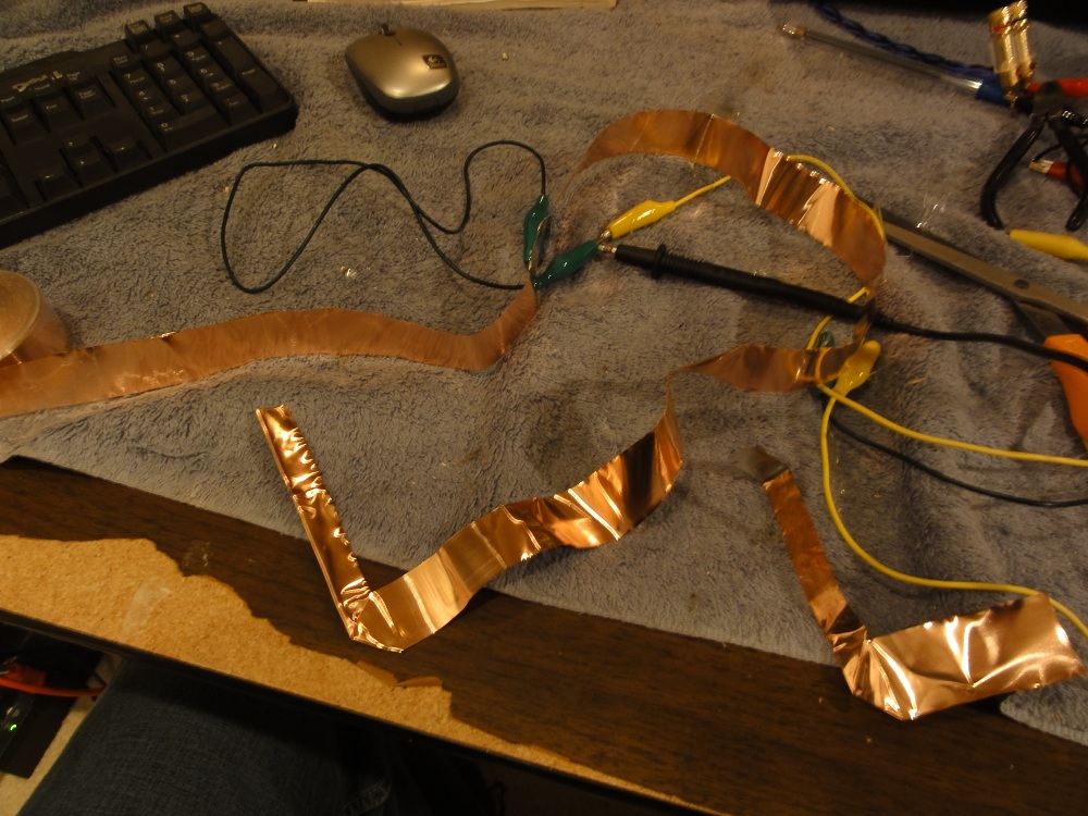

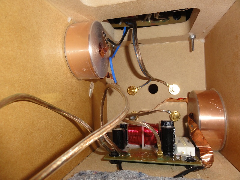

midrange inductor
finished the midrange inductor (.85mH), also the bass inductor is there (2.0mH)
also a pic of the original removed inductor
and, I had to unravel it to get to ~ .85 mH
