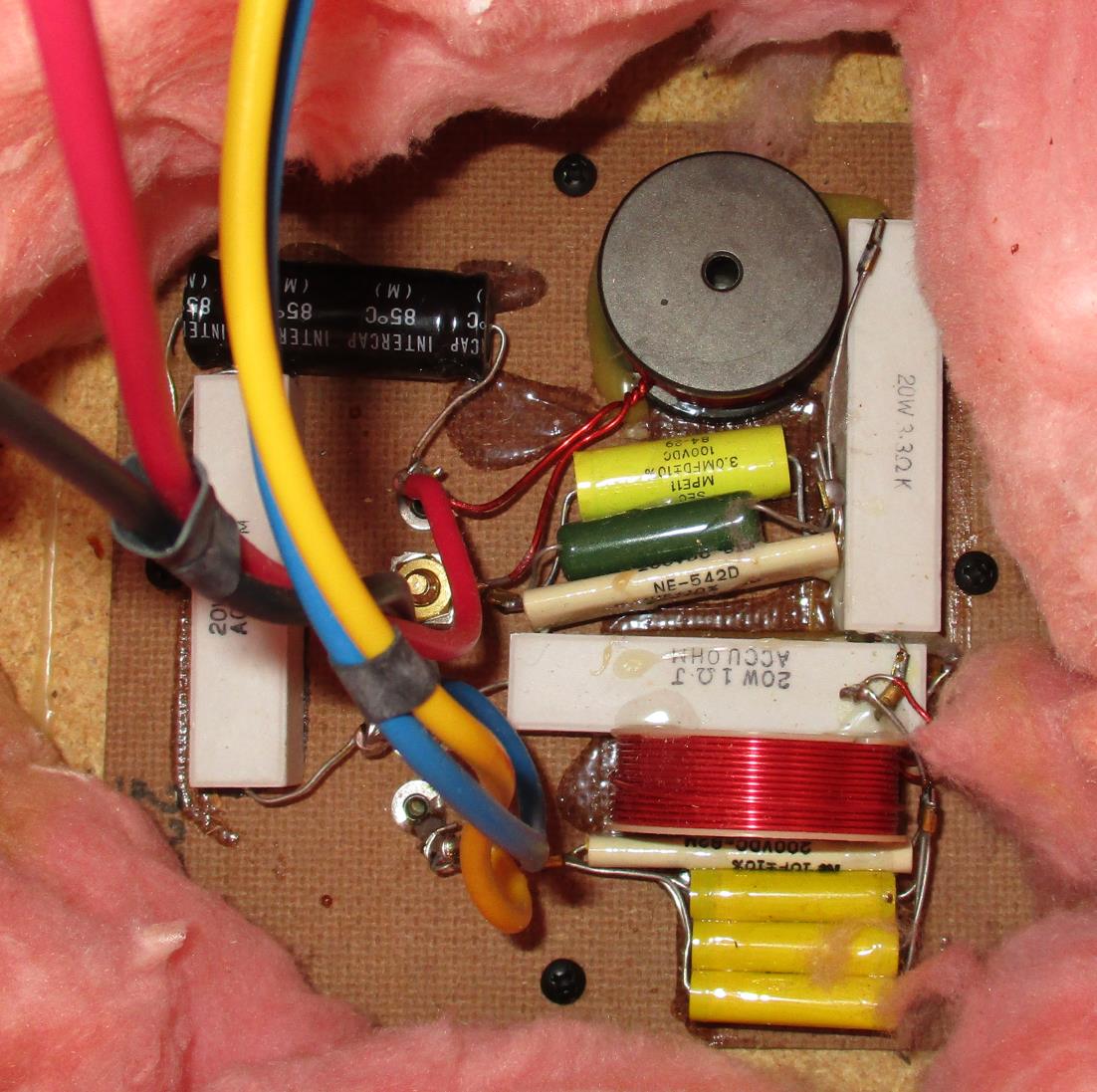

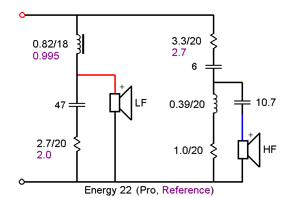

Late edit - 5-4-2020 - Crossover question.
I have found a crossover schematic which shows the changes between the Pro 22 and the Reference 22.
I will add the sales brochure and schematic in a new post as I can't add it in on this post.
The changes are oh so subtle.
Looks like the reference version;
Raises the tweeter level half a db.
Lowers the bass drivers crossover and increases the roll off by a
minuscule amount.
Is this possibly a tweak to account for the port being moved to the front on the Reference version or is there another reason ?
(port is on the rear of the Pro, and the front on the Reference)
And yes I know it'll be pure speculation without the driver parameters for proper simulation. 🙂

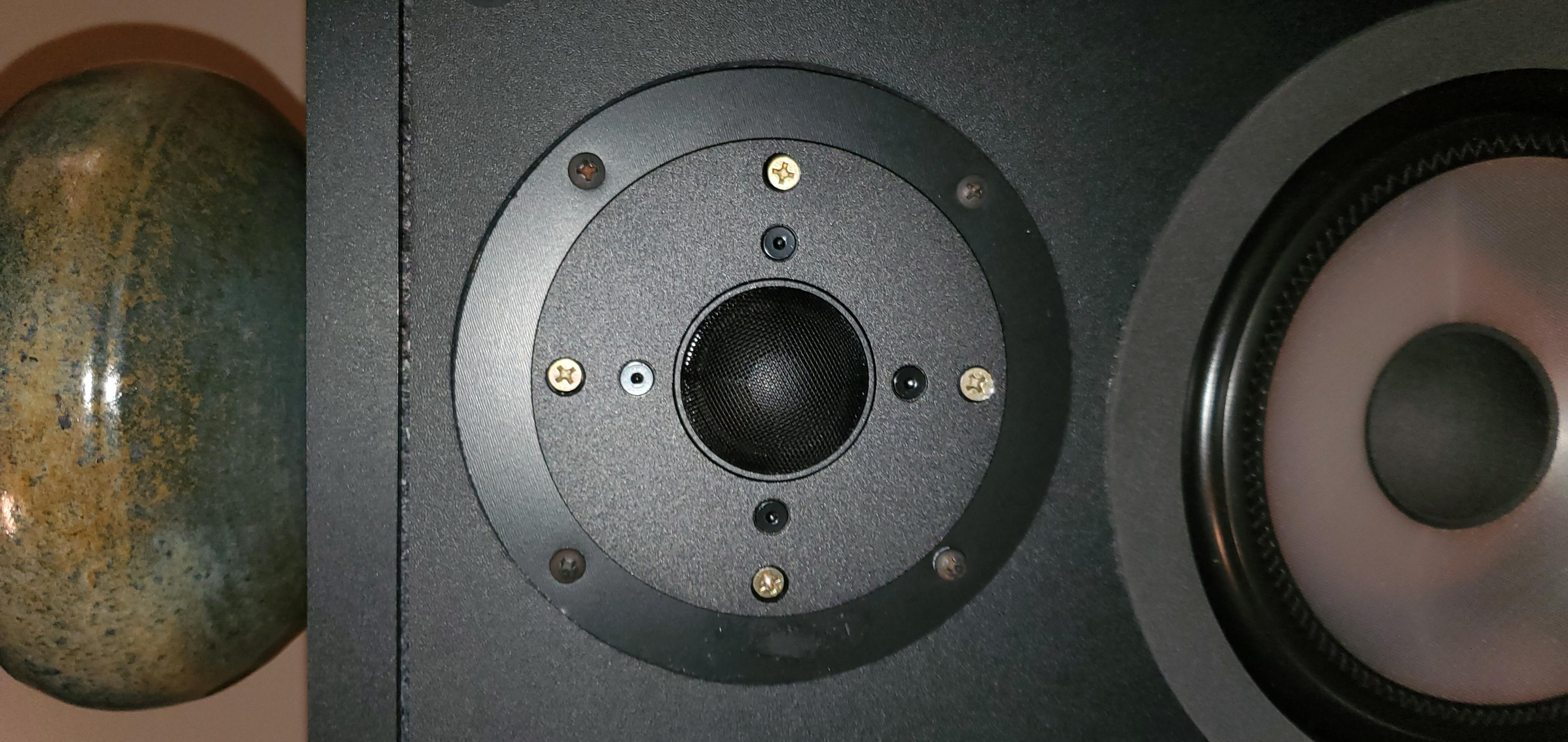

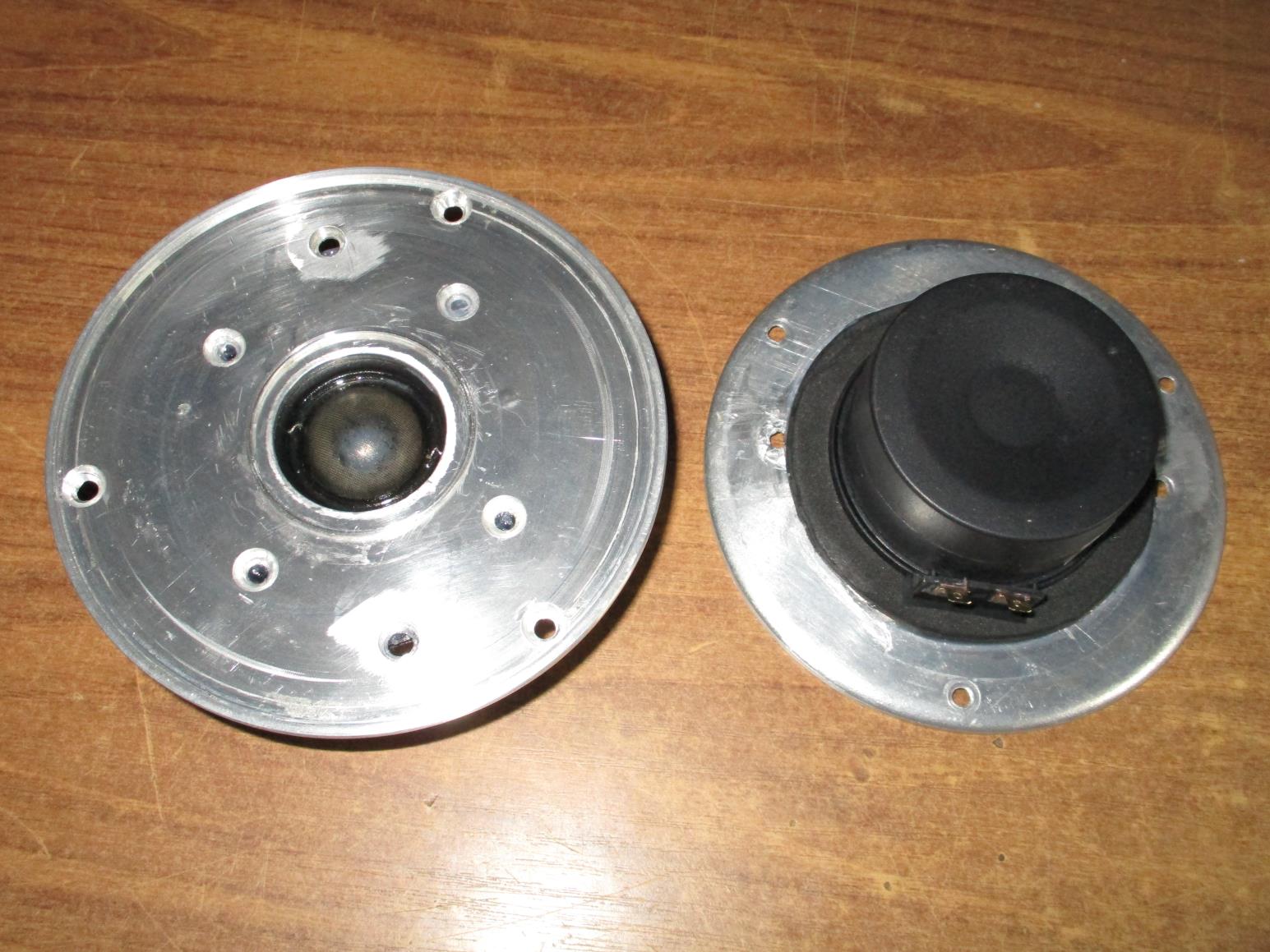

The owner of these found some info with possible options.
Audax TW034X0
Dayton RS28F (no longer available)
Dayton DC28F 8ohm (4ohm no longer available)
I ended up trying the DC28F 8ohm.
I used a dats v2 to measure the free air parameters of this against two of the working (sort off) original tweeters
Electrically it looks like a great match when compared to the better of the originals I have.
The dats sweep also sounds like perfect match.
I didn't bother with a proper mic'd test. Rather pointless when I'm not sure how good or bad the one possible original is.
I spent some time getting it to fit.
Ok some won't like how I've done this, but it works and sounds like a great replacement.

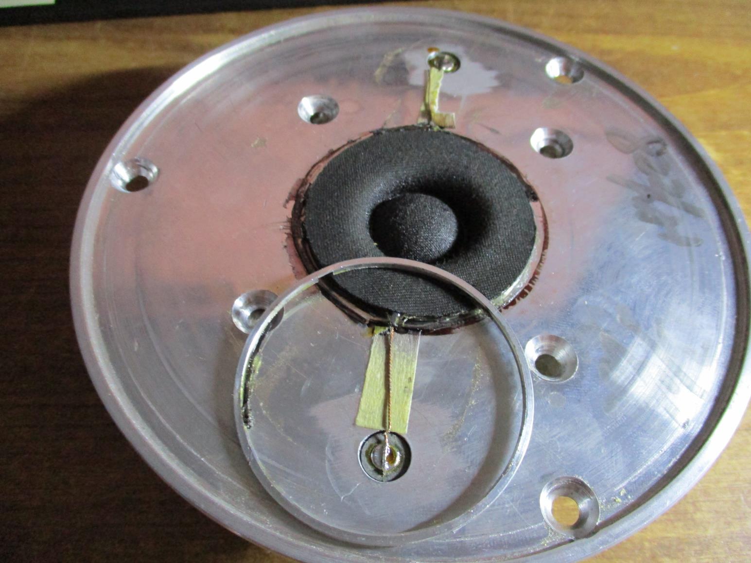

Strip the old tweeter.
All you need is the aluminium face, foam facing, small aluminium face ring.
Drill out the old terminal posts and notch out three spots on the back to allow for the face screws on the new tweeter.
Cut the face down on the new tweeter about 15mm to give extra clearance between it and the cabinet cutout.
Silicon new tweeter onto the old face plate.
Change the cabinet connectors to a pair of 5.2mm females. (Blue = Negative)
Put it all back together and done 🙂

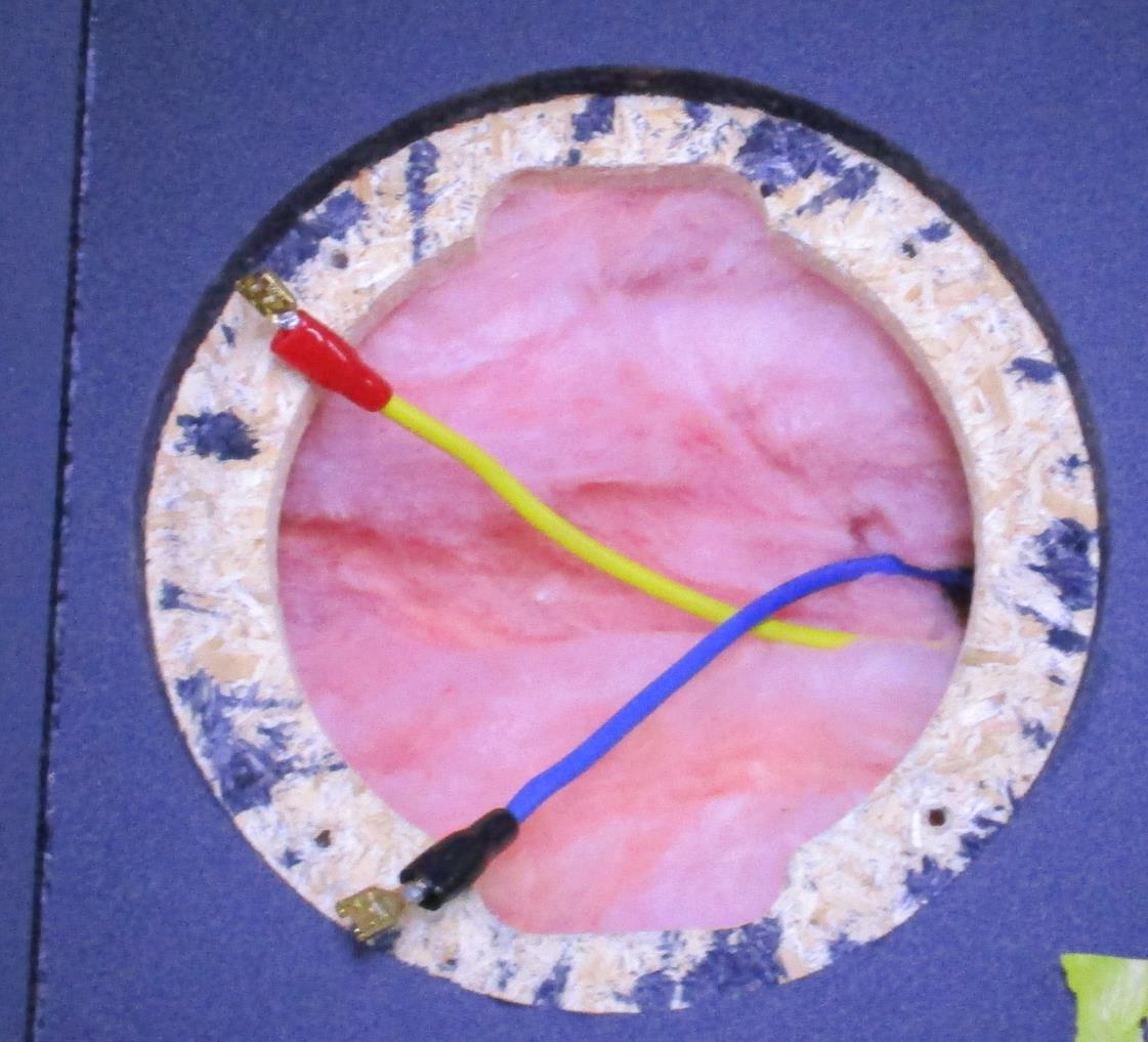

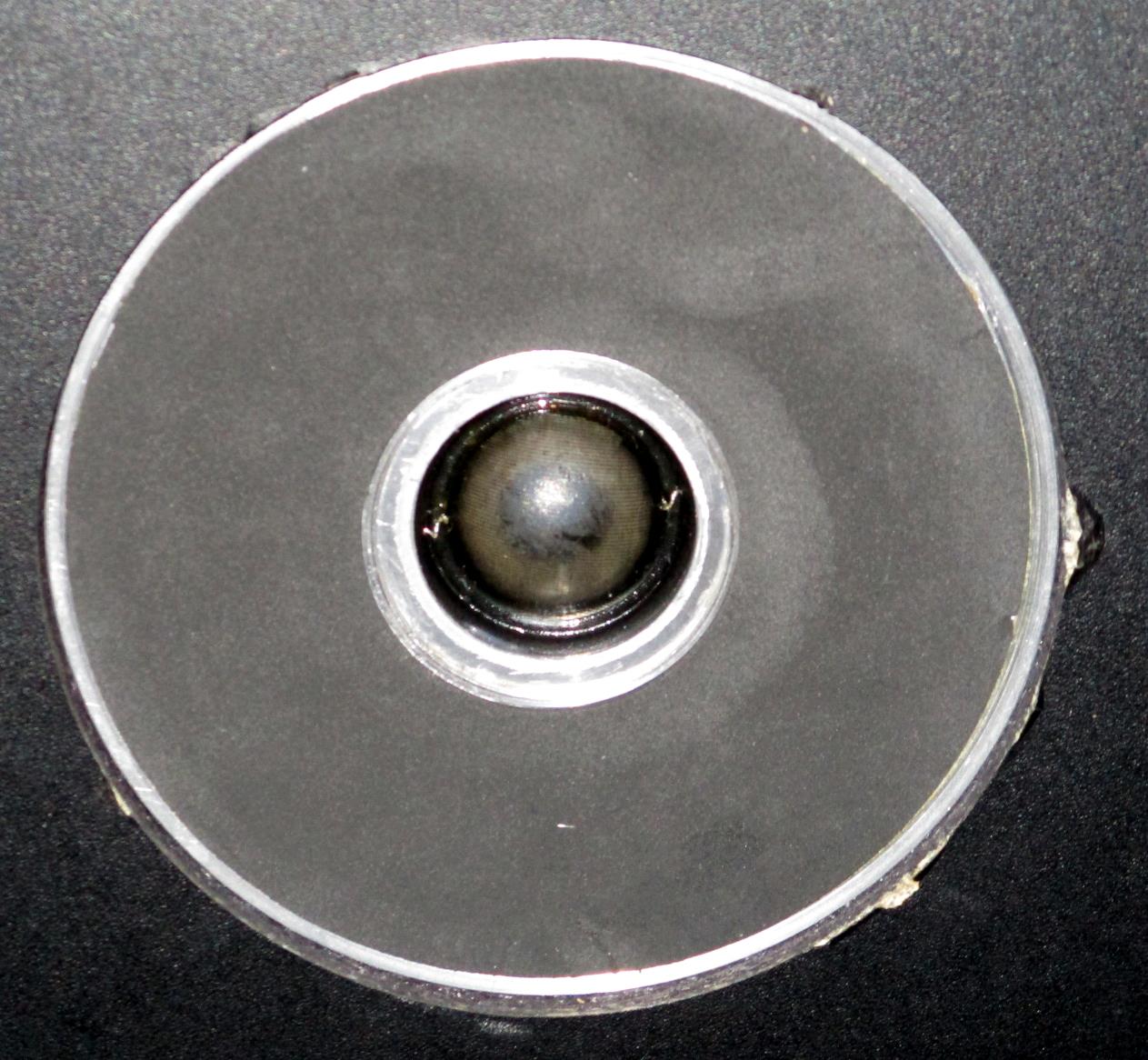

Of the two pairs I have here, there are minor differences.
One has three screws to mount the tweeter to the cabinet, and the cabinet is a pure straight hole.
The other has four mounting screws and has 'ears' cut in the cabinet for the terminals.
Let the pics be worth a few hundred words 😀
Please note.
I am not the one that dug the tweeter out by the rim with a screwdriver.
The damage was already there long before my friend bought them.

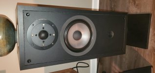

Energy 22 replacement

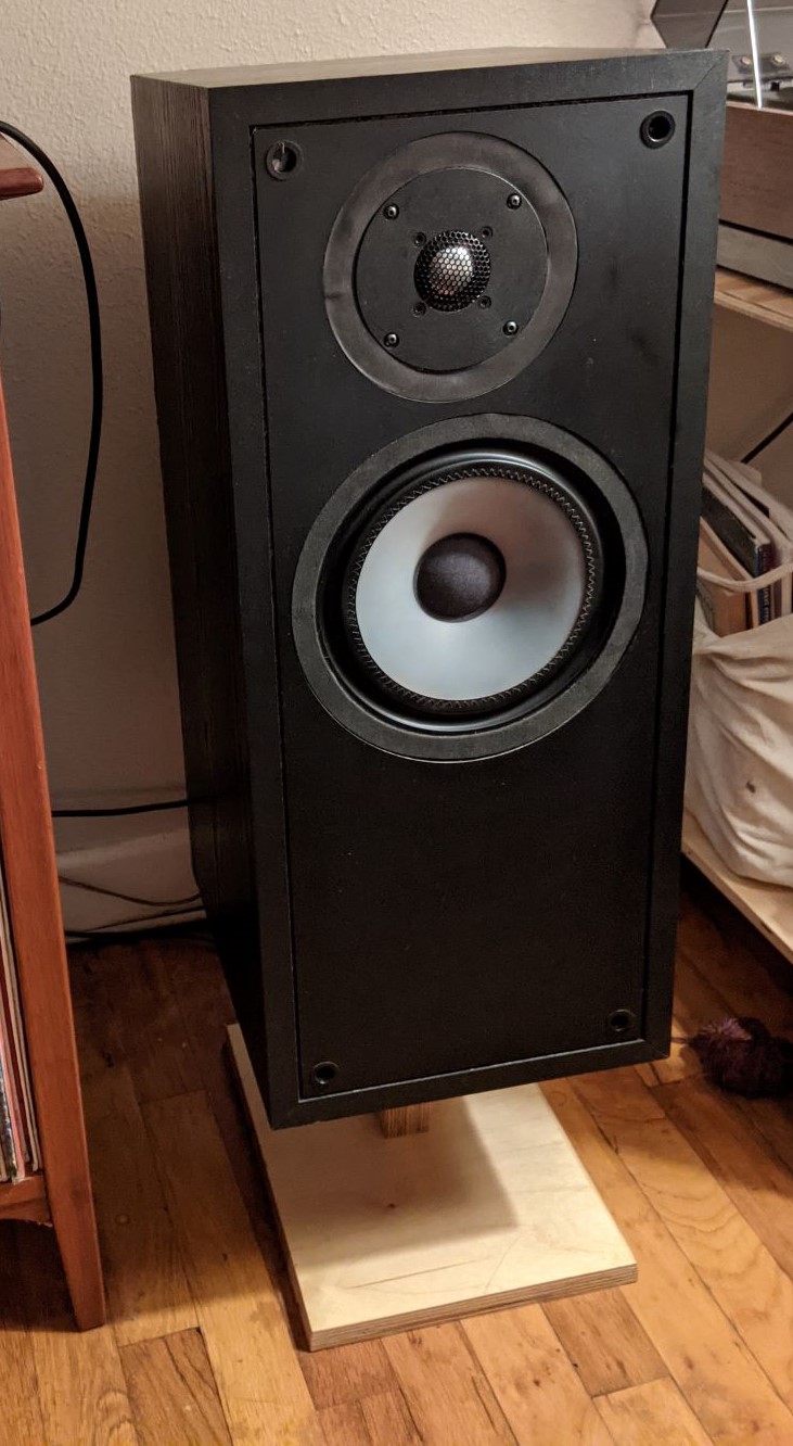

To put another option out there.
I recently acquired some pro 22s, with one dead tweeter, and one that hardly worked. I tried the Seas 27tbfc in them, with pretty good success so far! They sound great, and I think they look really cool.
To make them fit, I made some adapter plates from some fairly thin aluminum I had around. I imagine a baking sheet or something similar would work well. Cut it to the size of the original tweeter (a little smaller), and make a hole that fits the new one in the center. I used an aircraft snips for this- not ideal, but it gets hidden! Drill holes to correspond to the three mounting holes in the original, and the four mounting holes in the new tweeter. Use machine screws/nuts to attach new tweeter to adapter. I used a layer of black foam craft sheet as a gasket here, cut to the size of the original tweeter (with an xacto knife).
Then I attached the wires (I soldered them, but would recommend purchasing the correctly sized plugs), and screwed the whole assembly down using new pan head wood screws in the original mounting holes. I left the original gaskets in place for this.
I then made and fitted a trim ring using the same craft foam. In the layer of foam underneath, I used a hole punch to remove material where the pan head screws would otherwise raise the foam.
Unfortunately I didn't take pictures of the process, but here's the finished product:
