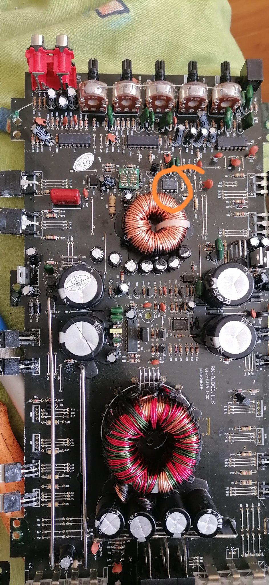

Energy audio I need help identifying part number please
I need help identifying missing part number please.
You didn't provide the model, but assuming that it's a class D amplifier, the missing IC could be something like an IR2184. If the diode next to the IC is a high-speed rectifier, find which terminals of the IC the diode connects to and see if that corresponds to the correct terminals of a 2184.
