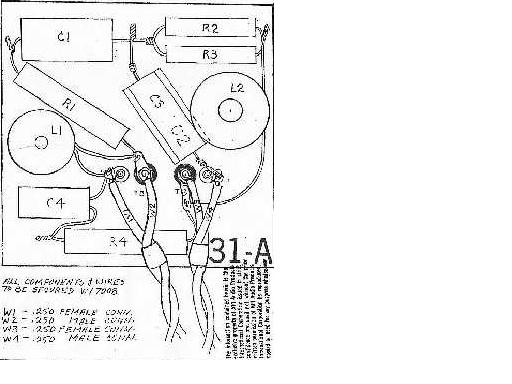

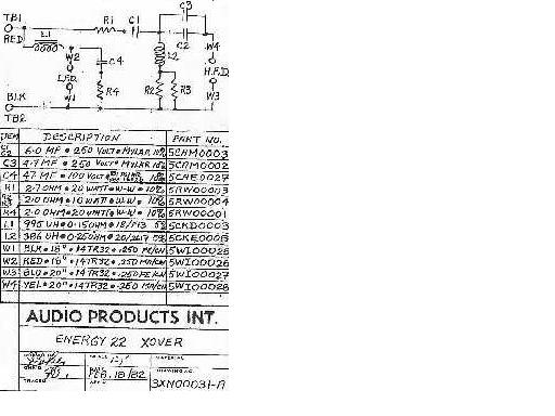

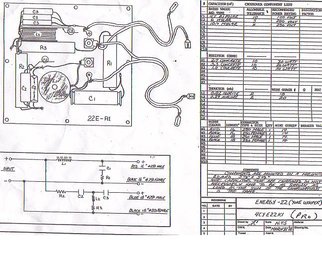

The drawing you've posted is for the 22 Pro. I have a schematic for the 22 Reference and 22 Reference Connoisseur, which I'll post tomorrow. The choke values seem to be different (.995 and .386 mH in my circuit).rtenyes said:hopefully this works... xover schematic..?..?

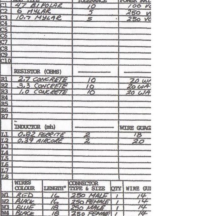

Thanks for posting the pro22 crossover values. The pro22 and reference 22 should be very similar (?) as the main difference in these two speakers was the location of the port (back vs front). Someone please correct me if I am wrong.
The pro22 crossover is also very similar to what I found in my reference connoisseurs. There is a difference in R1 (2.7 vs 2 ohms---if I read the value on your sheet correctly).
I have inductor and capacitor capabilities on my voltmeter and I get .71 and .66 mH for my two ferrite inductors and .34 and .36 mH for my air core inductors. Does your schematic show .82 and .39 mH? (it's a bit hard to see). Interestingly, I read 56-57 uF for both of my bi-polar capacitors, which is probably within their normal range, but I also read over 50 uF for one of my 6 uF mylar caps (????---but one of my tweeters has some problems, perhaps this is why??--either that or a measurement error). Everything else was close to spec---my 10.7 uF pairs read 10.96 and 10.93.

Received a further reply from Energy that the inductors in the ref. conns. were .77 mH and .386 mH, so a bit different from the values that were posted above for the pro22's.

Thanks for putting this drawing up Ross.
I also found a 2-ohm resistor, at position R1, in both my Ref Cons and the two pairs of 22 Reference speakers I've dissassembled. Not sure which schematic shows the correct woofer inductor spec because I didn't measure.
I can post the values, or PM me and I can email you a copy of the schematic.
rtenyes said:if i'm not mistaken, the ref / ref conn xover is a series xover, the pro is a parallel xover.?.
No, they're both parallel. I biwired my Ref Cons just by separating the tweeter and woofer circuits (biwiring made no difference BTW).
Thanks for the uploads Ross and audiobomber. The crossovers all look parallel to me, they are just drawn a bit differently. Interesting that the parts lists shows R1 as 2.7 ohms, but it has been found as 2 ohms in several pairs now. There is still some discrepancy in the value of R1. We've seen .82 mH on the pro22 schematic, .995 on the last schematic, and I was told .77 for the ref conns by a tech at Energy.
