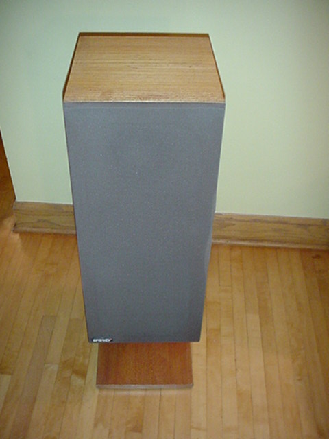

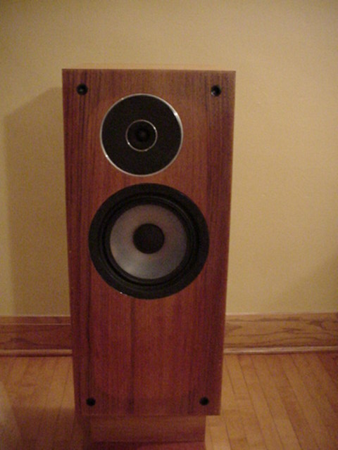

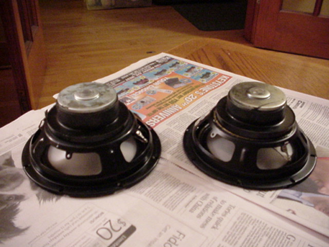

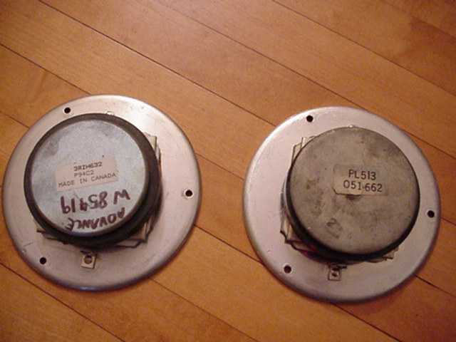

Hi Everyone
I have had these speakers (Energy 22 Reference Connoseur) for a little while now, and with every upgrade of my equipment ahead of them, they keep sounding better. Of course, they sound bloody horrible being driven by crap electronics.
Anyhow, I am so happy with them, that I feel they are deserving of a complete restoration. They were the 2nd last set off 22's out of the factory, but they are still more than 15 years old. The cabinets (rosewood) are going to get a complete going over. More importantly, I want to rebuild and upgrade the crossover. Am not looking at making huge changes to it, but rather just rebuild it with modern, higher quality pieces.
Has anyone undertaken a project like this on the 22's? Any recommendations?

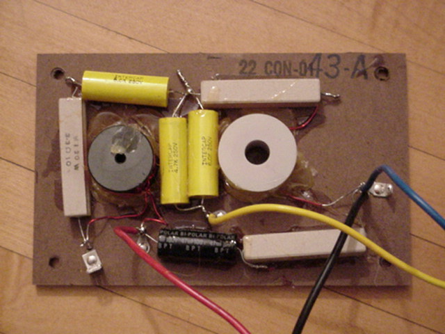

I can only make some general recommendations:
Some photos would be nice, especially of the crossover.
A schematic of the crossover would be very helpful - all the components and their values, etc. - this will help others here to offer advice on what, or what not, to do with the x-over.

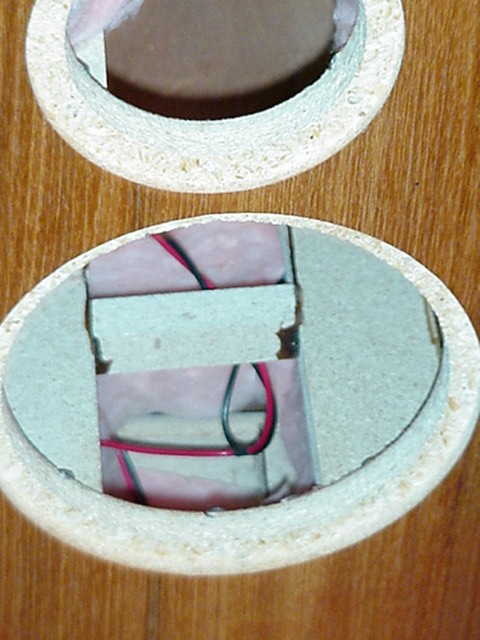

Check the inside of the cabs for bracing - they may be able to benefit from some additional if the factory went a little light on that.
What kind of condition are the drivers in? If you are planning to replace them, they would have to be the original types, or else you won't have the original speakers anymore; you might want to check with Energy to see if they carry replacements.
That's all I can offer - you'll find most people here build their own from scratch, or from kits or others' designs, so restoration of an older commercial model isn't as common a topic. But if you love your speakers then go forth and enjoy your project! Restoration is a commendable undertaking.
I still listen to my 30-year-old Yamaha NS-670s - I can't bear to part whith them, so I know where you're coming from!

Hi Erik,
Having worked for the company when they were still being produced I think I can jogg the memory enough...
The xover used a combination of poyester and electrolytic caps - 18db for the tweeter and 12db for the woofer. Replacing these would make sense if you plan to upgrade. The coil on the woofer was ferrite core so don't bother with that. The tweeter coil was air core and wound with 20AWG wire.
The xover was point to point wiring and all components were glued to a piece of masonite. I don't believe they went PCB until the new line came out.
The 22's had more than sufficient bracing in them. You could however replace the fibreglass as it may have shrunk over the years. It was an overdamped design so make sure you replace what you take out.
Really, not much else you could do for "upgrading". I recall coming across a few tweeters that leaked causing some problems, but unless you can get ahold of new units, there's not much you can do.
Hope this helps you.

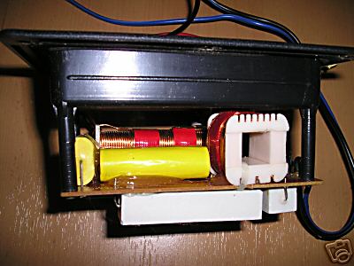

and the crossover:
-on the lower left a red wire comes in from the speaker post (not shown): it goes through the iron core inductor and then to the red woofer wire; in parallel to the red wire branch branch point is a 47 uF bi-polar electrolytic in series with a 2 ohm 20 w resistor, which is connected to the black wire to the woofer and the black speaker post.
-for the tweeter, the positive goes through a 3.3 ohm 10 W resistor and then a 6 uF capacitor (top left); there is then a branch point with a 4.7 uF and a 6 uF capacitor in parallel (total 10.7 uF) which leads to the tweeter yellow (+) wire; from the branch point a 1 ohm 20 W resistor is in series with an air core inductor and then the black speaker terminal (blue wire goes to tweeter)

steve:
my xover looks exactly the same as the first pic (as apposed to the one you just posted) except the mine has (2) 25uf caps in parallel in the woofer section as apposed to the "47"uf that's supposed to be there. it too is mounted on the 1/4 hardboard and then has epoxy on the components. as far as the schematic goes, i'll have to scan it in and figure how to upload! (is there a fac on uploading?)
ross
