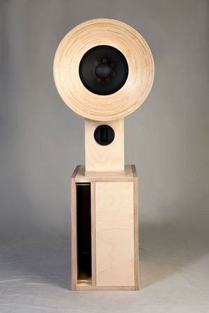

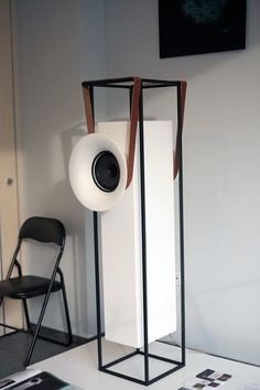

I had something like above in my mind
And specially this one
