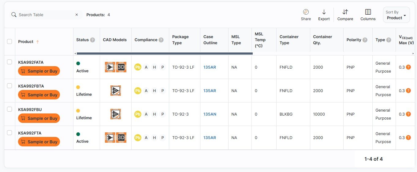

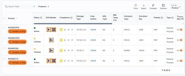

Hi Mark and all,
As of today, this is what onsemi shows for ksa992 availability, they're thinning the herd so to speak. Basically like fjv992, it's not offered in grades. but the processes are so good these days, I think device to device, lot to lot variation are so tight. I did stock up on ksa992FB on tape however.
FJV992FMTF also show active production
