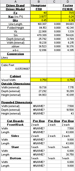

Unfortunately, yours appears defective like mine [#NAME?]:
GM
GM
Checked all 4 copies they all do the same. Attached are 2 pre-formula calculators. 1 that is zilla's i think which has a static diagram and a height adjustment that compensates for the bend, and one i started but didn't finished -- it generates an actual diagram
Both are unlocked, maybe someone can add the formula to generate inputs and make a new, working BIB calc.

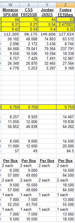

I tried the xls file - column z accepts data. I am running my desktop at 1920 x 1200 - if you are running at lower resolution then you will have to pan towards right.
I filled up all the rows, including driver make and model.
-Zia

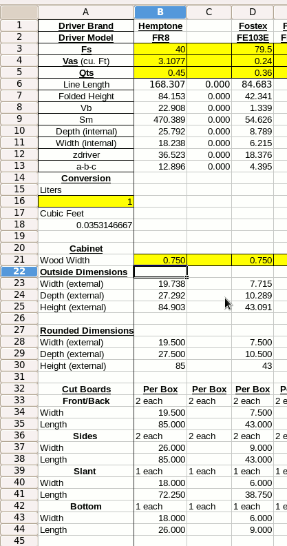

Hi GM, attached is what I get, using Gnumeric on Linux.
Here is the same version, ported to Windows: http://people.gnome.org/~mortenw/gnumeric/gnumeric-1.10.14-20110324.exe
May I ask which spreadsheet(s) and version(s) you've tried?
P.S. In Gnumeric, to unlock something, click Edit > Sheet > Manage Sheets, and click on the padlock icon. (I hardly think this is an ethical problem considering that it's GM's own math.)
