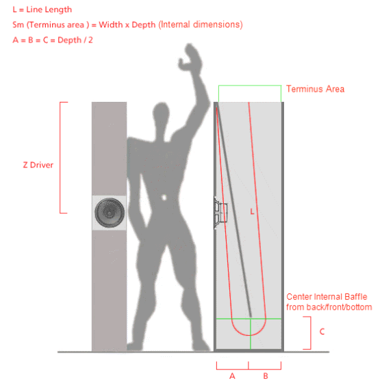

On my original request, I've found that Terry Cain's tall transmission line TQWT with it's top discharge terminus is the enclosure I lust for my Hemptone FR8 speakers.
My (used) FR8 speakers appear to have the modification advised by Planet10. The dustcaps have been removed & plugs have been added. I'll be using Fostex FT17H tweeters with them.
Please direct me to any information that will permit me to build larger versions of Terry Cain's enclosures.
I was confused by the apparently conflicting descriptions connected to acronyms until I read the discussion between Scottmoose & Planet10. Now I don't feel so bad.

Well, it doesn't look like the BIB calculator is going to be back on-line for awhile yet, so without further ado........
Assuming a very low output impedance [SS amp, sufficiently large speaker wiring] and 3/4" [19 mm] thick material:
L = 168.31"
H = 84.155"
D = 25.8"
W = 18.24"
A-B-C = 12.9"
zdriver = 36.523"
Sm = 470.39"^2
net Vb = 22.91 ft^3 [man sized!]
All dims inside [i.d.] and approximate.
