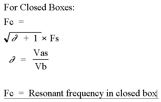

For closed boxes, the resonance frequency, (Fc) is definitely affected by, but not identical to, the Free Air Resonance Frequency, (Fs).
The box below gives the formula to find the Closed Box Resonance Frequency, (Fc). This website does not allow Microsoft Equation Editor in the text portion.
Again, remember that in the Closed Box as well as the Bass Reflex, the response will NOT necessarily be 3 dB down at the Resonance Frequency. In fact, in the Closed Box, the response will only be 3 dB down if Fc equals .7. If Fc is below .7, the response will be more than 3 dB down. If Fc is above .7, the response will be higher than -3 dB.

Thanks for your remarks. I have actually completed TS tests on my woofers and midranges and shall put the results on this string to ask you whether the figures look acceptable. In the Meanwhile I have problems with the formula to arrive at Vb. Actually there are two different formulae and they give me results varying the volume by almost 1 cubic feet. The first formula is:
Vas = Vb((Fb/Fs)2-1)
found in http://sound.westhost.com/tsp.htm
The second one is:
Fc*Qec
Vas = Vb [ -------- - 1 ]
Fs*Qes
found in http://www.crackinguniversity2000.it/Panorama/documents/audio/speaker_parameters.html.

The first equation is for designing boxes, the second is for measuring parameters.
