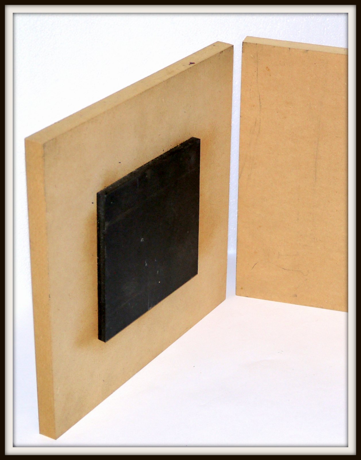

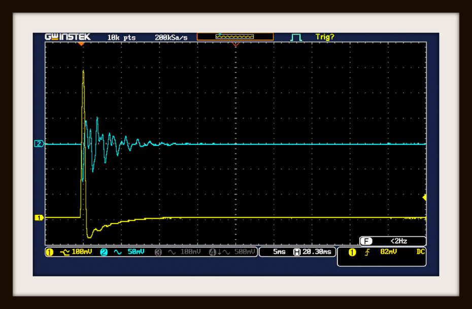

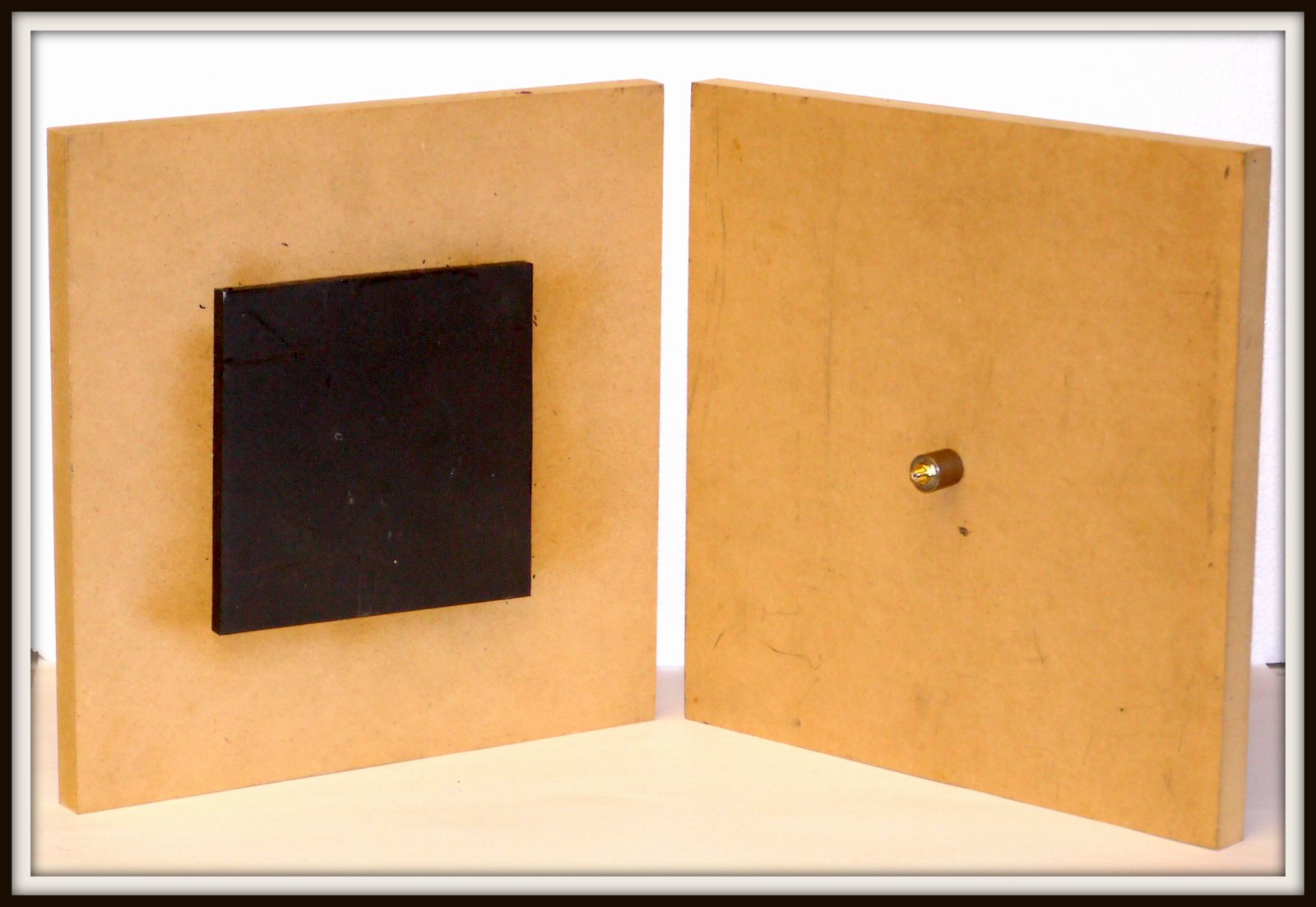

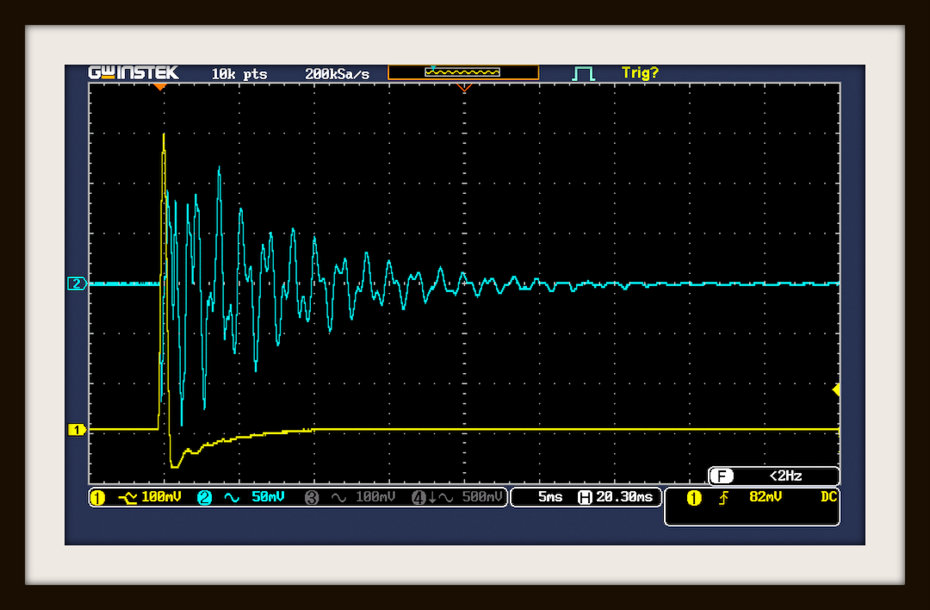

Here are some simple tests done with the hammer/accelerometer pair. I used a piece of 3/4" MDF that was available for cutting into 2 - 1ft square panels. The accelerometer was attached with a dab of bee's wax to center of each panel during the test. The wax makes a good attachment method for this type of testing and it's easy to remove after testing. Low temp hot melt glue works well, also. The base of the accelerometer is magnetic for easy attachment to magnetic surfaces. The accelerometer design incorporates a magnet circuit to magnify the holding force. This design leaves virtually no field leakage to surrounding surfaces.
The DSO images were acquired with no charge amplifiers in the circuits. The signals are straight into the scope's channels. The top image shows an average of 4 taps with the hammer about 1" from the accelerometer. This activates a some modes of panel vibration that are easy to see with the accelerometer's signal which is also averaged 4 times. The averaging just levels the playing field for the stimulus/response evaluation. Both panel were placed on the same piece of very soft 2" thick foam for testing.
The second DSO image is with the accelerometer moved over to the center of the other panel. This panel has had a 6"x 6" piece of 3/8" thick damping material applied. It was just glued on with some 3M spray adhesive. The hammer was tapped approximately the same distance away from the accelerometer as in first panel test. The damping material was glued onto the opposite side from the accelerometer and tapping.
The amplitude of the averaged hammer taps indicates the force that the panel was tapped with. The averaged accelerometer output amplitude is the response to those taps. The difference between the 2 panel tests should be striking (pun). I know that I'm probably preaching to the choir, but this is stuff that's very hard to do with a driver, microphone, and a single panel in a test set up. Nuff said.
Hopefully, this post demonstrates that useful numbers can be generated from very simple tests that are relevant to speaker building. I'll continue posting these experiments if anyone is interested in a higher level of involvement in these simple modal testing methods.

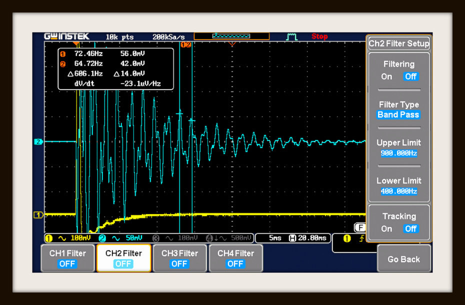

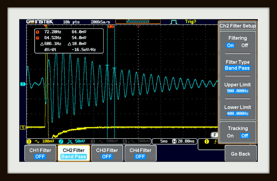

I thought that it might be interesting to see what applying a simple bandpass filter would look like on a hammer tap using the same set up as described in post #28. These taps were done on the undamped panel. There was no averaging nor any attempt to reproduce the previous tests.
These 2 DSO images only show different taps with and w/o the filter. Channel 1 is unfiltered so that the force of the taps can be judged to be ~ equal. There was no attempt to be quantitative here, just a filter demo to show how a DSO measuring in the time domain can be used in these tests.

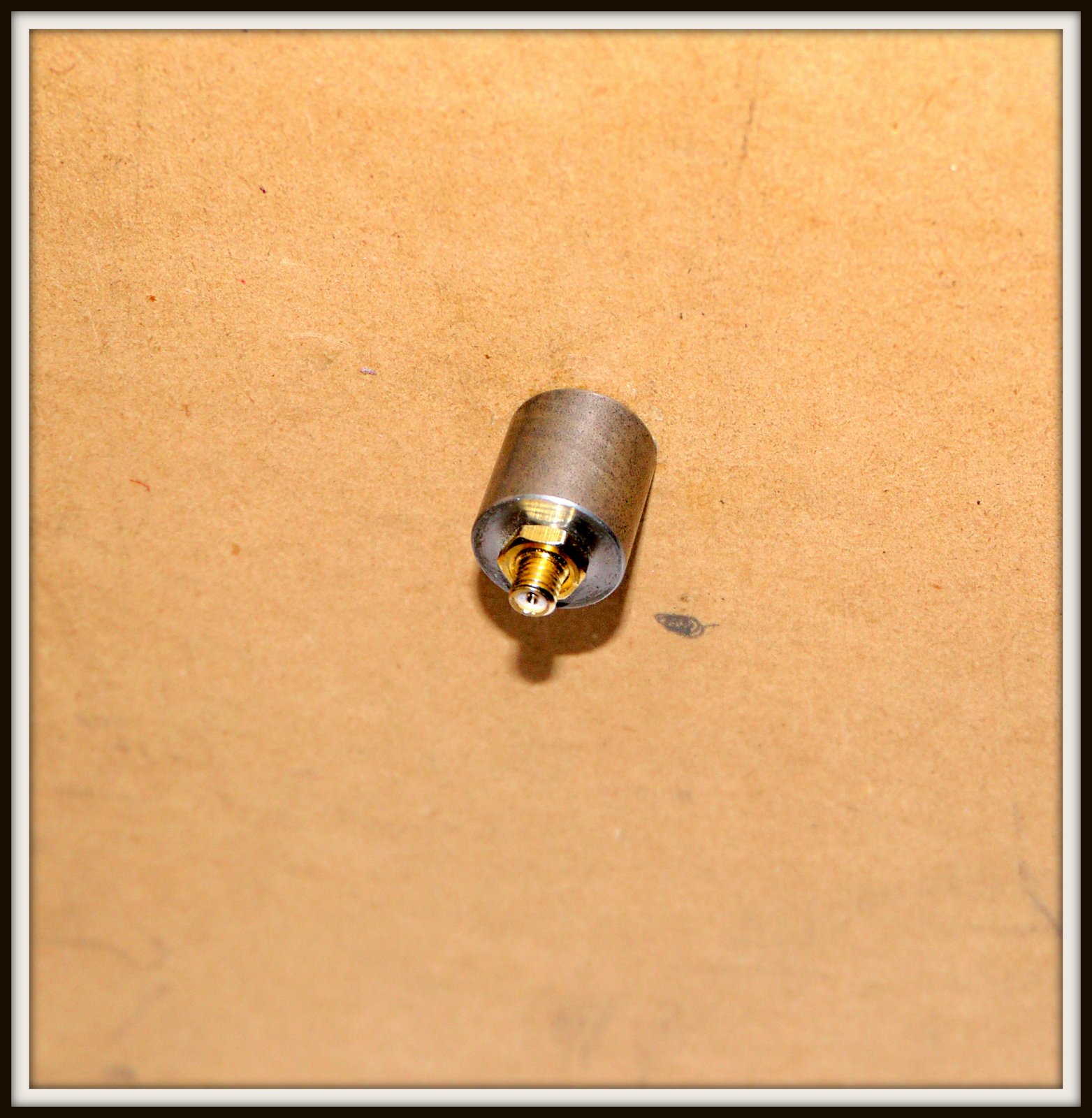

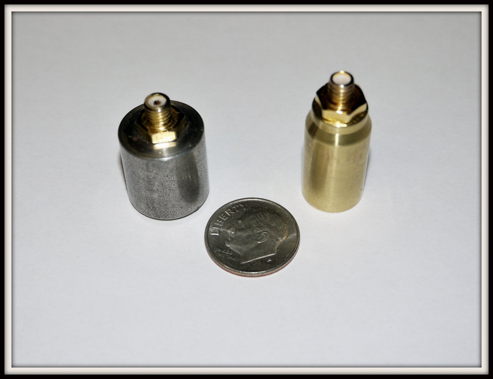

This is a comparison of the 5th generation brass housing accelerometer along side of the previous 12L14 steel housing unit. The mass has dropped from 23 grams to 11 grams. The output signal levels are about the same, but the bandwidth on the new one is better.
The modal hammer is still being refined and everything still needs to be calibrated. When the designs have all pretty much stabilized I'll be able to offer up some real numbers about the capabilities and limitations of these 2 instruments.

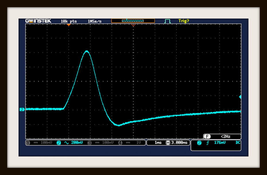

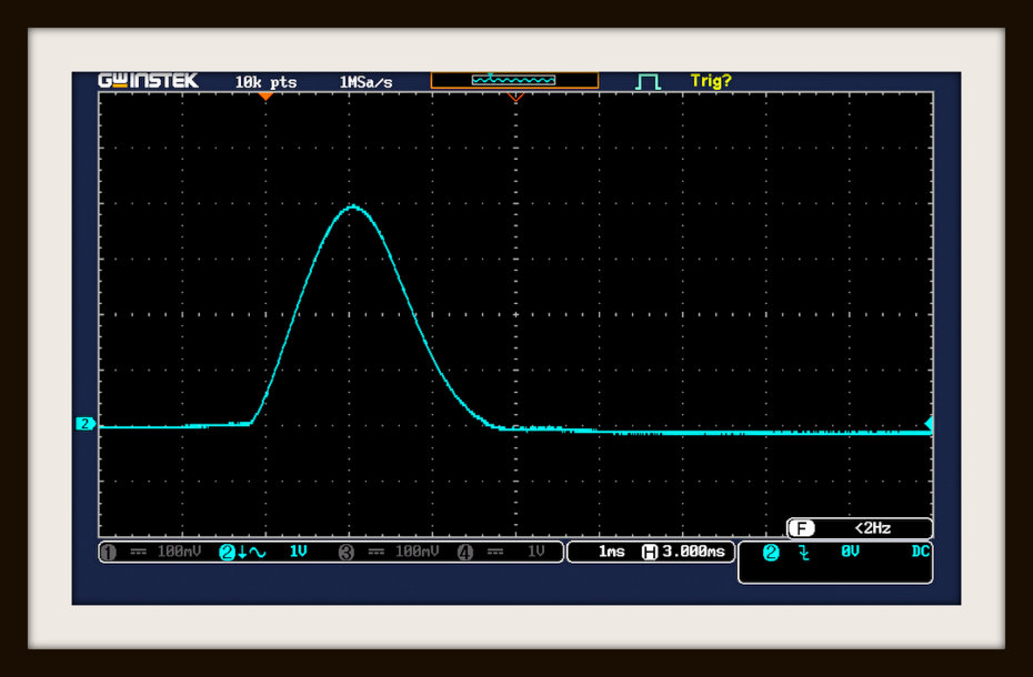

Now that I'm beginning to look at the modal hammer and accelerometer transducers more seriously it's time to start doing some measurements using charge amplifiers. These 2 DSO images are of the hammer tapping the same MDF panels as before.
The first image is of the hammer's signal going straight into the DSO's channel 2 input. As can be seen (and demonstrated in an earlier post) the half sine wave has been corrupted by the 1 megohm input resistance. The signal's amplitude is also attenuated. The signal has been averaged 4 times.
The second image is of the hammer having been passed through a very high impedance charge amplifier which allows the full signal from the hammer's force transducer to be collected and displayed undistorted by charge leakage. The charge amplifier has a low output impedance and can be adjusted to produce a calibrated force output signal to the DSO. This signal has also been averaged 4 times.

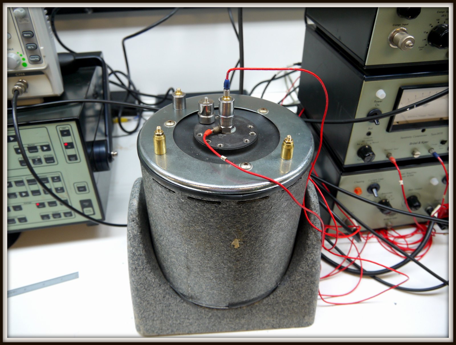

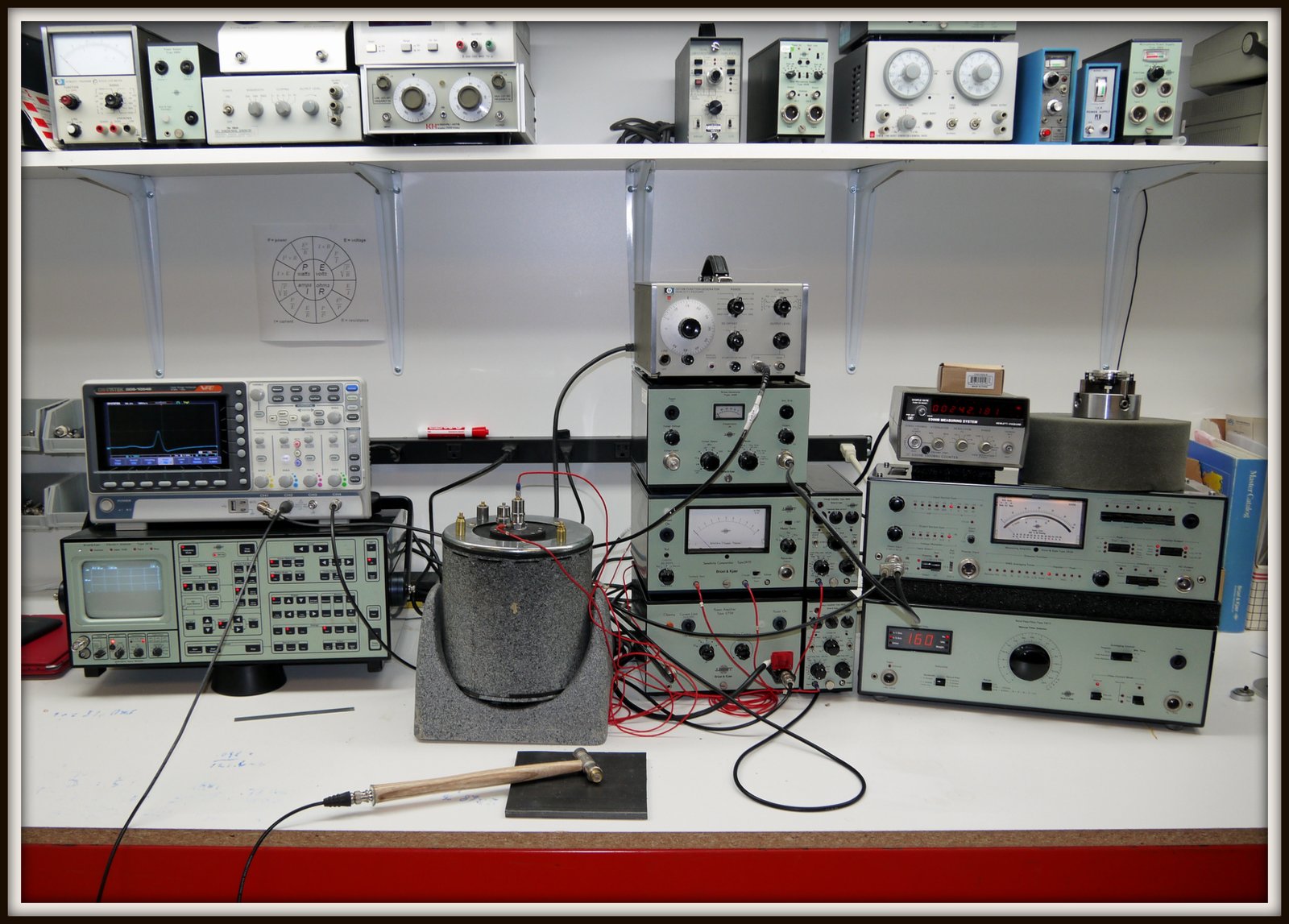

The modal hammer and accelerometer project has been moving forward slowly as I gather more instruments that apply directly to vibration measurements and calibration. The vintage Bruel and Kjaer stuff is really nice to work with and very well thought out for the application. My instrument bench for this project has been slowly growing over the years by patient collecting of B&K sleepers on eBay.
The present calibrating accelerometer is a modified general purpose Endevco device that I've attached a 12L14 steel cap onto with epoxy. This allows my magnetic base accelerometers to piggyback the bottom unit for simultaneous signal comparison.
The mini calibration shaker project is still in the works. It's prototype is designed to produce a 1g acceleration at 120Hz.
