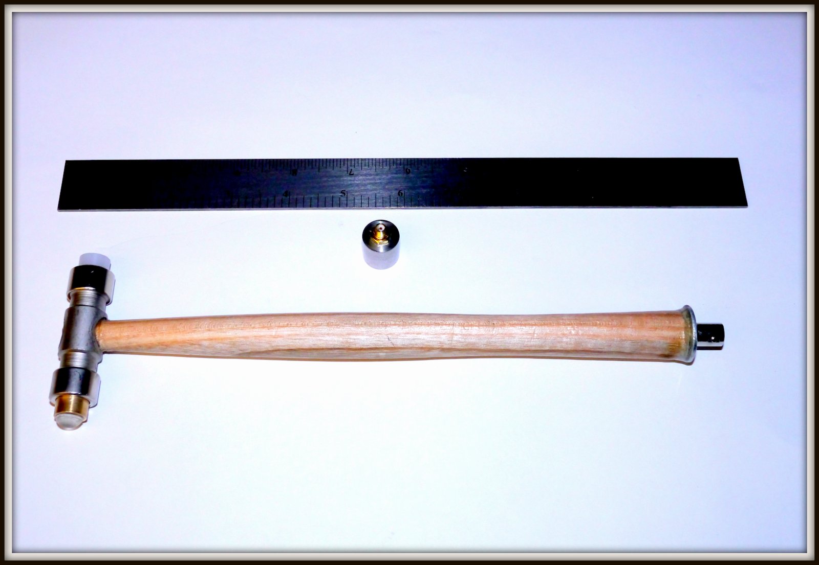

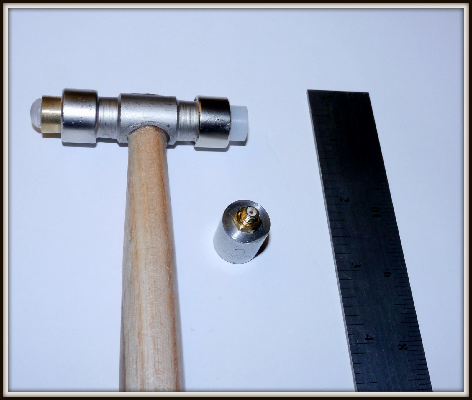

T - Thank you for your continued interest in the project. I've included a couple of photos so that you can see where I am with things, build wise, concerning the transducers. I'll get some DSO screen shots of the signals and post them.
The hammer at this point is a modified jeweler's hammer. They are inexpensive and can be easily machined to do my bidding. The DIY force transducer is installed into one end of the drilled out hammer's head and a shielded cable is routed down the drilled out handle. A BNC connector is then soldered to the cable and epoxied into the base of the handle.
The BNC connector is then tested with a General Radio Megohmmeter for a resistance of > 2G ohms @ 100V. This assures me that there is no meaningful burden on the transducer before it goes to the DSO input or a preamp if one is used.
The DIY accelerometer is built into a piece drilled out 12L14 steel. The electrical feed thru is a Microdot L5 connector. This transducer gets the same resistance test as the hammer.

Right now I'm experimenting with attaching assorted durometer tips on the brass head. These sticky tips come from the hardware store and are meant for attaching to cabinet doors and such to quiet their closing. There are many to choose from and they each have a different, very repeatable, effect on the impulse spectrum and amplitude generated by the hammer.
This all means that the hammer will act as a proxy driver to excite the panel without having to build the actual box. The panel then responds to the impulse energy spectrum and generates it's own resonance response, transduced by the accelerometer, that can then be displayed in the waterfall.

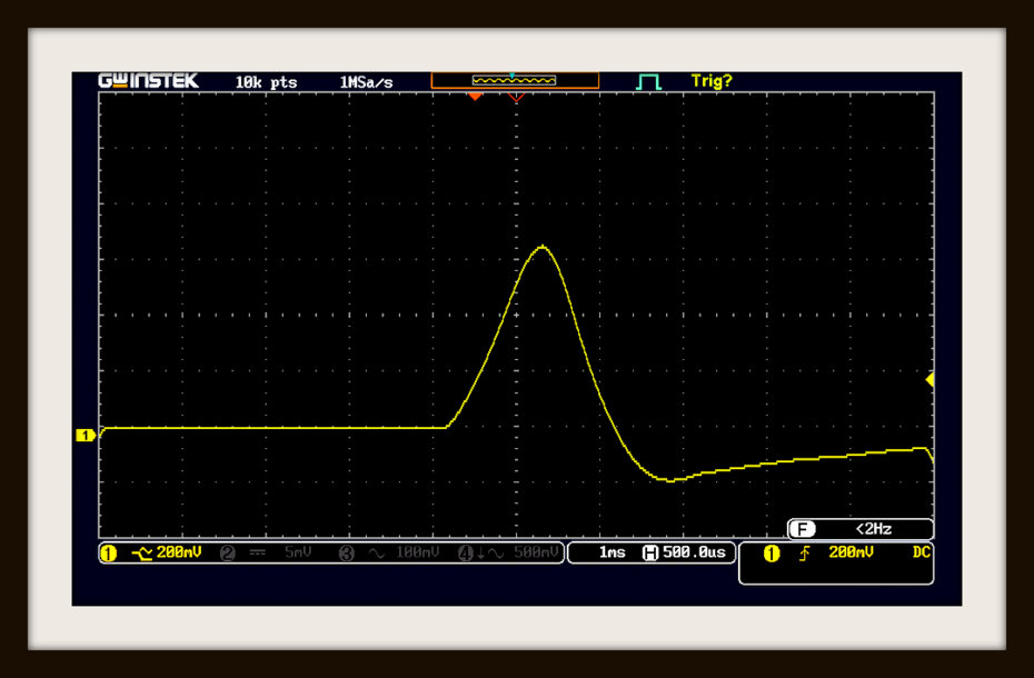

The hammer that I've designed is intended to generate a half sine impulse. The frequency content and amplitude of the impulse can be adjusted to fit the test requirements. The explanation of it's design and applications can found with a Google search for "modal hammer". If you click on "images" there will be lots of information that should answer most of your questions. Designing and building an accelerometer follows along the same path.

To expand on the hammer/accelerometer project I thought it might be useful to show what the sensitivity of the hammer's force transducer is when used in a typical impact test. I'm still in the calibration phase of these instruments so I'll just post a DSO screen shot of an average of 4 taps. The test specimen is a 1 sq-ft piece of 3/4" thick MDF sitting on some soft foam in my lap as I sipped some bourbon to see me through the task. I'll have the actual force measurement numbers soon.
As can be seen the impact produces a half sine wave with an amplitude of ~ 600 mV into the scope's 1 Megaohm input resistance. The sag on the right side of the waveform is leakage as can be expected from such a low resistance load. One of the interesting things about this type of testing is that the half sine signal contains infinitesimally small separations between the frequencies it's composed of.
