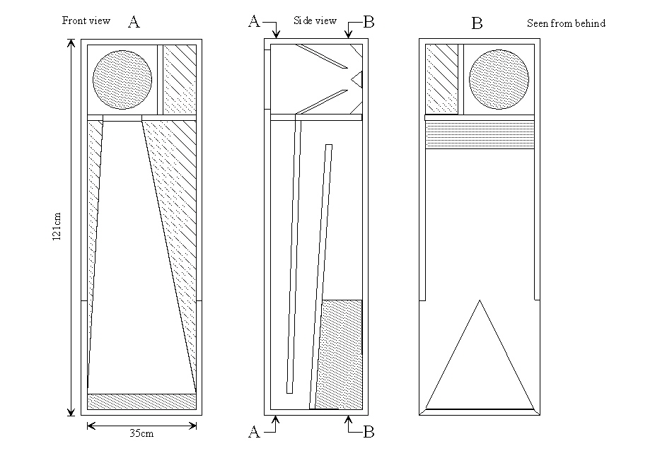

Hello again.
Here's my first suggestion to the hornlayout.
I've split the hornexpansion into 4 conical parts, and splitting the hornmouth with a wedge into the lower rear corners of the enclosure between the floor and wall, wich makes a 5th part of the hornexpansion.
In the chamber I have thought of placing a moveable backwall, so I can see the effect of different volumns.
What do You think?
What do You think?
hello Hoffmeyer,
take the inside walls in triple softfibre 13 mm,
make the press chamber like a foldet Voit pipe,
smaller in my TUBA etc.
driver in the horn, dead end much damm material,
space to chance the chamber volume.
horn mouth and or triangle may be a bit smaller,

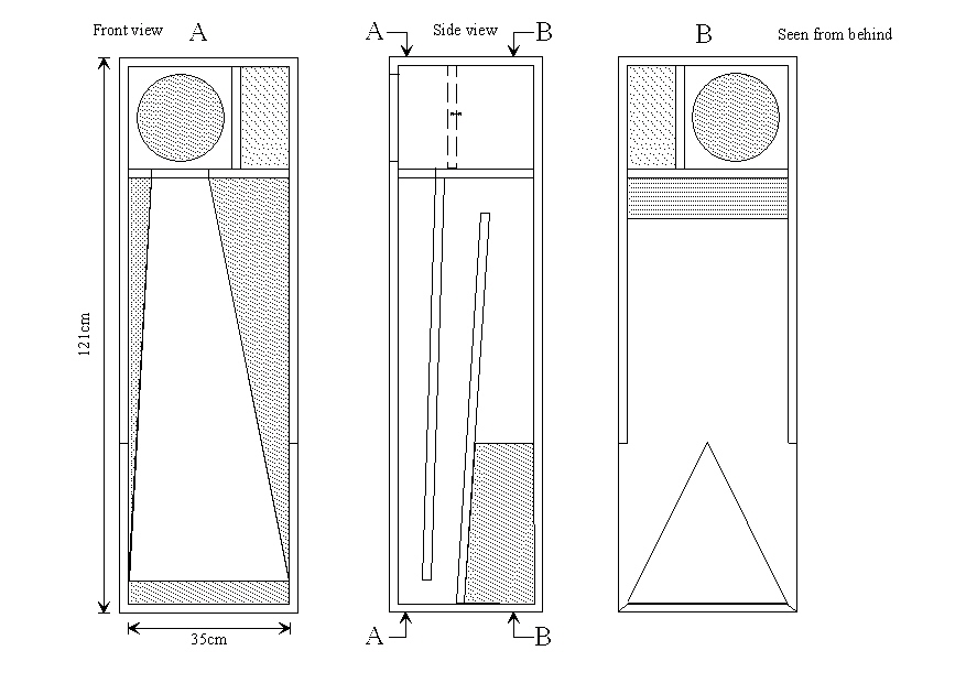

Hello hm.
Thank You for Your comments.
What is in Your experience the benifit of using 3 x softboard vs. a sandwich of softboard/MDF vs. MDF only??
When You suggest making the hornmouth smaller, do You thereby mean even smaller than Your first advice of @1000cm2 (40x25cm) ??
I have attached a suggestion to the layout of the compression chamber with the modifications You have suggested. Please let me know what You think.

Hello,
sorry now i don´t understand your plan,
look my TUBA BASSTUBA HELIKON SERPENT,
press chamber flater, left and the other a right
dead end as i wrote, are you sure about your plan now.
calculate the mouth, length and tell us your size of the cut outs,
than you will understand. how you calculate the triangle?
For that cut outs to big?
Why don´t you show us a list of your calculation, the foldings etc.
all the members can follow the construction way.
If your horn gets near 200 L, reread the SAXOPHON,
and try it.

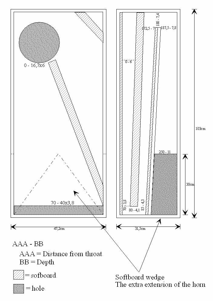

Hello hm.
Sorry for keeping You waiting.
My idea was to make it easier to experiment with the volumn of the chamber, eventhough it would make the enclosure taller, but not to tall for my earheight, which is 1m, when I sit down. It's only the enclosure that is 121cm. The center of the speakerunit is 1m from the floor.
The cross sectional area of the horn is calculated with the formula You so kindly suggested:
AL=(exp(L*k)*AH)*100.000
AL is the cross sectional area at L.
L is the distance from the hornthroat.
k=0,6, the constant You suggested.
AH is the hornthroat area, 100cm2 at Your suggestion.
All multiplied with 100.000 to convert m2 into cm2

Then I added the extended hornmouth at @1000cm2 at Your suggestion, if I understood You correctly. The triangles function and form is to make that part conical.
The drawing is actually precise, but the ratio is unknown 😉
If I understand You correctly, the 3xSoftboard helps to reduce frequencies above 100Hz, which would be the answer to my question "What is in Your experience the benifit of using 3 x softboard vs. a sandwich of softboard/MDF vs. MDF only??"
The 44cm You suggested, is that because the baffle will be supporting the midrange enough to equal and meet the horn output?
In the attached drawing, where I have tried to follow all of Your suggestions, though keeping the triangle at the hornmouth, the hornmouth is placed in the lower rear corners of the enclosure sides, right in the corner between the wall and the floor, where it takes full advantage of the extension and amplification it supplies.
Please feel free to comment 😉
