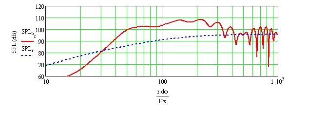

Er, no offense, but what BLHs have you been looking at?
1 very rough back loaded horn 25ft long (7.62m). I've made no attempt at all to refine or reactance annul it -heck, it's only an exponential, rather than a ~optimal hyperbolic. Even so, I might be going blind, but I can't see a suckout below 100Hz. Come to that, I can't see a suckout above 100Hz either.
In fairness, I agree, the more you compromise the impedance matching at cutoff, the more response aberations you will get, but it's complete nonsense to say 'all BLHs have a suckout below 100Hz.' They don't.
No, red = combined response (driver & terminus). Software is Martin King's MathCAD worksheets, the accuracy of which is well known & has been confirmed by many sources, so if you were concerned about that, you don't need to be. 😉 Of course, the above isn't taking practical matters like size into consideration, but it's just to illustrate the point. As I say, I agree, most BLHs will have various response nulls etc as they are usually compromised more or less severely, but it's not a universal truth by any means.

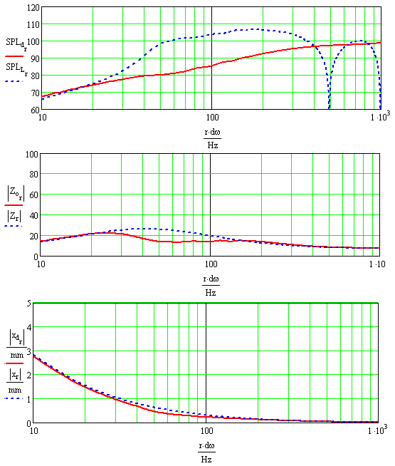

Personally, I don't like exponential horns very much, but that's really more a matter of taste. You could certainly design one easily enough. For e.g., this is a quick exponential horn for it I roughed out, albeit a rather large one.

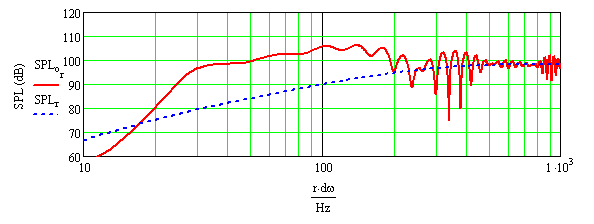

It's a full-sized horn, yes, as I said. Note there's no sign of that sub 100Hz suckout... (OK, I'll let that pass as we're both essentially in agreement -if you reduce the size too far, you'll run into problems 😉 )
What's that? Other data? Have a handful. Excuse the leakage above Fh -frankly, I couldn't be bothered to refine it, as it was only supposed to be a very quick example.
