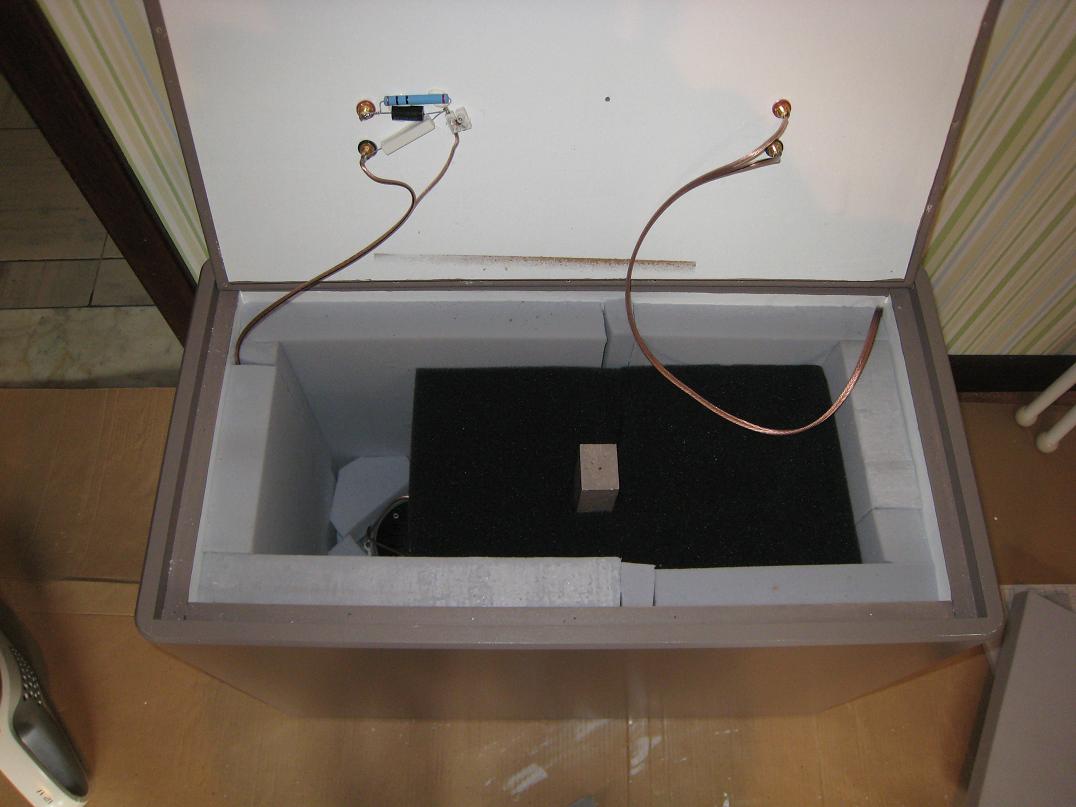

A little update on my progress...
I got several qoutes for 75ppi open cell foam (Bulpren S 31 062), but this stuff is too expensive for me (more then 200 euro to fill the entire speaker, per speaker!).
So I filled the inner volume with 30 PPI filterfoam (can be got quite cheap at the local pond shop) and I lined the side walls with 5cm Basotect (an open cell melamine foam of 200 PPI that can be got quite cheap here)
The enclosure has the following inner dimensions: 420 x 316 x 658 (D x W x H) and is loaded with an AE speakers TD12M and a CD horn (Geddes 12”).

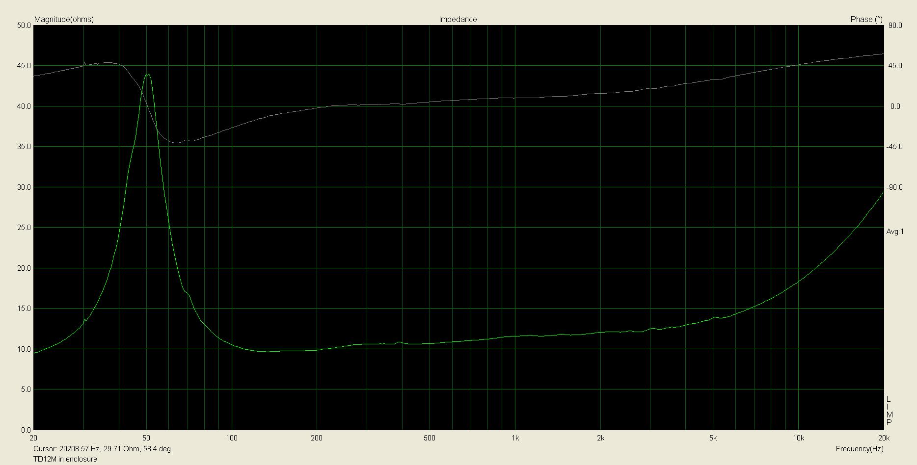

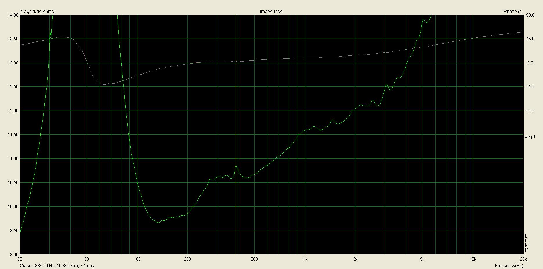

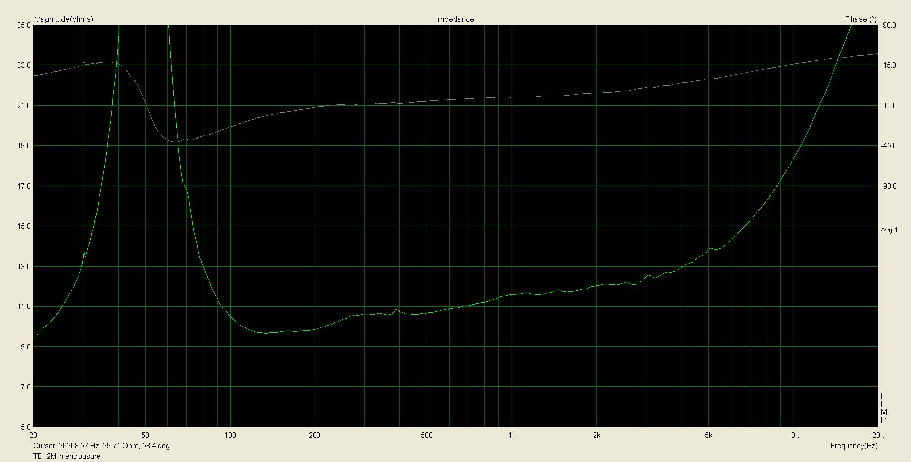

I measured the impedance of the TD12M installed in the filled enclosure, and to my eyes it looks very well-behaved (see the scale on zoomed chart), so I would think the damping material has done a decent job. Does anyone know above what point an irregularity in the impedance becomes significant? I seen examples with peaks of 3 ohms and more, so I would think 0.26 ohm (my highest peak) would count as insignificant…
