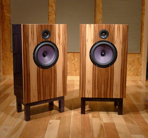

You'll have something that looks like the attached image (DeVore speakers), but they will cost you a lot less than $12,000 🙂

4) Salvage some old boxes. Strip and smooth them.
Glue on a new front panel (e.g. CNC plywood skinned with a premium veneer).
Apply masking tape, and paint the other panels a flat black.

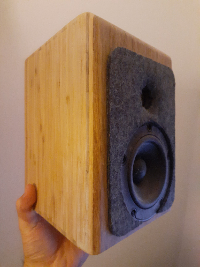

Here's a pic of my Ikea speaker. Most of the workmanship was a bit naff - the only step that matters is smoothing off the rough edges at the end.
The felt front is mainly because my hole cutting was imperfect.
A fat bit of felt also has acoustic benefits, it reduces baffle diffraction effects.
