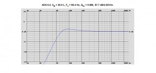

I'm re-purposing a pair of car speakers into desktops.
As such I've been playing with various programs to calculate an enclosure.
The bass drivers have some odd specs that make it hard for me to decide on sealed or vented.
I'm leaning towards 20 ltr sealed at this point.
ADS 6.5" (Proper ADS, not the newer stuff)
Driver free air specs as measure with Dayton DATS.
Re 4.098
Fs 53.16
Qts 0.7534 <-- this is why I'm here double checking enclosure style and size.
Qes 0.875
Qms 5.419
Le 0.3646
Mms 14.65 Grams (added mass for Vas test was 14.5 Grams)
Vas (added mass) 12.14Ltr
WinISD is showing 20 Ltr sealed or ported as being not a huge difference.
Obviously the closed box is showing far Superior group delay.
REW (5mm Close mic'd) shows a 20ltr sealed test box as having a smoother roll off than the same box ported with 6cm diam 15cm long port.
So, does anyone see anything that suggests I shouldn't go foward with a 20ltr sealed ?

I take it that measurement is nearfield on the woofer. Shows tuning about 43Hz.
You need to do a nearfield on the port and add it in (vectorially) to do an apples-apples comparison. You will have a broad port resonance with such a high Q, so the peak above tuning will be higher and there will be a bump before dropoff.

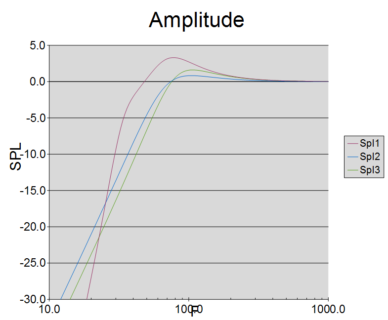

If it were me, space would be a premium and I'd go with ~10L, but there is nothing wrong with your 20L decision. Here is your woofer with a 20L vented box tuned to 43, 20L sealed and 10L sealed.

The rew sweep is indeed near field.
5mm from dustcap center.
I wouldnt mind a smaller box.
But when i built the current cabs yeeeeears ago, 20L ported seemed best. I've learnt a little since then 😉
10 L sealed looks pretty good to be honest.
I didnt think it would be such a small difference.

20L sealed looks very good, F3-52Hz. High Qtc close to 1.
10L gives a Qtc = 1.16 and F3-58Hz.
Works fine sealed with a L/T (Linkwitz Transform) also.
Looks like making for a nice 2-way speaker.🙂
