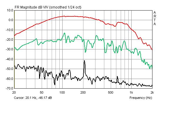

Hai,
I was in the mood to measure what is speculated on so eagerly.
(1) box made of cheepest particle board, 16mm resp. 5/8" thick, front/backpanel 420 x 300 mm^2 resp 16" x 11". Absolutely no bracing, damping whatsoever, very lousy glueing too.
(2) The box was placed with about 3cm resp 1" spacing to the wall. The circimference of the box was loosely tightend with a blankett. So in between box and wall a damped cavity was build. The mic was placed in that cavity, nearly centered.
a) measured amplitude vs. frequency with back against the wall
b) same with front against the wall
My assumption is that the measured levels represent what the speakerchasssis (b) and the cabinets back wall (a) contribute to the total soundfield. The pic below shows what I achieved. Cabinet part is well down 20dB+. One may argue that a stronger seperation of the cavity in which the mic hang would have given even higher dampening figures. No resonances! No hassle. And that was a very flimsy construction!
So that is the monster You have worried for so long. Ain't it funny in the end? Keep heads up,
by
The black curve shows the background (noise etc).

xpert,
the experiment looks valid for a first guess. 20 dB+ is very modest - you would never accept that from any CDP or amplifier, so there is no need to be ebullient. Granted, results would become better with an improved test setup.
Resonances? I see the major deviations from a smooth curve at just above 100 Hz, above 200 Hz, 400 Hz and 800 Hz. Makes me thinking ...
