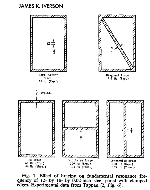

gedlee said:A simple cross brace, from front to back and side to side, attached in the center does wonders for reducing the lower order modes - the worst ones. If this brace is rigid, like the oak that I use, then the brace will not compress (oak is VERY strong in compression along its grain) and it will thus connect the two opposite sides together fixing them to be a fixed distance appart.
Iverson's AES paper concluded that this bracing strategy was the least effective.

Hi Dave
You misunderstand. The braces are not in the plane of the panels as shown in your drawing, but across the enclosure from one side to the other. The braces as shown do very little by comparison.

gedlee said:You misunderstand. The braces are not in the plane of the panels as shown in your drawing, but across the enclosure from one side to the other. The braces as shown do very little by comparison.
As i understand your description (here & elsewhere) your bracing scheme is the top-left illustration. A dowel of some cross-section, extending from one side of the enclosure to the opposite. Especially if placed in the centre of the cabinet, this turns the panel into an anular radiator.
dave
dave
Thats true, but from the standpoint of "stiffening" this is as good as it gets. Forcing the point of maximum excursion to zero excursion is the ideal. Lets face it its impossible to make something that "can't resonate". The idea is to do the best with the least - to do just enough, and not more - its called engineering.
