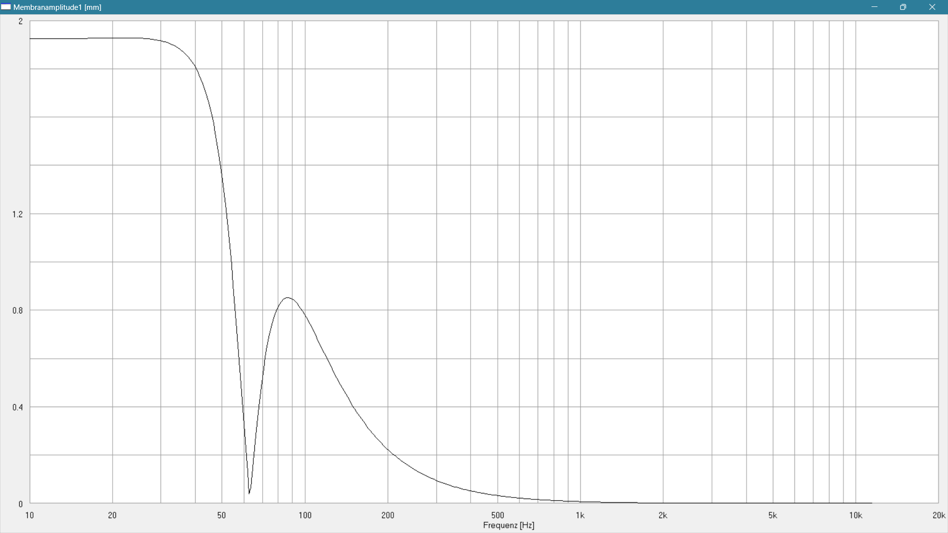

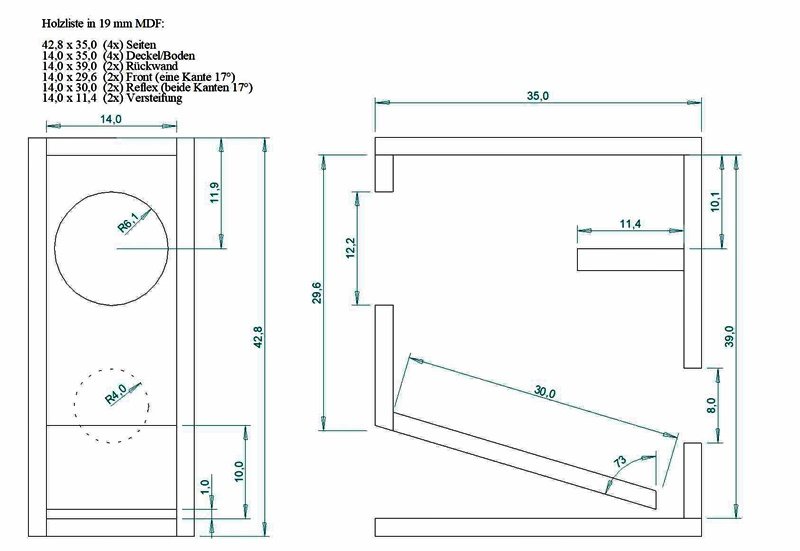

Can anyone simulate the two cases or give me some advice?
They are probably very similar bass reflex enclosures, the "horn" is just a tapered reflex port. I would not build any of both but try to make a flared port mass loaded "transmission line" (or a simple bass reflex box) with the port at the back of the enclosure.
Look here: https://www.diyaudio.com/community/...rbers-and-port-geometries.388264/post-7695049
Edit: Why would you need another simulation? The first example includes a simulation graph and the second even a measured response graph!
Reactions: hbtaudio
Hello Bronkowitz,
more than seven years ago I installed exactly this full range driver in the Udo W. proposal. Like you, I was also flirting with the Alpha suggestion, and I was also thinking about a horn or a TML. After endless simulations with the most popular German programme AJDorn, I simply made a decision: that's all you can do with this fun loudspeaker. To cut a long story short: I widened the baffle, moved the port to the rear, glued in an angled reflection board and coupled the driver to the resonator without any huge offset. Everything worked perfectly, but in the end the sound was extremely disappointing. The RLC blocking circuit is not sufficient to make the frequency response tolerable. From 200Hz to 4kHz you have to reduce the SPL considerably. Between 4 and 5kHz you have a huge resonance peak, above 10kHz an absolute catastrophe.
A combination of parallel resonant circuit and series resonant circuit passively pulls down the entire midrange and levels everything out so that you can then actively equalise.
Actively corrected everywhere, this little speaker is amazing, really good. But now also completely without efficiency. The rear port, which is unfortunately equivalent to an additional midrange horn, does what it is supposed to do as a BR sufficiently well, and the additional information it throws backwards from 300Hz to 2kHz fills the room with ...
With marvellous phantom sound sources!
Without an acoustic measurement system (I've been using CLIO for eons), this driver will drive you crazy. Unfortunately, this concept only achieves a usable frequency response with active equalisation. And since some of the corrections are very massive ...
HBt.
PS
I was pretty disappointed, but if you actively equalise, then it's really cool. The horn reflex thingy belongs at the back.

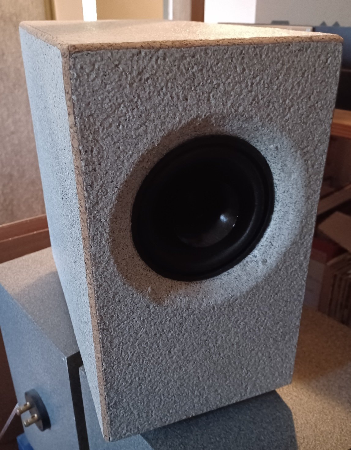

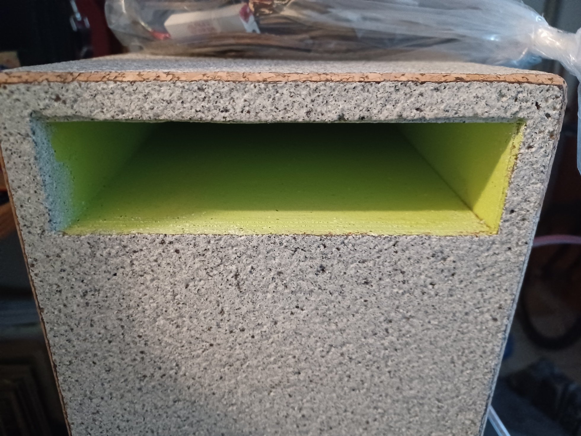

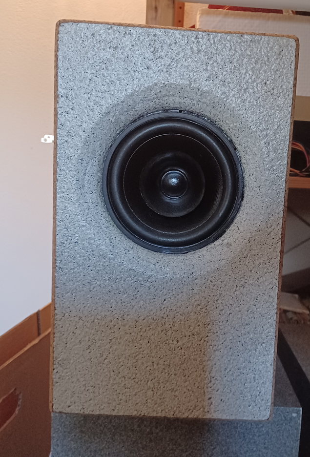

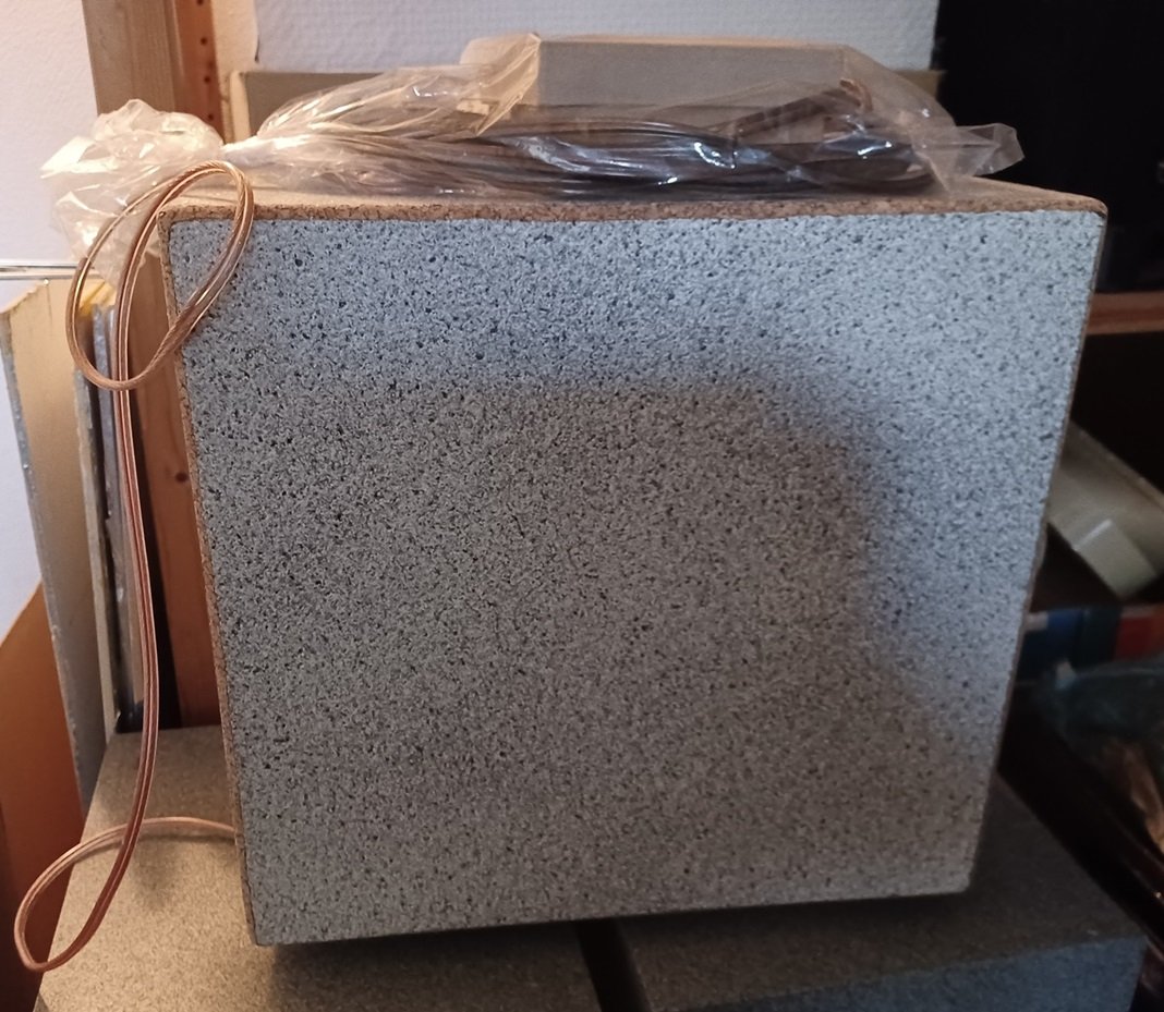

The
  • front may still be missing a veneer (like a waveguide), but I never got around to printing it. The membrane has been coated several times with Visaton's LTSxx coating
  • housing is a lightweight construction, poplar multiplex with cork and PU coating
  • reflection board inside is at a 60° angle, all the inner surfaces are covered with Visatons white insulating/ damping material ..!
Reactions: stv

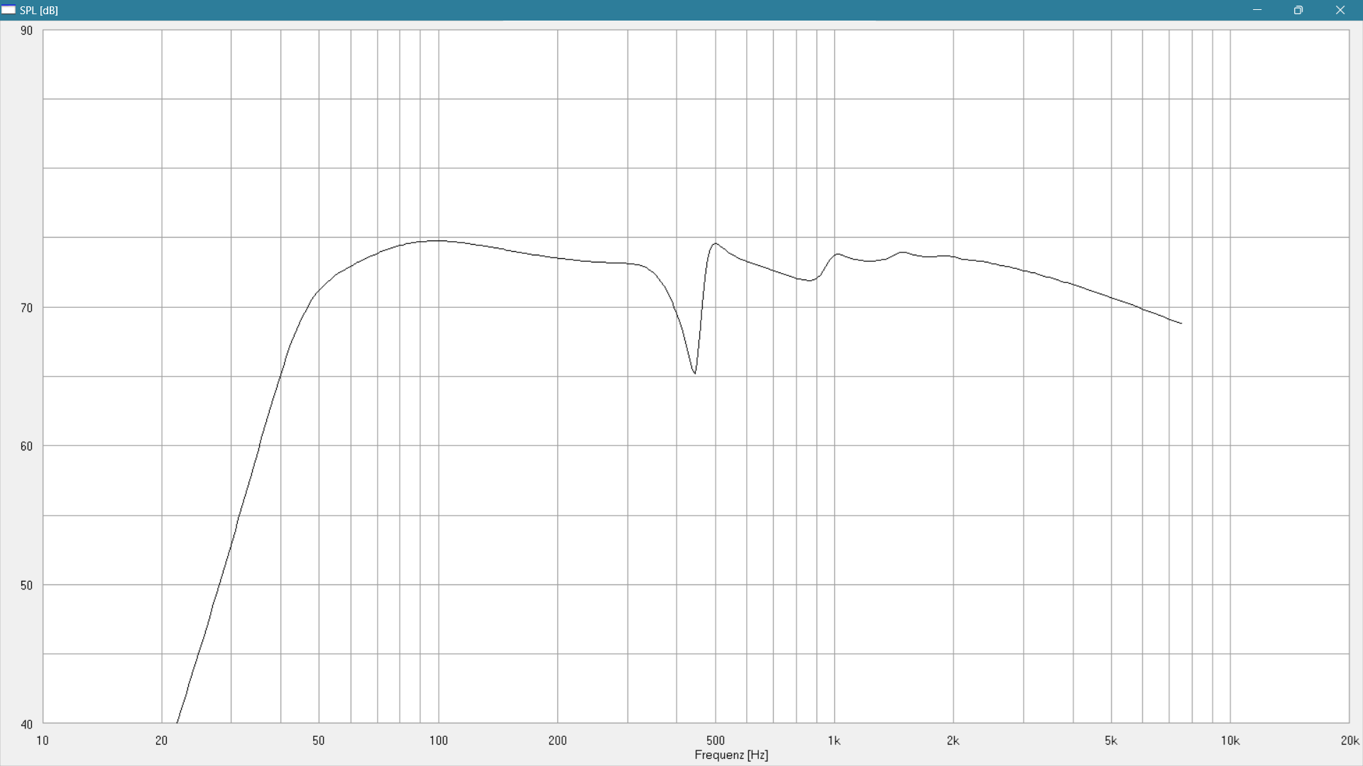

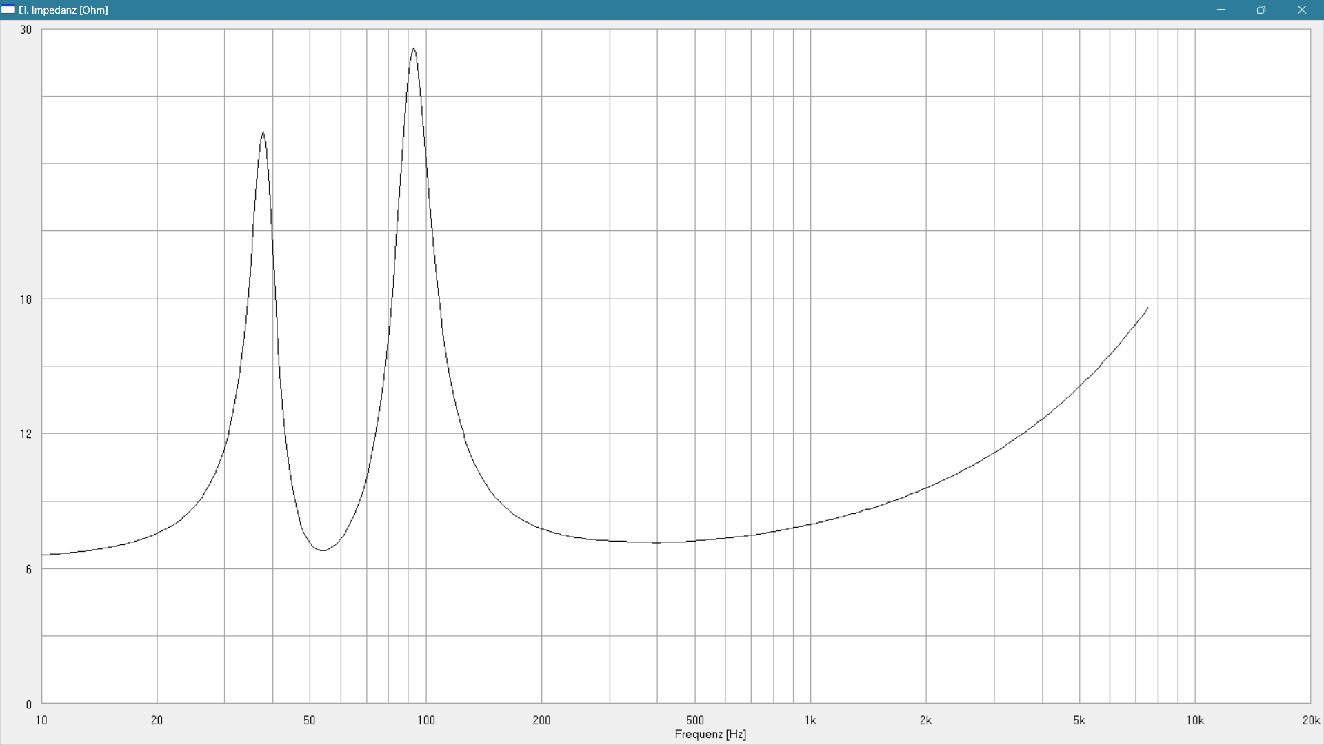

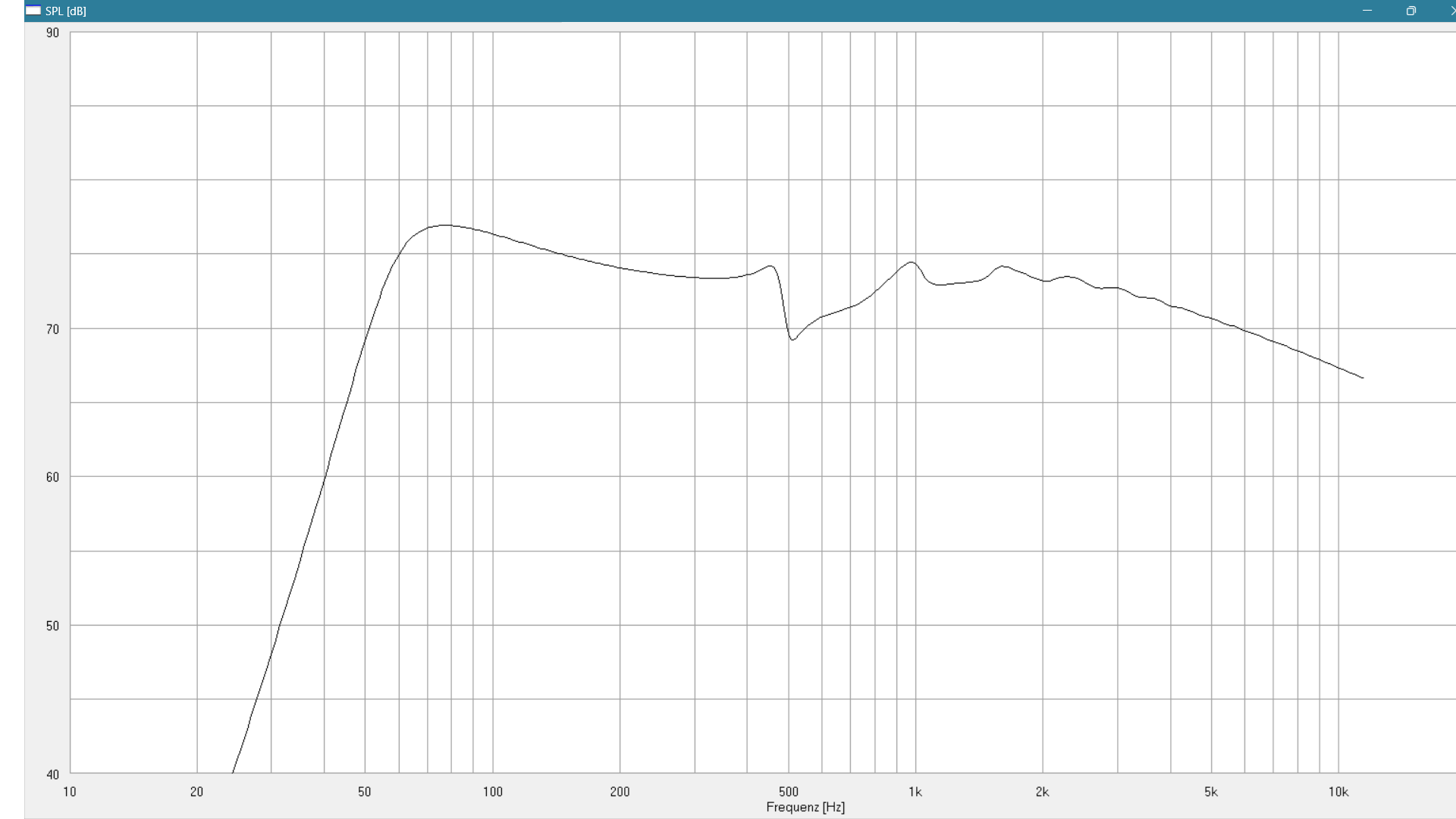

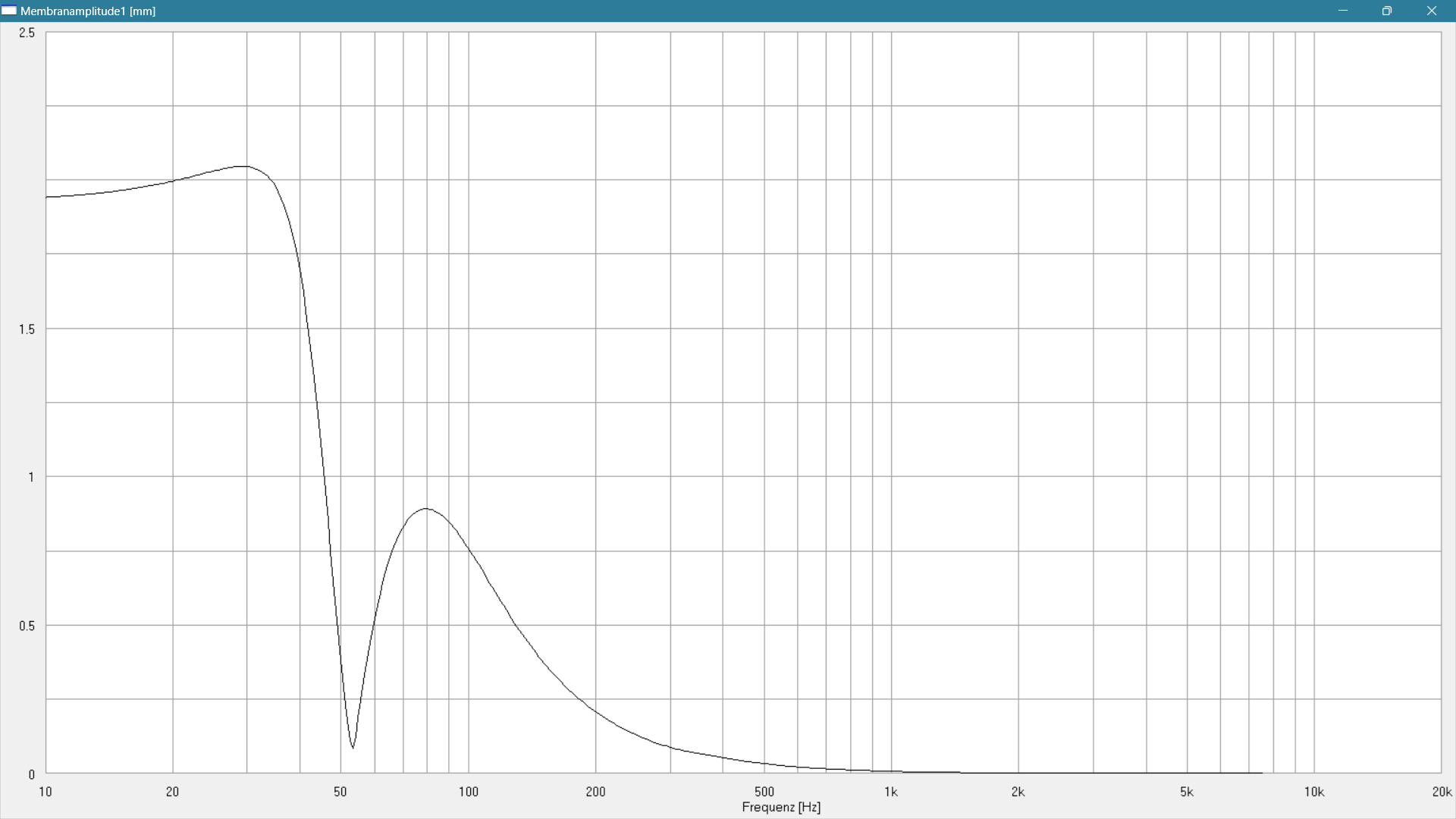

it's all about an environment (the cabinet) for the drilled-out SPH60X midrange driver, which you would like to see as a bass-midrange driver and, with its additional twist cone, as a full-range driver. Nothing more and nothing less.
Udo W.'s and Heinz S.'s quick suggestion from the 01/2001 issue of K&T provides a 13-liter air cushion and the Alpha of the “Hornfreunde” also uses this volume (this mass), both resonator incarnations are tuned to approximately 54Hz.
Now you have to decide for yourself what all these equivalent high pass filters (the bass reflex enclosure) should look like.
Of course, I have not only simulated these two suggestions, but have also carried out countless electrical and acoustic measurements.
The Alpha looks much more appealing than the “horn reflex resonator” with its later slightly adapted resonator geometry.
As a result, both implementations are actually quite close to each other, i.e. if you want a nice front with a visible port, build the Alpha with the “later” 45° opening of the mouth.

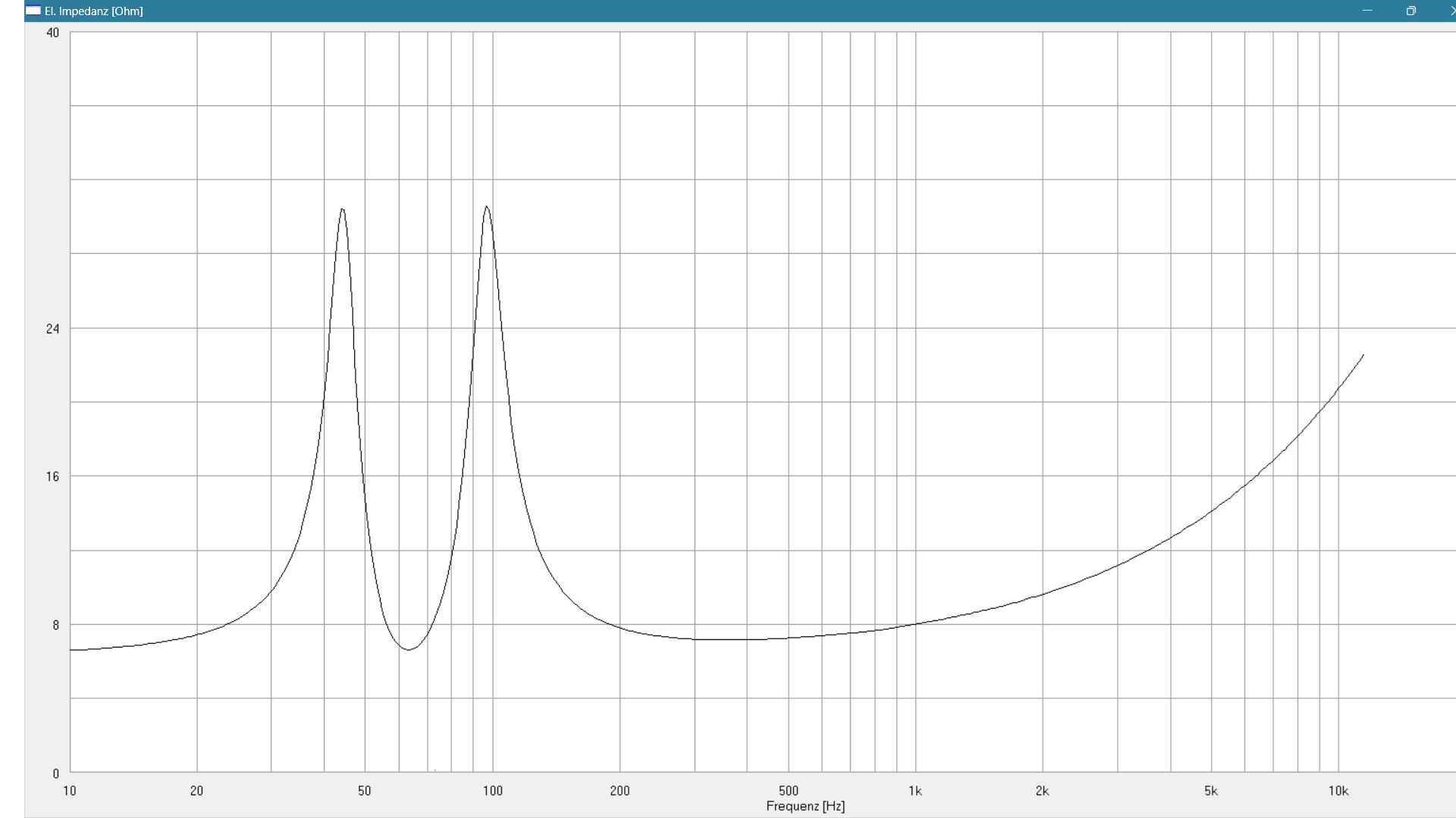

my TSP:
Rdc = 6.33Ohm
Cms = 0.907 [mm/N]
Mms = 5.54g (5.47g)
Rms = 0.88 [kg/s]
BL = 4,73 [N/A, Tm]
Qts = 0,56
Qes = 0,7
Qms = 2,8
Vas = 8ltr
fs_o = 71Hz
Sd approx 78.86 cm^2
Xmax = +/-1.3mm
All measurements match the simualtions! Acoustically, they are even strikingly similar to Udo W.'s releases.
Build the Alpha:
AH 25.2cm^2
AM 64.8cm^2 final enlarged to 144cm^2
l_horn_resonator approx 30cm.

Or classically a real BR:
Vbox = 21.5 ltr
fb = 52.4Hz
But simply let your own ideas come true. Enjoy building.

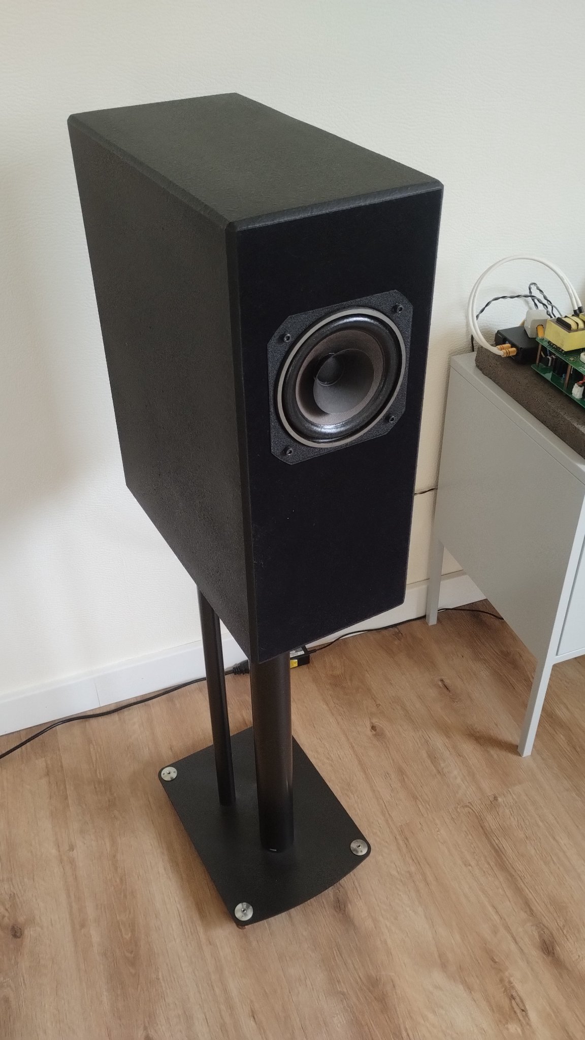

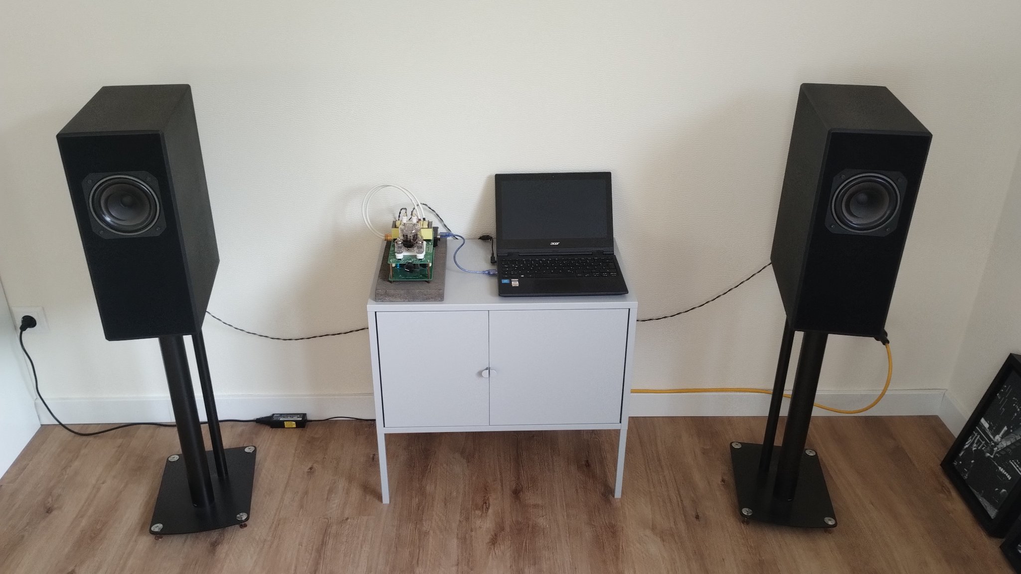

I built the CT193 a while ago, but moved the vent to the rear for aesthetic reasons. Since I didn't trust myself to paint it properly, I coated the case with automotive underbody protection, and the front panel is covered with velvet film.
I recently found the Alpha and am wondering if it's worth building a new case...
Reactions: aroS3 and hbtaudio
Well,
there's not much you can say now. It looks very successful - and the port is at the back, the reflections of the nearby room walls certainly (will be) result in an interesting, virtual acoustic 3D sound image.
