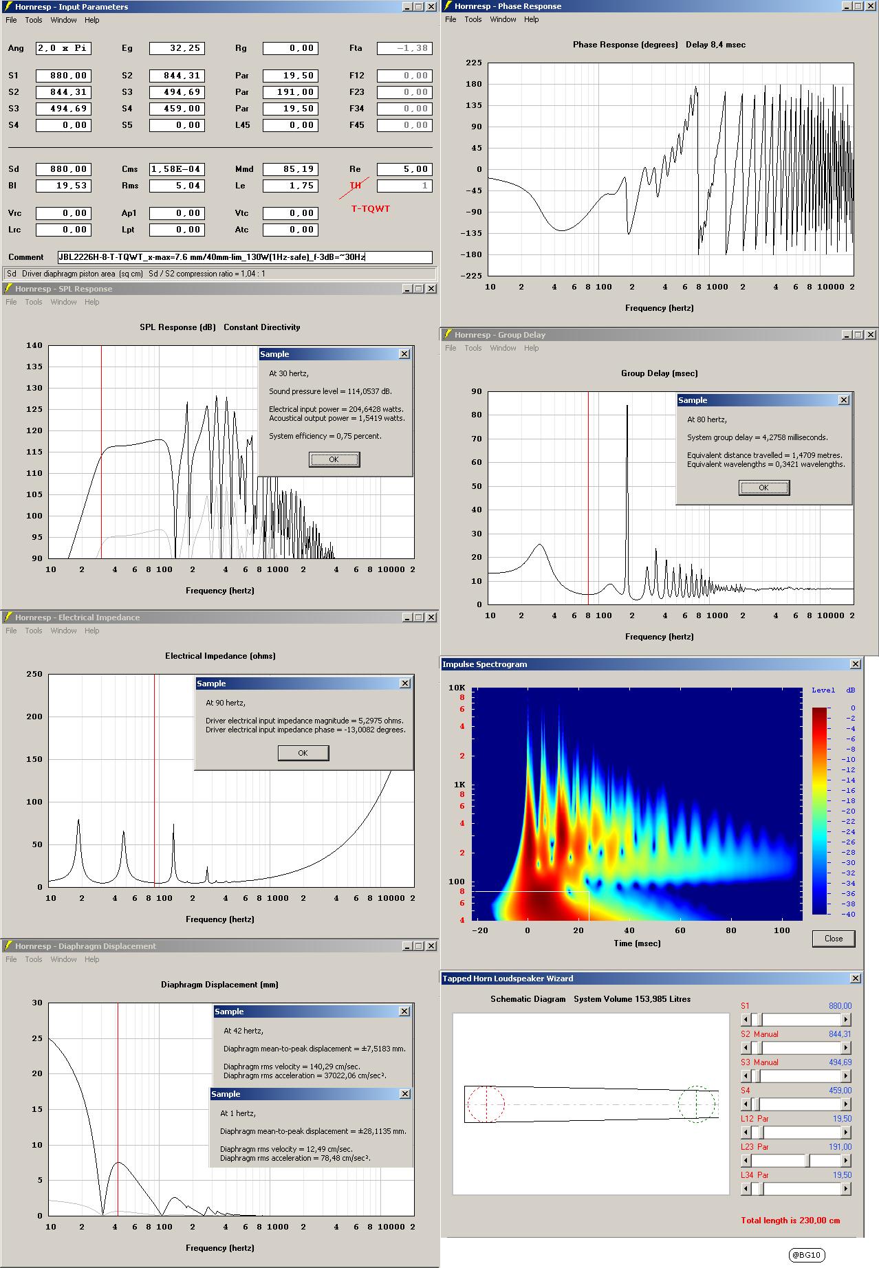

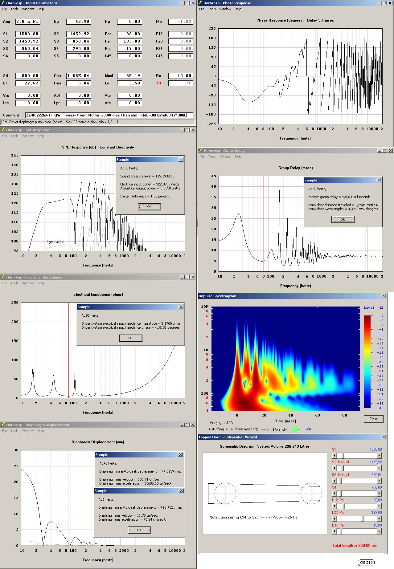

Hi, What JBL 2226 version? In case of using 2 x 2226J at home , I suggest to consider a T-TQWT:
b🙂

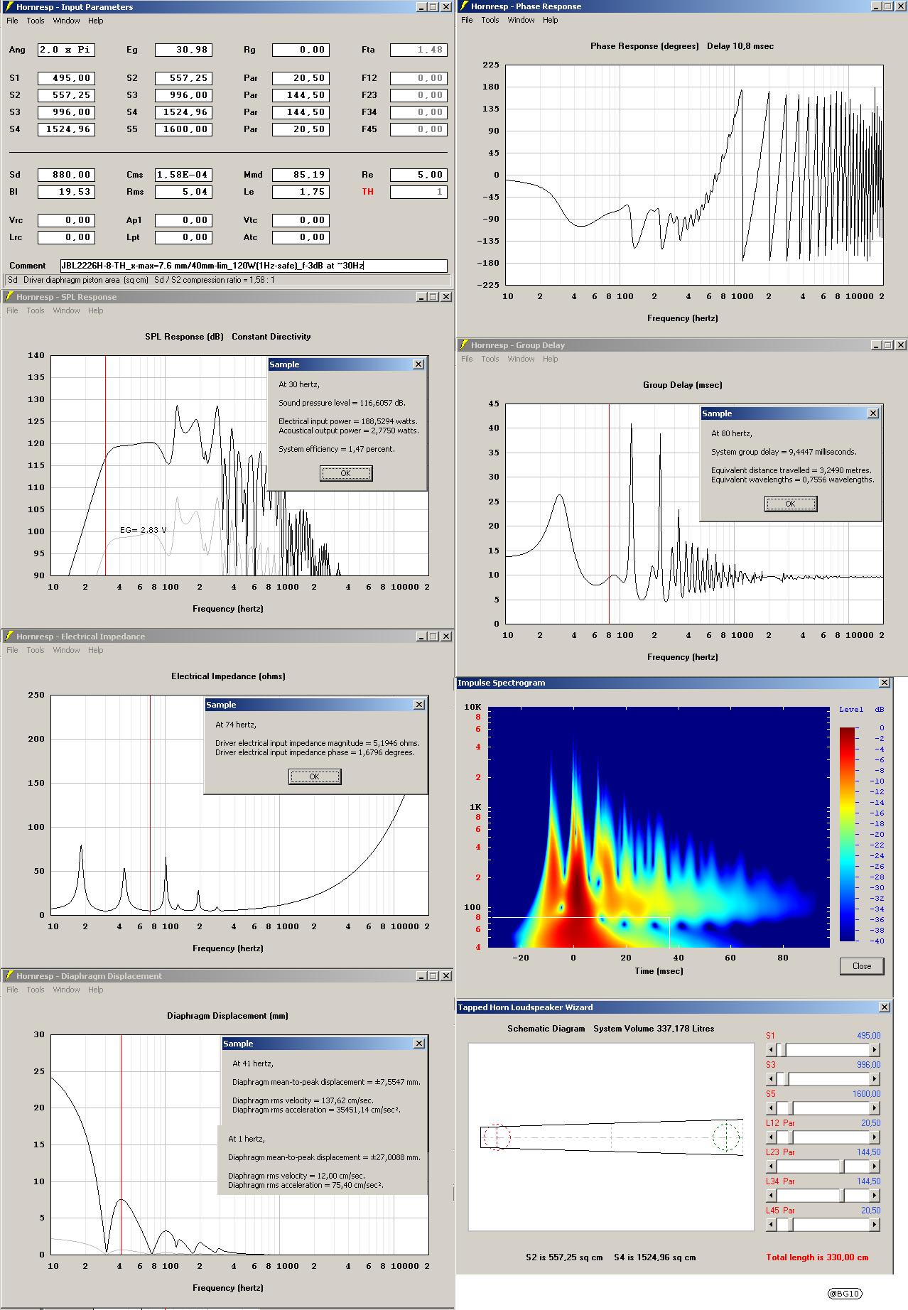

Bjorno, Wow, that's a great looking curve, and apparently doesn't work very well with the 2226H, I tried modeling in hornresp, got nothing like what yours looks like- though I can get about 103db/1watt from 30hz to well over 100hz, but varies from 105 to 110db so not that flat. The grp delay gets huge below 30hz-but this box is still much louder than the JBL boxes at 97db even if they have a flatter response. I've never built one of these-so would have to model it-something I am not good at. Zilch modeled the JBL pretty well in some box software making it fairly easy to copy. Do you think the this driver is still viable for your T-tqwt. I almost think I had to make some mistake, I can't believe how different the response is just from Re and Le changes.
Here are some simulations for the JBL 2226H version using only a single driver to compare with:
b🙂
Ps: IM0: The gldy is blameless if not exceeding 1/f (mS) below ~50 Hz.
Thanks Bjorno- for some reason, even copying your hornresp spec's into mine, I'm not getting the same result-you have to use TH as there is no Tqwt option, right? Do you know of anyplace to find this type of enclosure labeled with hornrep parameters? Any thoughts about what this type of enclosure sounds like vs a standard vented/ported or a bandpass enclosure?
