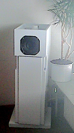

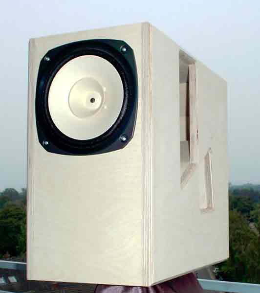

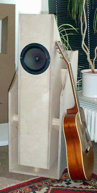

Hello,
my sat horn Schalmei
and the new double horns
Saxophon and RDH20
are a superb solution
for filip drivers
Hmm. Well, I've just waffled my way over the AER site, & Q isn't particularly low, so it's a good choice for back-horns as the mass corner is reasonable, although they'll have to be large if you want any LF gain out of it & don't particularly wish to add extra drive units. The specs. on the AER site, being averages, don't quite gel, but they're in the ballpark.

because in my horns the driver didn`t
drive in their reso they are no basshorns.
the Qts isn´t so important,
look the B200 it works but the simu says no,
only by the 2 driver it makes bass, stroke
controlled by the driver of the bass horn.
