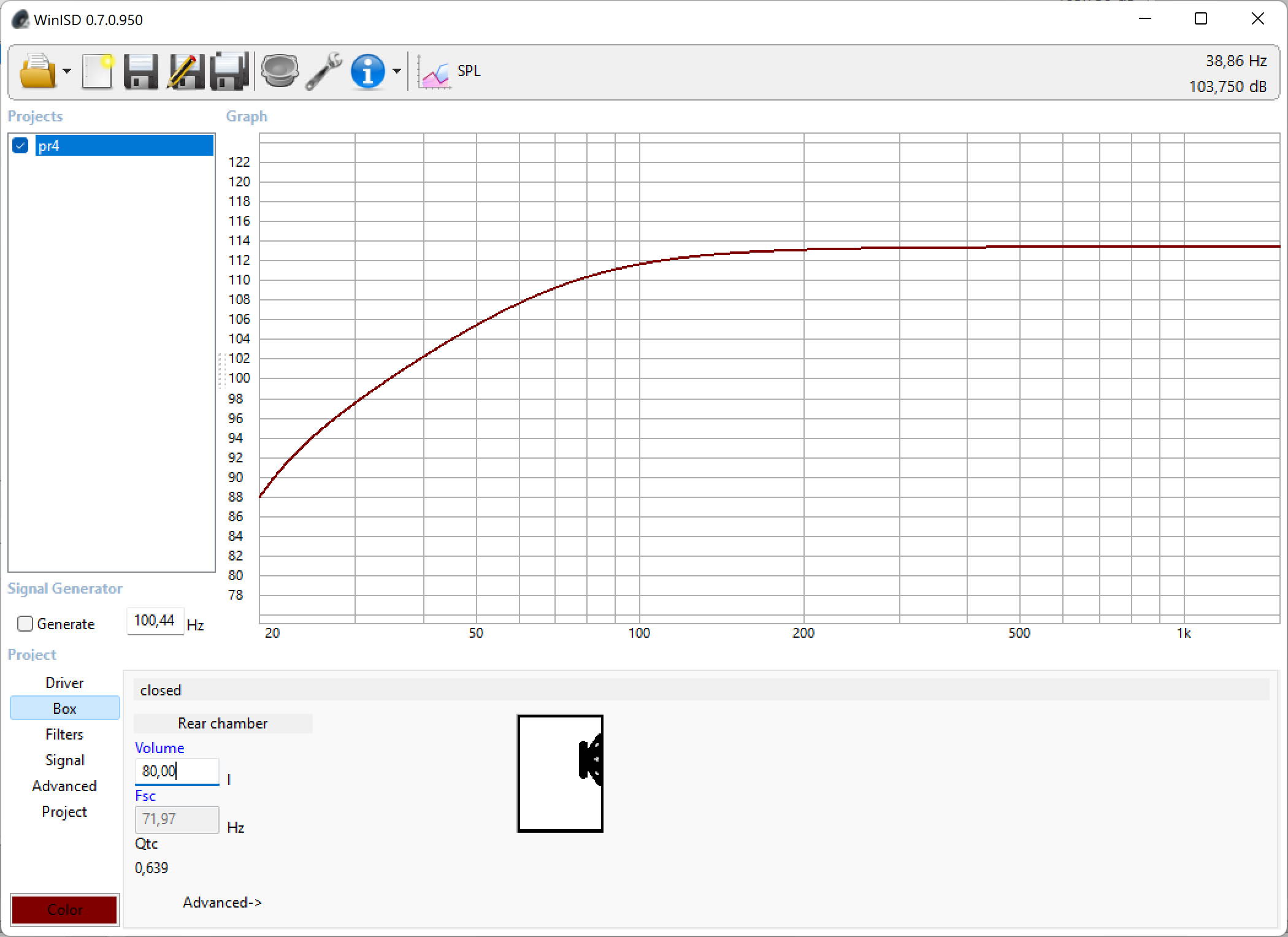

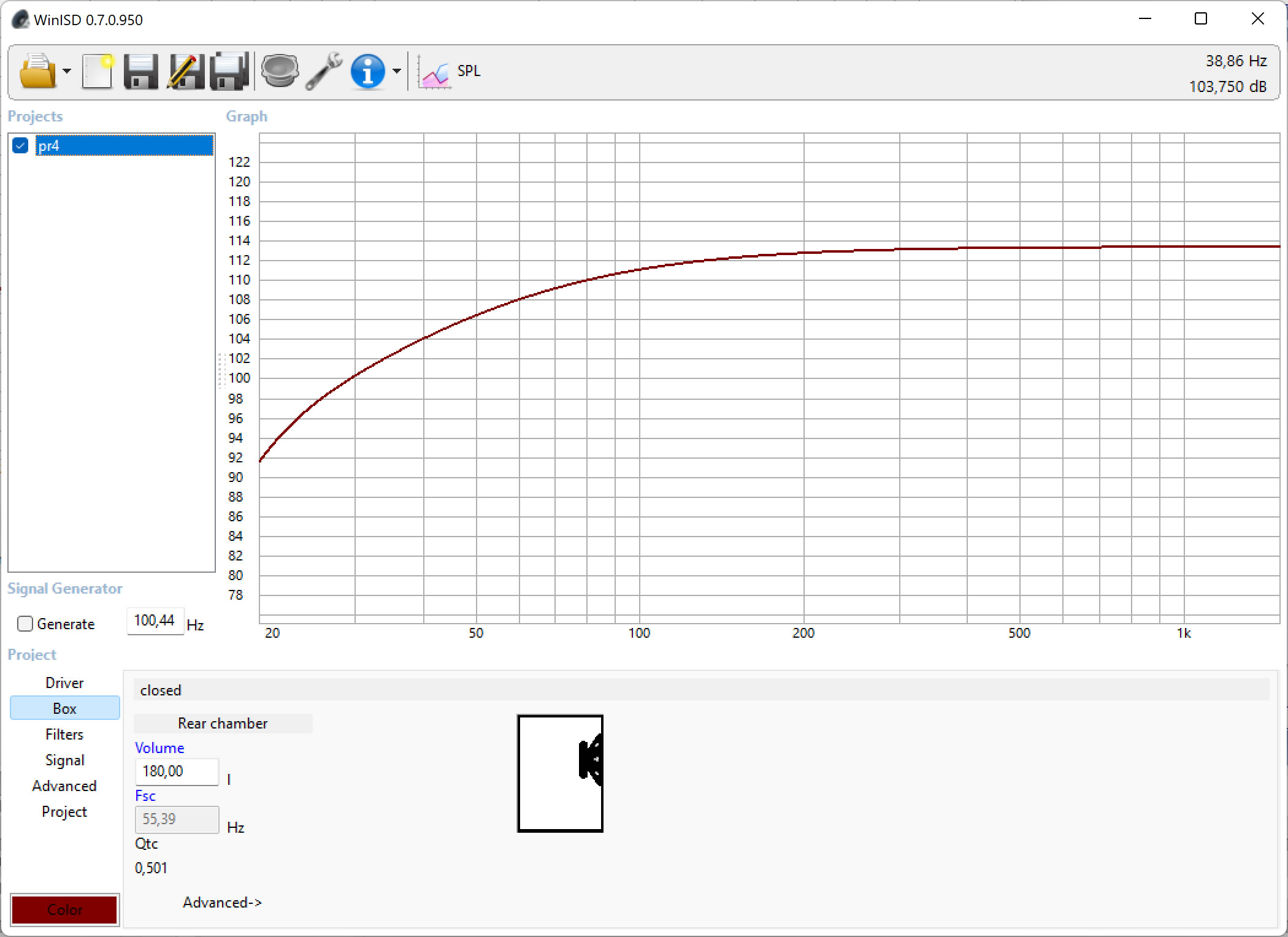

Simming it in WinISD, the box volume doesn't affect max SPL too much. In a closed box, you're pretty much xmax limited and the 15PR400 doesn't have a lot.
180L only gives you a couple of dB's. You do get a nicer roll off.
You can still hit 105dB @ 50Hz in 80L. Depending on your situation, that might be more than enough.

So if I made an 80 litre enclosure this would improve midrange intelligibility? How would it impact on max spl? My room is 8x6m listening seat is ~ 3m away from speakers the loudest I listen is 105db peaks (rarely) most of the time 80-86db. I am assuming a smaller box at these low volumes will make no difference and I will only get benefit??
Hmm, based on published specs + 0.5 ohm for wiring losses [~0.351 Qts'] its upper mass corner where T/S design theory peters out is ~200 Hz, so just using HR's Wizard, the box can be as little as ~40 L before it begins affecting its phase response > 250 Hz where the mid-range begins and of course increases peak power handling.
In short, it's the driver's mass controlled BW combined with the baffle/whatever loading, room modes that dictates its midrange intelligibility and since it's also the XO point, its design will dominate, so ideally 1st order.
