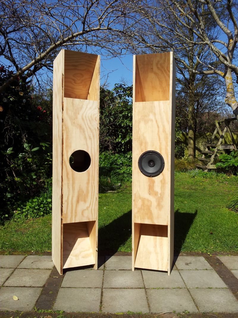

lookee what I built
They are as rough as GUTS
First significant build so I made some mistakes... learnt a lot though so no big problem ;P
Where can I get the plans? Thanks.
