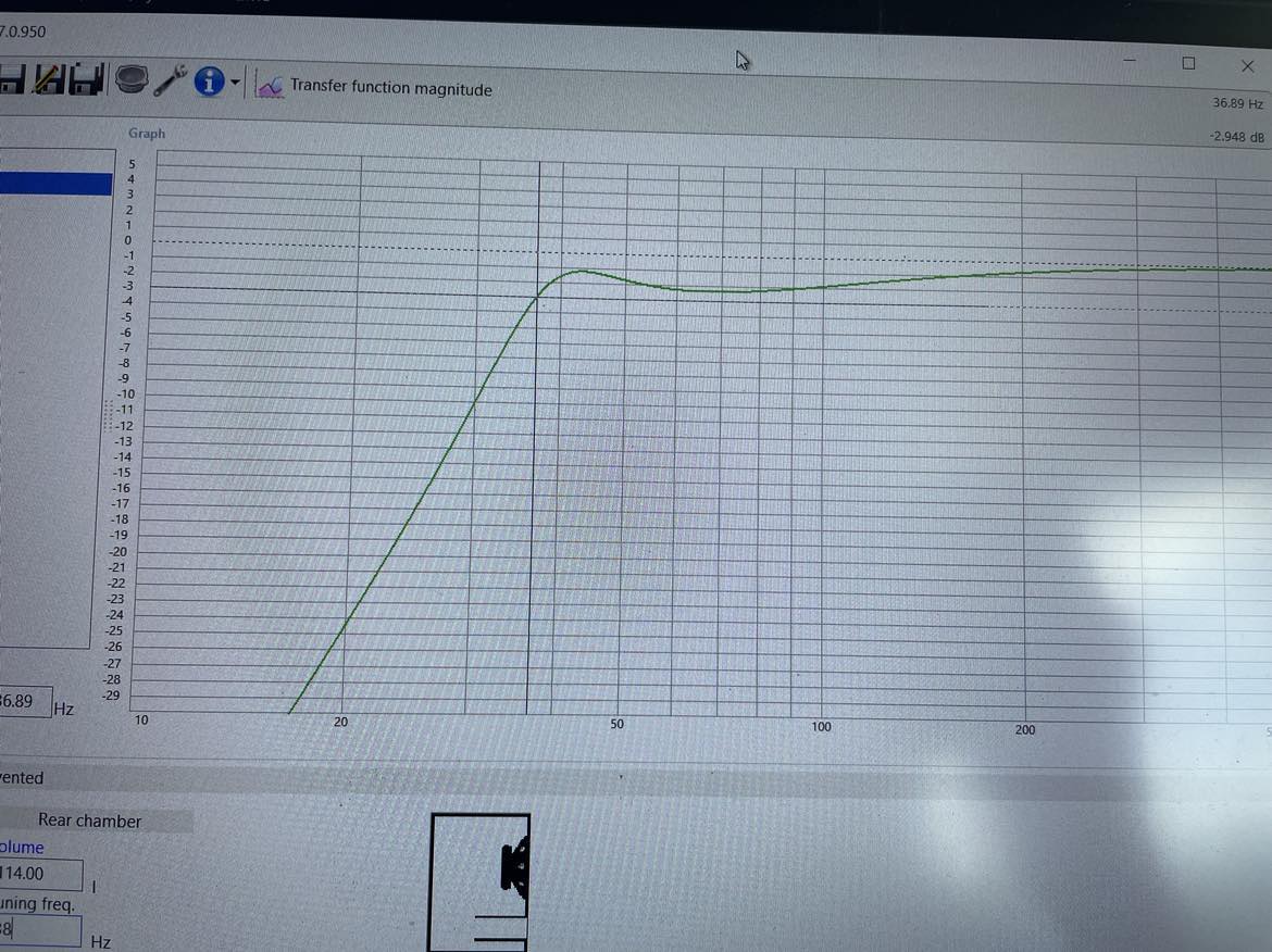

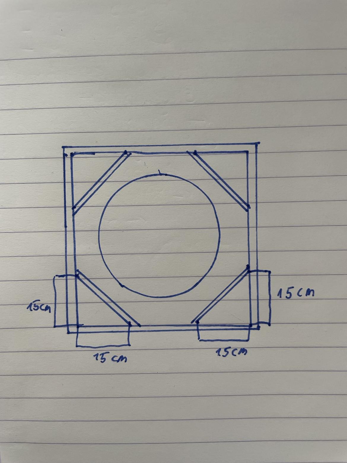

When designing an enclosure, let's say Vb=114l and Fb=38Hz. When building the enclosure, you need to build a bigger enclosure like 140l and then substract the driver volume and air vent volume or i build straight an 114l box?
And I can t really understand how triangle ports work even after a lot o reading... I want to build 4 triangle ports, 15cm each side like this, but i cant figure out the length needed for 38Hz and an air velocity under 25m/s. I looked on other designs but they doesn't specify the air velocity so I can't really figure out why they made that length.. Next week i want to build the subs, I need it for my church
Edit: I atached a photo of what I want from the B&C 15TBX100, F3 is at 37Hz, I think it s ok this enclosure for this driver.

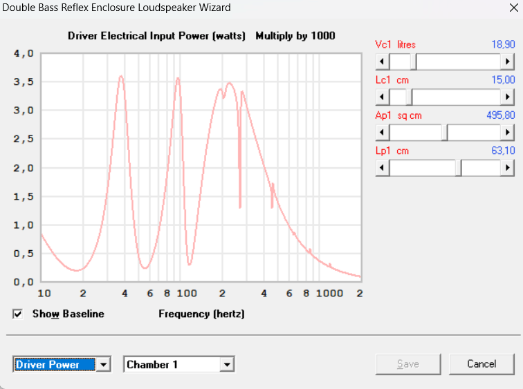

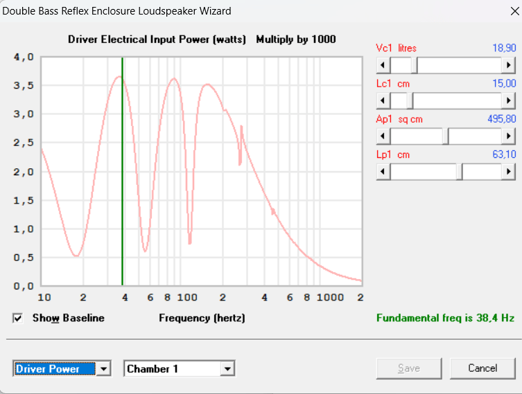

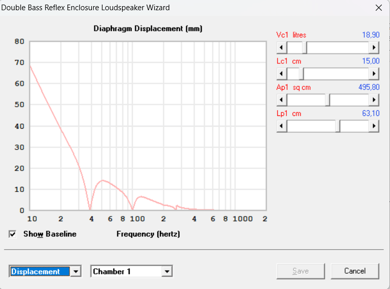

The driver with higher Bl/Re will move less above tuning frequency. but it will have a lower SPL at displacement peak too (that's why an active filter can erase this problem). The driver power graph on hornresp shows the same driver with a lower Bl takes more watts at the same voltage above tuning frequency (that's probably the reason).
But at tuning frequency the higher Bl has higher SPL.
Edit: here's a good example with the B&C 18IPAL (huge Bl/Re ratio) in a 144,533l DBR enclosure (internal volume) with a 70v input:

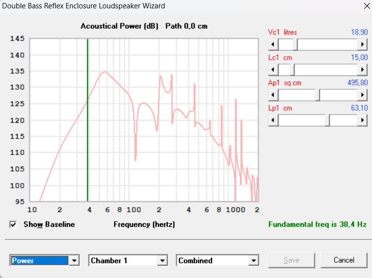

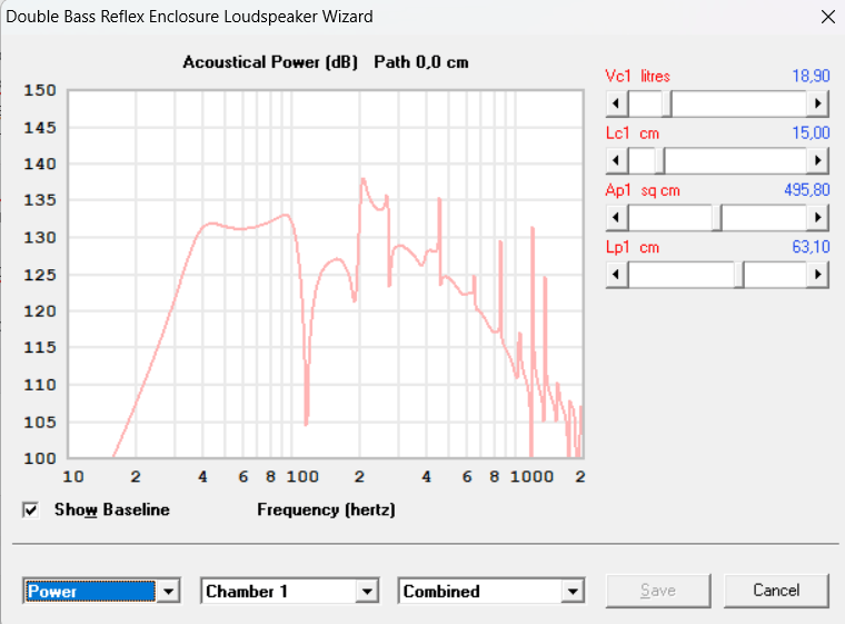

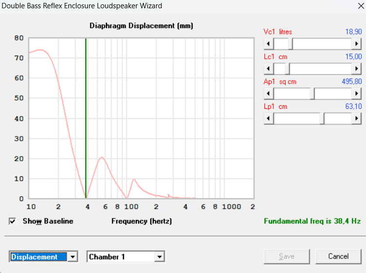

VS the same driver parameters except with a Bl reduced from 24,5 to 14,5:
BTW i'll see if i can make one with a less expensive driver that can go up to 120hz.
I have looked at your example, and the fact that the driver with lower Bl/Re is moving less above the fundamental tuning frequency simply appears to have resulted from the low-frequency SPL peak in its alignment. Higher SPL output requires larger displacement from the same size driver. Wouldn't it be the case that if the lower Bl/Re system were to be electrically equalized to flatten its SPL peak, then the displacement curve would become more like that of the system with the higher Bl/Re driver?
You can flatten with an active filter that reduces the amount of power above tuning frequency but the output will still be below around tuning frequency (see the driver power graph, it's the same amount of power at tuning frequency while it's way below in SPL).
Higher Bl/Re means stronger motor so also more displacement (which is more easily seen with smaller drivers on the displacement graph) around tuning frequency and then more SPL.
