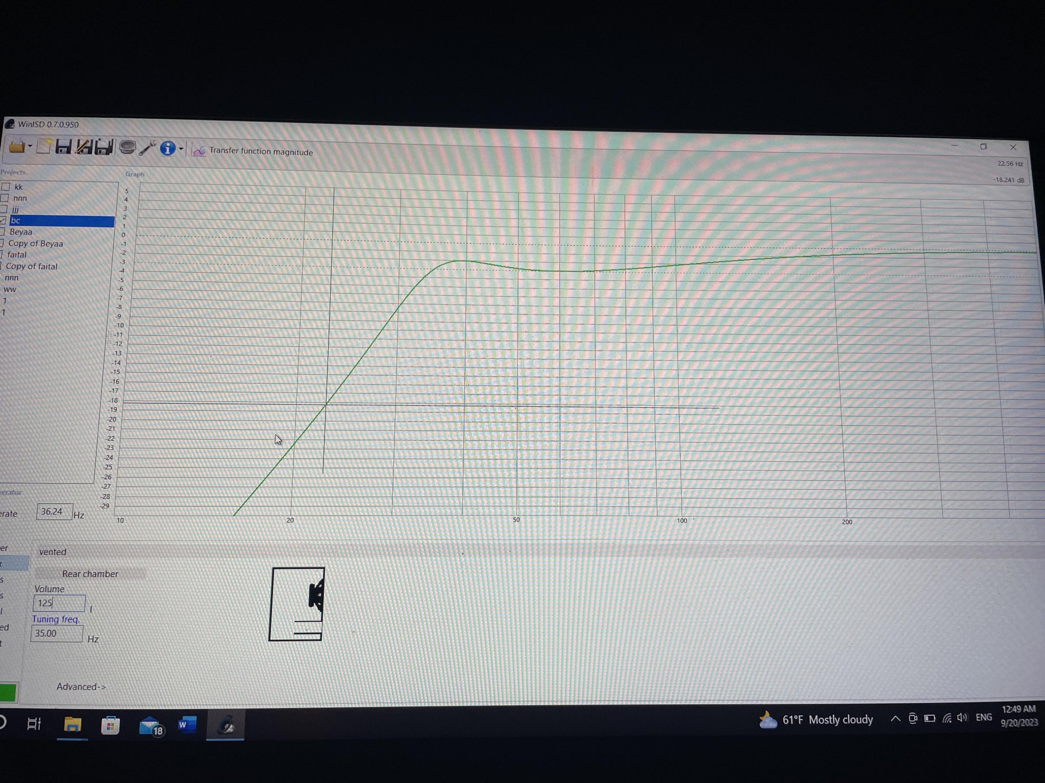

I was playing a little bit in WinISD, isnt that hard to understand it but I have a few question. In this design (i atached the Beyma 15LEX1000ND recommended enclosure) with is a "cross" at the end of the enclosure wall? Is it helping for a better sound or it s just reinforcement?
Also, when building the enclosure, is it matters the volume of the speaker? (to substract from the box volume) or the volume you need is just the enclosure volume without the speaker?

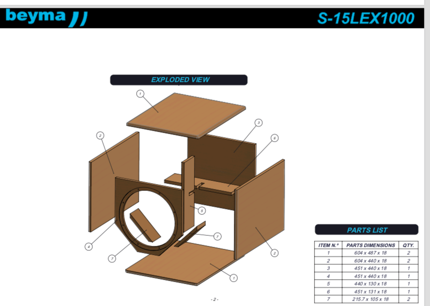

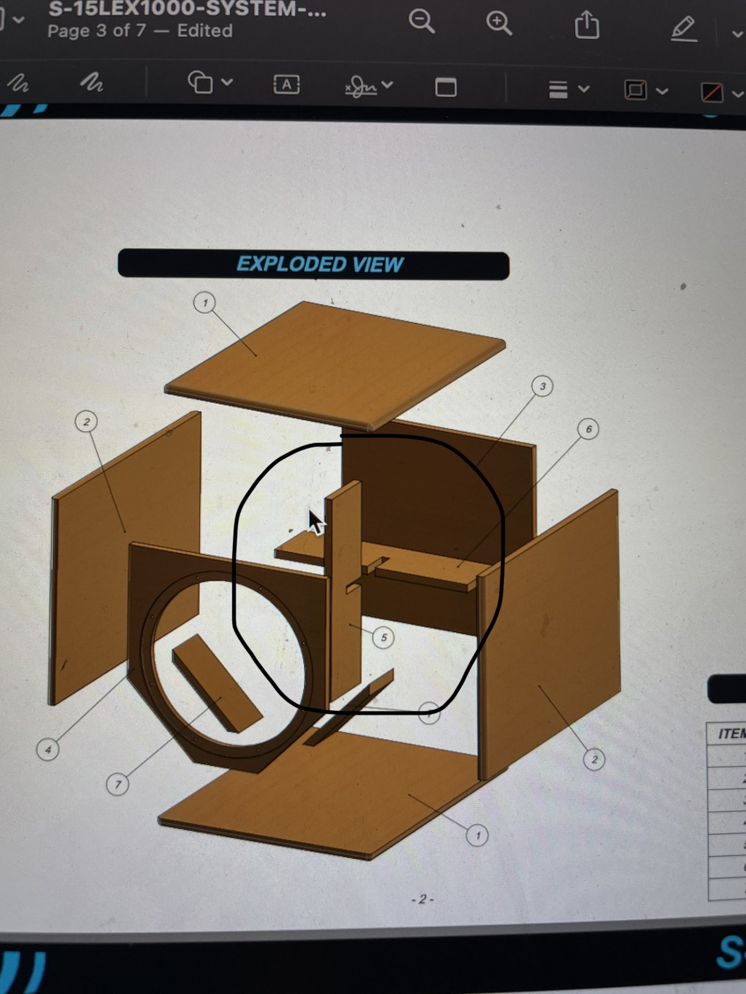

What do you think about this enclosure designed in WinIsd? On the second image is the cross i was talking about

The S-15LEX1000 inner reinforcement parts 5&6 cross are cabinet braces to stiffen the walls. Walls flexing reduces output.
If you use thinner plywood to reduce weight more bracing should be used. The braces can have triangular or circular holes to reduce weight.

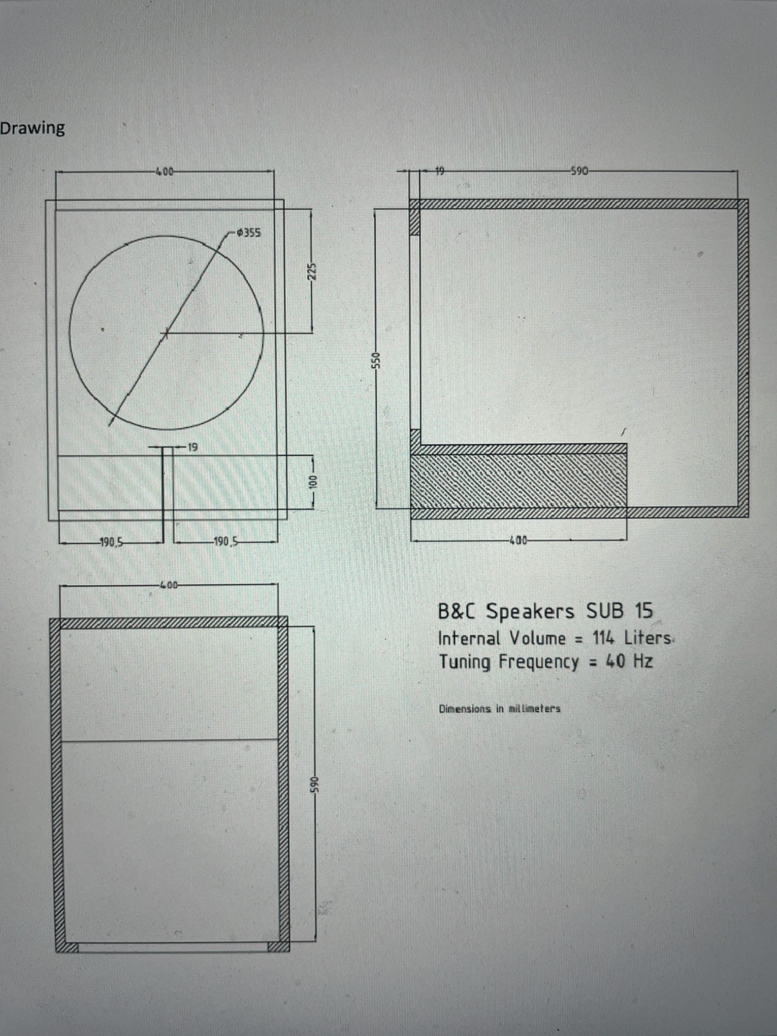

The rear chamber volume of the cabinet is reduced by the volume of the port vents, driver, and bracing.
The S-15LEX1000 rear chamber volume would be less than 125 liters, a .5 meter cube is 125 liters.
This cabinet probably has an Fb (box tuning frequency) of around 43Hz, if you want a lower frequency response ("at minimum 38Hz") the port length could be increased to lower Fb, but the cabinet will have less low frequency output.
WinIsd may not predict a triangular corner port Fb correctly.

Assuming using the factory recommendations, which I presume this cab does, then 115 - 0.968 = ~114 L tuned to 40 Hz, so with driver Vas = 113 L and 41 Hz Fs, it's basically a Vb = Vas, Fb = Fs T/S max flat alignment ergo won't have the broadband dip in your sim.
Great! Well within the driver's box loading ~222 Hz desired upper BW limit for a (sub) woofer.

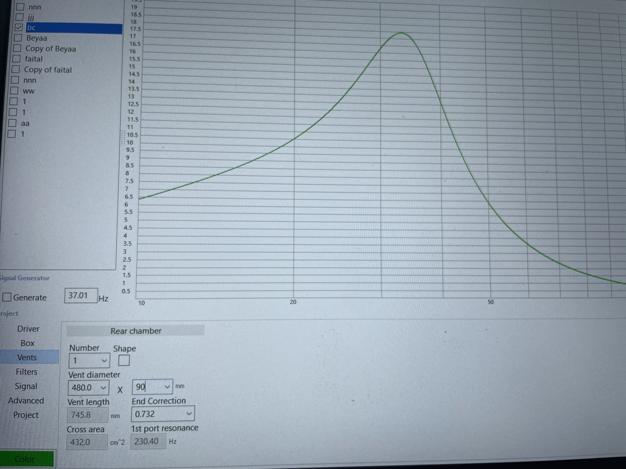

Thank you for all the info! I will build myself an enclosure to learn about it. Two more question:
1) I made a simple box with rectangular air vent volume=114L and Fb=35Hz. In order to get an air velocity < 18 I made the air vent as long as the box width (516mm - 36mm Plywood = 480mm) and the height 90mm but the problem is that I get the vent lenght too long (746mm), longer than the box itself that I imagined to be 600mm depth... How can I fix this? The design is similar to the first photo atached (Driver used B&C 15TBX100)

2) Normally you should have around the same length for the same area so you should just calculate a triangle with the same area (maybe there is a tiny change as for slot port vs round port so if someone can confirm that would be great).
1) Also i read you don't really need to keep the port air velocity below 18m/s for an high output speaker. 35m/s is the general maximum before port compression (no SPL gain above that) and you can avoid turbulence noise by a port flare (but then i don't know how the port length should change but i think is not that much). Anyway the turbulence noise shouldn't be a big an issue with a high SPL speaker (otherwise i think a ton of PA subwoofers on the market would have port velocity issues then).

Hi daniul,
Port tuning frequency is based on the length relative to the port's cross sectional area (and relative to the net box volume).
WinISD just calls this "Cross Area" at the bottom left of the vents tab.
So the way to do it would be to make the total cross area of your 4 triangles the same as the total cross area from WinISD.
In your example from a few posts up of a vent 48cm wide x 9 cm high, you'd have a cross area of 432cm2.
Each triangle therefore needs a cross area of 108cm2, which would result in using sides of 14.7cm (hypotenuse 20.8cm).

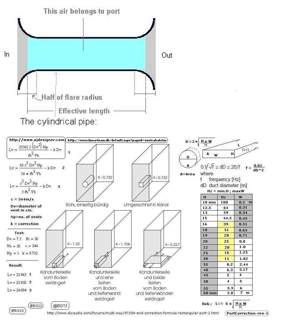

The length is likely to be shorter than WinISD predicts as 2 out of the 3 walls of the port are much longer than the other, so the math WinISD uses (which assumes the ports are well away from the cabinet walls) won't quite be right.
The image attached below shows how we can calculate a revised port length based on alternative values of end correction to account for this. Note though that I haven't built a cab based on these calculations to check how accurate they are - so it's probably best to build one test cab first to to check. It would be best to make at least one panel removable so you can get in and adjust port length as need be - either by cutting them shorter (hard if they're in the corners) or gluing in extra strips of wood at the back of each one to make them longer.

Winisd assumes ports have no shared walls
and uses common correction factor K=.732
and with flares assumes K= .850
If calculating triangle ports= 2 shared walls
or Slot ports =3 shared walls.
Winisd predicted length is too long.
Use a program like Virtuix Cad
were correction factor is adjustable.
post #13 is well known graph showing
accepted end correction for shared walls
2 walls K=1.728
3 walls K = 2.227
Once you find a driver WinIsd will give
you known alignments.
QB3, BB4 and your done.
