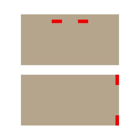

The room placement and hifi gear talk on boards seems to concentrate on solutions for one listening spot. I'm trying to find a solution for my workspace where I work on different locations of the space. So rather than planing the system for one listening spot I would like to have as nice sound as possible across the room.
I would like to build the cabinets myself. I have a pair of altec 416a drivers and 805b horns. I would like to use single ended low power tube amps for the amplification.
I have been thinking about onken cabinets but it concerns me a bit that would they take too much floorspace. Another one I just found is the bit rarer altec A8 that would seem better fit since its so narrow and is designed to sit close to the wall. Any ideas on what cabinets would you choose?
The room size is 460cm (15ft) x 888cm (29ft)
The possible placements are basicly these? Most seem to think that placing the speakers into the corner is a bad idea, but I red an article where someone stated that if they are placed on corners it fills the whole room with sound instead of just one sweet spot? Any thoughts about this?

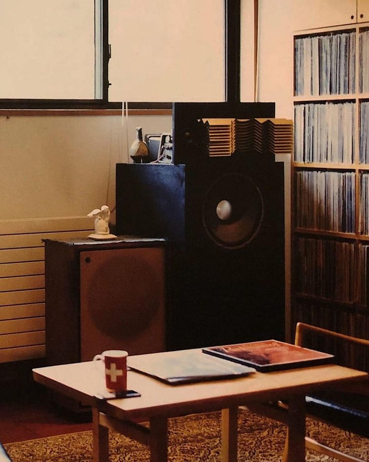

I love this image of Murakamis workspace. He doesn't seem to mind having the speakers in the corners...

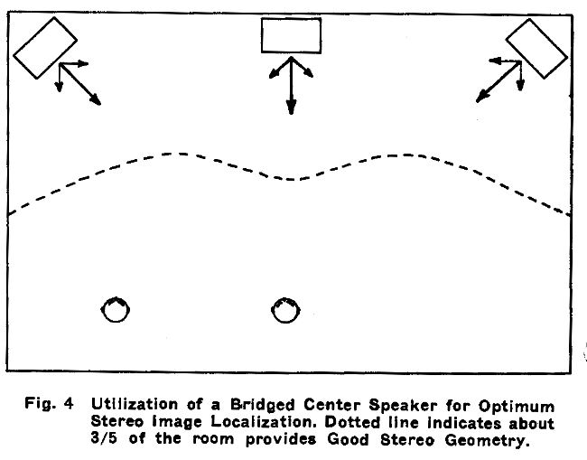

Tow-in the loudspeakers to at least the center of the room at the prime listening position, then simply EQ the midbass down (i.e., 100-200 Hz) back to flat on axis response. If you "over-rotate" the Altec corner loudspeakers such that their centerlines cross in front of listeners, you can effectively make the sensitivity of listener position for stereo imaging better.
To achieve what you really are asking, I think the solution is three-channel stereo, which locks-in the center stereo image wherever you are located, albeit if you are far enough away from the loudspeakers for any phase misalignments of their loudspeaker drivers to coalesce into a single image.
The better you time/phase align your loudspeakers, the closer you can be to them and still hear a single coalesced soundstage image.

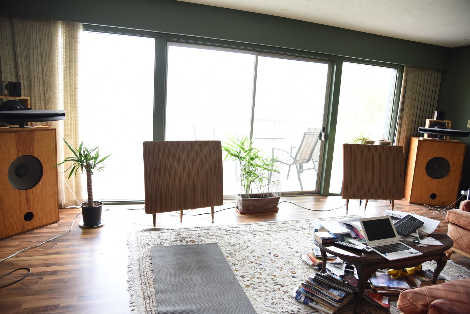

My main speakers are in a room that is 23 feet wide (the longest dimension), and the speakers are in the corners. I, too, wanted a setup where I'm not confined to listening from a small sweet spot.
I have JBL 2397 horns crossed over at about 800 Hz in combination with JBL 2225 woofers in 9 cubic feet bass reflex boxes. The boxes are tuned to Extended Bass Shelf response (EBS) and the room corners provide some low bass gain. I have bass down to mid 20 Hz range.
I like the sensation of feeling like I'm in a live music venue, and this setup provides that. Forget about imaging; it just feels like I'm there. I enjoy the music anywhere in the room, which the dining area and kitchen are part of. So, what you are looking for is possible.
Thanks, this seems actually like a great solution. Did you try the same setup, but with speakers on the shortwall?
No. This room is the main area of my house and it is not a simple rectangle due to other features. There are also openings, fireplace, dining area, stairway down, and kitchen. The effective floor plan is more "L" shaped with the speakers along the long leg of the L.
As I said before, this configuration fills the room with sound and I forget about the speakers. I can sit on my couch which is about 10 feet from the wall the speakers are located at and enjoy the music as well.
