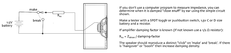

Insulation for stuffing, lots of it
And if that is not enuff a hole with lots of stuffing until aperiodic. Tune for flattest impedance.
dave

'Best' depends on the needs of the app, so for HIFI my preference using just published specs would be ~ 20*8.2*0.74^3.3) = ~ 60.72 L vented TLs (MLTL/MLTQWT) tuned to ~ (0.42*68*0.74^-0.96) = ~38 Hz and stuffed to 'taste'* by using the above 'click' test or at least as a baseline if not happy with it for whatever reason.
* the driver/box combo only loads to its upper mass corner (Fhm) = 2*68/0.74 = ~184 Hz, but the XO point is way up at 2.5 kHz, so in trying to get a well damped 'in situ' bass response without over damping the 300 - 2 kHz critical mids can be a tedious, time consuming affair if room treatment isn't used.

Myself, would probably just use an average sized box, can do as Dave mentioned and make a tuneable panel or something similar where you have a series of 3/8” holes to use as a vent. Those holes would be in two 1/4” panels of plywood, using insulation compressed between them.
That will give you a controlled leak to help get the optimum response. And also use a lot of insulation inside the box also. What I mean by that is an amount that makes you wonder how any air can get around inside.
