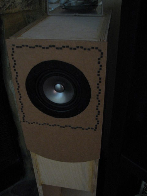

Hmmm...i think it works. This is purely an experiment on my part so I used no formulas...the "dashes" are from 1/16" thick self stick damping sheet. Spacing is similar to the op.
What I hear is more "distinct" sounds from the instruments and voices...but perhaps a loss in smoothness overall. This may be a result of the material thickness...not certain.
Fire Away!

G'day scaleautoart,
Nothing wrong with the materials choice, but the pattern size, spacing and location are not right. The pattern is critical.
You might like to download the calculator in my signature. Happy to help with advice.
Alex
Thanks,
I figured it was a shot in the dark. I will try the calculator for my next effort.
Would using a circular pattern around the driver [on the baffle] work. I have some of the Planet10 templates.
A circular pattern needs to be placed rather precisely. I would suggest continuing with your current experiment until you have exhausted the possibilities. Those to include correct size, placement and row spacing. Placement on the outer periphery of the front plate. Placement as directed by Alex on the other 5 sides of the box and use of a thinner material, just to experiment with levels of subtle change available. Again, using a peel a stick adhesive is best and I have found clear acrylic kitchen cabinet shelf protective film, of 0.003" thickness to be adequate and virtually invisible.
Bud
