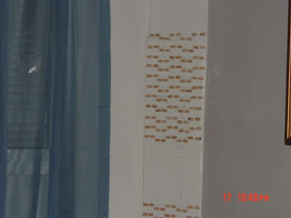

I guess it is only a question of time before somebody will apply the dotted patterns to furniture and other interior objects.

You might be funning with me, of course, but clearly the poorly worded quoted phrase could be misconstrued. I meant the baffle in which the driver is mounted (could of course be an open baffle), and the other (adjoining) surfaces of the speaker enclosure itself.
Possibly to everyone's horror, here is a room treatment begun by a man possessed. Not me either, he is of Fostex F200 A fame, from the split EnABL threads. Perhaps we can someday get him to voice his opinions on the benefit or lack thereof. Not the only surfaces he is working on either.....

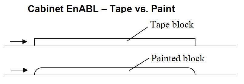

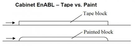

G'day chrisb,
I agree with you that the more benign the diffraction signature is to begin with, the less dramatic the change when compared with say a rectangular flat baffle.
Your description of the effect is based on experience with the painted pattern on Fonken designs only.
However, Bud has applied the painted pattern to many different cabinet designs and yet he describes the effect as "subtle".
soundsinthestix used tape and found the results to be a "very noticeable difference" - which concurs with my experience.
An interesting thought - tape blocks would have a squarer edge, whereas painted ones (applied using a calligraphy pen) would be more like a roundover. See pic.

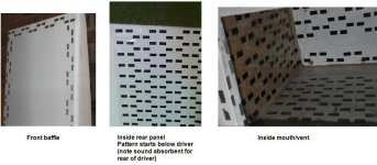

G'day Bud,
That looks like the pattern inside my Voigt pipes. 🙂
I'll try and get some pics later today or tomorrow.
