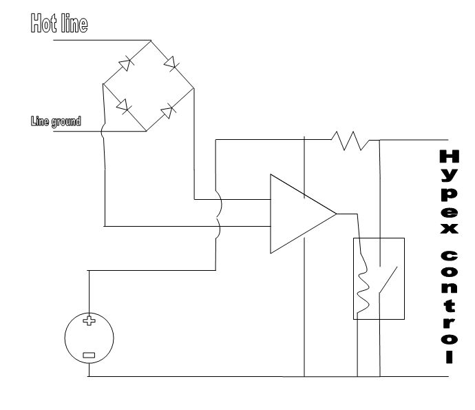

Does the following circuit ouline makes any sense (sorry, I’m a total novice).
The source voltage could be 12 V dc if there is an opamp which can work with it.
A few questions (if the first step, does it make sense, is passed) :
-are there opamps which present a sufficiently high impedance to the line in ?
-which kind of delayed relay should I look for (my badly drawn box on the right part)
-how can I be sure the line noise will not trigger the thing ?
-what kind of resistence I should put (needed because otherwise shortcut when signal)

You're close, but the refinements needed to make it work take you the Rod Elliot circuit you linked to. Issues are undefined off state of comparator, comparator can't deliver the current needed to drive a relay.

Do you know how much current the module needs to be driven into standby? You might be able to drive the standby pin directly from a comparator, if you make it go high when no audio is present. You'd want to add a bit of delay to hold it on and prevent amp cycling during quiet moments. Although if the ESP circuit scares you we probably shouldn't be talking about morphing it into something else.
The issue with the comparator driving a relay directly in this circuit is twofold. One, a typical NE5532 can deliver ~35 mA but the output current could be as low as 10 mA. That may not be enough to reliably switch your relay. Secondly, without D1, C4, R11 in the ESP circuit the relay would cycle when the signal drops below a certain threshold.

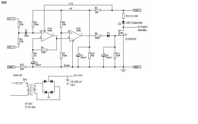

I can't see it being simplified and working the way you want. U1A and surrounding parts amplify the signal so that it is high enough to operate U1B's comparator even at low levels. The comparator is the switch. When it goes high, it charges C4 and turns on the mosfet to trigger the relay. C4 and R11 form a hold on delay so that the relay stays tripped when the signal falls below the threshold for a moment. Without it the relay would operate with every cycle of the signal. D1 prevents C4 from discharging through U1B when its output is low.

Note that the OP has stated a limited knowledge of electronics. We're not going to help him much with verbal circuit descriptions. If there is a dual voltage supply available for the opamp, Andy's concept would work fine. If you only have a single rail, the ESP circuit is about as simple as you can find ready to go. D1 is the rectifier, C4 and R11 form the integrator Andy mentioned.
Realistically, you don't need a relay, just replace the relay with a 10K resistor and use a ZVN3310 for Q1.Connect the Hypex PSU standby pin to the junction of the resistor and Q1. When C4 is charged Q1 turns on and pulls the output voltage to almost 0.

Here's Rod's circuit modified as I suggested for relay free operation. The optional LED can be any color. It will be on when the circuit pulls the signal to ground. The value of R12 determines the brightness of the LED It can go down to 1K with 1/4W resistors to get 10 mA in a red LED. If you don't want an LED, just connect the resistor to Q1. Hypex doesn't specify the current to be supplied to the standby pin, but I assume it is less than 1 mA.
The LED current will be approximately (12-Vled)/R12. Power in R12 is the current multiplied by 12-Vled. If you get a dissipation over .125W, use a 1/2W resistor for R12. Vled is roughly 1.2V for red, 2V for green and 5V for blue.
I also added a psu - all diodes are 1n4007 or you can use a ready made 1A bridge.

Thanks to all of you, I'm getting slowly the picture, eg the C4-R11 part is simply the delay via a discharging RC circuit; in my naive implementation I had assumed off-the-shelf delayed relays exist, incorporating part of the circuit.

If you use the LED you can see that the circuit operates as intended before hooking up to your PSU (suggestion use a red LED and 1-2K for R12). All resistors can be 1/4 watt, cheapest industrial grade. Any dual opamp will do. NE5532, TL072, 1448, whatever is cheapest. The diodes can be 1n400x including D1. I buy 1n4007 in large quantities and use them all over the place, but any of the series will do. The electrolytic caps can be anything rated for at least 16V. If you want your amp to stay on longer after the circuit detects silence, add more 100 uf caps in parallel with C4. Each one will approximately double the time it takes to turn off. The smallest 9VAC transformer is god enough. Bigger won't hurt, except in your wallet. None of the parts are critical, and Rod chose standard values so they should be easy to find. Try Farnell.
