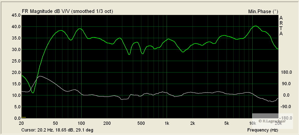

No one mentions the use of phase in thier results, I find it very useful in fine tuning the XO point As you can see in my monitor-xl topic, I plotted the minimum phase a abrupt change in phase is equal to distortion.
So when you got distortion you got abrupt phase shifts.
Here i measure the two way near field to discriminate other influences. And the microphone between the woofer and horn this to have the same travel distance you see a smooth minimum phase bleuline.

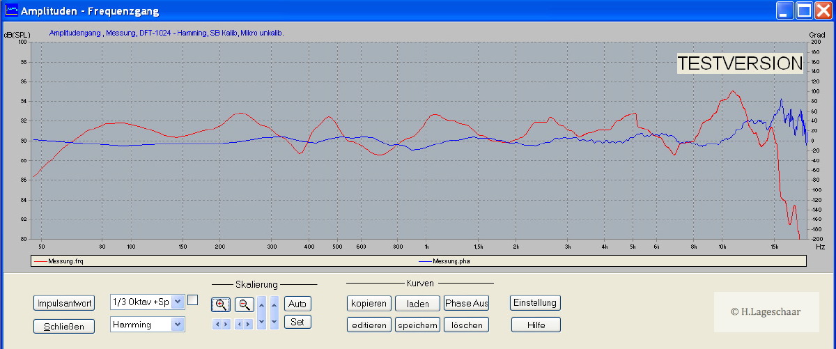

Here both speakers on mls signal microphone on my listining position so room reflections take place still a very smooth minimum phase 100-10000Hz.
It is a shame people can read the plots I show there then they would know how great it measures. You have to done some measurements and see result before you can compare what I show there.
