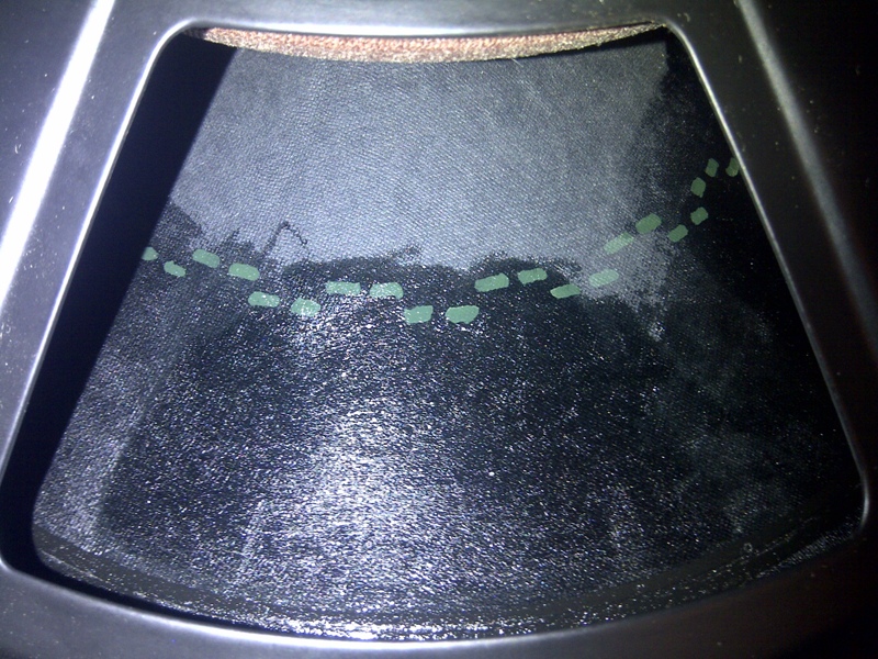

I have finally got around to doing proper treatment of the Audio Nirvana 10" cast frame drivers. Gradually, I have applied the following:
CONE FRONT SIDE:
1) Three rings of EnABL patterns after doing the tap analysis
2) Two coatings with Microgloss included in Ed Lafontaine's Kit (cut 1:3 with water)
CONE BACK SIDE:
1) One ring of EnABL blocks just opposite the one of the middle ring of the front side (around 4 cm from surround)
2) One coating with Kuretake Zig-Zag 2-way glue from the EnABL ring pattern to the outer edge of the cone including surround
3) One coating with Kuretake Zig-Zag 2-way glue of the entire surface of the cone, excluding surround
WHIZZER FRONT SIDE:
1) Two rings of EnABL patterns
WHIZZER BACK SIDE:
1) One coating with Kuretake Zig-Zag 2-way glue
RESULTS SO FAR:
1) Subjectively, the level of microdetail improved (with lower noise floor).
2) "Dissapearance" of the speakers improved quite a bit - the sound sticks to the drivers much less than before.
3) The sound is much less directional (less beaming)
QUESTIONS for the more EnABLE savvy members:
1) Even though the speakers now disappear much better than before, there remains a bit of stickiness of the sound to the drivers. Would you risk applying Microglass (cut 1:3 with water) on the back side of the cone over the single/double 2-way glue coating? Might this kill some of the previously gained benefits?
2) Would you recommend applying Microgloss over the 2-way glue on the back side of the whizzer?
Thank you for your thoughts and all the wonderful tips in the several EnABL treatments threads.

1) Even though the speakers now disappear much better than before, there remains a bit of stickiness of the sound to the drivers. Would you risk applying Microgloss (cut 1:3 with water) on the back side of the cone over the single/double 2-way glue coating? Might this kill some of the previously gained benefits?
You can apply the Gloss to the back side of a driver. What you risk is getting a very edgy sound. Applying gloss over the outer glue coat section, but not on the surround is probably a good idea, though I think I would drop the mix to about 1 part in 10 of water. You want the surface to be just barely tacky back there. If you apply another ring set up near the voice coil on the back you can gloss the whole thing. You will gain more transparency but the cabinetry and basket reflections are going to come right back through the cone.
Only under the brim portion of the whizzer. It is ok to have it slip down the cone portion a tiny bit, but not much. Best to take a fine detail camel hair brush and bend the ferrule holding the brush hair to about a 30 degree angle. This will allow you to paint the underside of the whizzer "hat brim" without making a mess of the job.
Did you apply a pattern out on the metal bezel of the basket? This will help a bit with the directionality. The way to think about it is that each of the trailing edges of radiating and mounting surfaces, resonance nodes and subduction zones causes a loop back to the center of the driver. The dispersal of each of them allows the sound coming from the central piston of the voice coil to radiate through a wider arc. Some of the loop back mechanisms on the cone do not make it back to the voice coil, instead looping back to the next resonance node. The more of these you disperse the more coherent will be the final sound and you will hear deeper into the signal.
They are not actually dropping the "noise floor". Instead they are allowing the driver to do what it theoretically should be doing, if all of the resonance nodes were properly eliminated. The perfect signal that the device should be emitting is being disturbed in a number of ways by the loop back resonance nodes, subduction edges and attendant Raleigh waves and the reemergence zone just before the surround, in those cones that have a subduction.
The whizzer likely needs a third ring about 1/3 of the way down from the top. A subtle change should be observable with light tap test. Also check the cone area between the ring set under the whizzer , at about the whizzer diameter and the beginning of the subduction zone to see if another ring is needed between them.

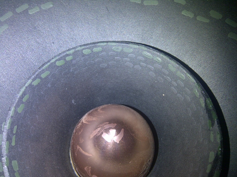

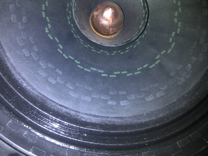

Two busy weeks later, I have a follow-up to my Audio Nirvana EnABL adventure story for those still interested (summary of previous EnABL steps performed on my AN 10" cast frame are given above in post #24). So here goes the list of further modifications performed:
CONE BACK SIDE:
- application of Microgloss (roughly 1 part Microgloss and 10 parts of water) between the middle ring and the surround
WHIZZER BACK SIDE:
- Microgloss applied only under the brim portion of the whizzer (as advised by Bud)
WHIZEER FRONT SIDE:
- Third (middle) ring of EnABL patterns applied where tap analysis showed changes in the direction of the tap sound decay
- Microgloss applied from the subduction zone to the first ring of EnABL patterns
BEZEL OF THE DRIVER:
- Dynamat type of material applied along the circumference of the driver magnet bezel.
- Additional ring of EnABL patterns of the same material applied on the basket of the driver
The whole driver was then braced with a piece of bamboo wood firmly pressing on the back of the driver.
IMPRESSIONS OF SOUND:
- Finally I was getting the feeling of "scary presence" of musicians from these drivers/speakers, but only at times and only with certain recordings (I guess that is to be expected).
- Finally I was able to escape from the "audiophile" attention to lows/mids/highs and other technical qualities and start feeling/seeing the music itself.
- Because the speakers (back-loaded horns EZ10 design) are still with the side panels unscrewed, their disappearing quality cannot be judged fully yet but they already approach the disappearing act of my other EnABL-ed speakers (Fostex FE127eN enabled by Dave, put in Metronome cabinets).

So I cut up 1cm x 2cm blocks of Dynamat-type material and applied them along the outer edge of the inside of the front speaker panel. Then I applied one ring of EnABL patterns of the same material around the cut-out for the driver. After doing this, I had a feeling the speakers lost a bit of their liveliness and became a bit too dry (still open on the sides though).
For EnABLing cabinets, sound absorbing materials are not ideal.
PVC duct tape, contact paper or similar materials will give you the desired effect without sucking the liveliness from the sound.
EnABL around the outer edge on the front of the baffle is a great place to start.

Hi Alex, I calculated the size of the blocks so that I have 24 pairs of blocks (in the usual arrangement) along the outer edge. I am all for experiments (as one could tell from descriptions above) so I am going to try PVC duct tape also.

You will not need to keep duct tape there. If you go looking in women's craft shops I suspect you will find a clear, flexible 0.003 inch thick acrylic plastic sheet that is normally used to line the bottoms of pantry shelves. This material has a stick and peal adhesive and once it is applied to a surface is invisible from a meter away, but it is easily removed, won't curl and lift on it's own and does not leave a stain of any kind.
I do think you may want to rethink the number of blocks you intend to use. Fewer than 36 block sets has a tendency to affect high frequency propagation across surfaces. Substantially more than 36 block sets also affects the same frequencies. It does appear to be a phase angle that is altered, drooping with fewer and advancing with more. I thought you should be aware of this.

Turned out pretty good I must say 🙂
Even without the EnABL pattern, the sound is marginally better right now, so it seems I have gotten the right amount of PVA on the cones, no real loss of higher frequencies...
Next will be the outer twin ring pattern... and then onto the tap test...

So, here's how my drivers look now, I have done all the main cones rings based on my interpretation of the tap analysis, which i think is less than perfect.
Judging by the number of extra rings I have put, I wondered what would happen if too many rings were drawn.... hmmm... Bud?
I've also applied the pattern on the back side, as well as the zig two way glue.
Next on the list:
- Final pattern on the whizzer cone (should be around halfway down on the front side.
- microgloss on both the main cone and whizzer, but i need to know where to put them, or at least what the rationale behind it is so i can judge where best to apply.
- Zig two way glue on the whizzer, same need to figure out where to apply it.
You'll notice that i've used two different paint types for the patterns as i found i had a small pot of tamiya flat green paint that seemed to have a higher solids content than the paint supplied with the kit, so i went with it. fingers crossed 🙂
