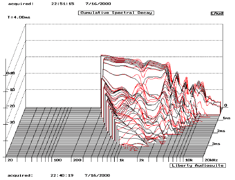

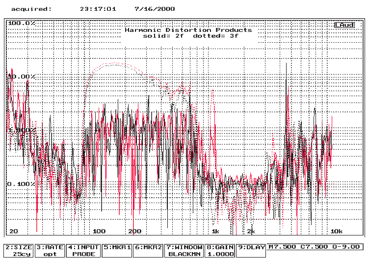

dlr,
Here are some more distortion plots. This and a number of follow on PDF's (due to size constraints for posting documents) show a Vifa 5 inch mid/bass driver from the same time period. A waterfall is included, but I think LAUD from that era used something other than a pulse for signal. I will have to dig to find the instruction manual, but this was from the DOS based test suite.
Again, every bit as uninformative as to what was causing the distinctly audible change, as the previous, abbreviated tests I posted. I suspect you can begin to see where my distress was coming from, when we first wrangled about the usefulness of piston model based tests.
I do believe there are more squirreled away, but so far the computer they are on is unresponsive. It's only been turned off for 6 years now, so, like, what's the problem, huh? I don't think any of those tests are any more informative. This is not to say that more modern test suite's cannot find a difference. Just that, as I said earlier, my experience has been an unsuccessful one.
Bud
Bud

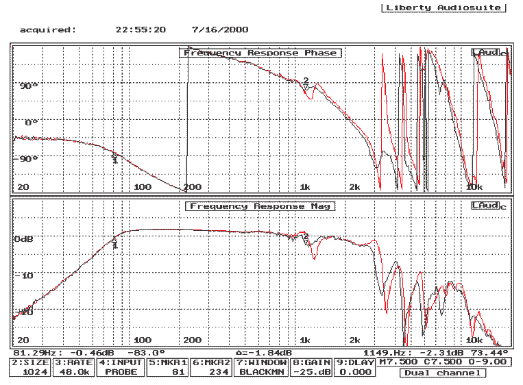

And the second set of curves is the treated driver, as it was in the first set of tests. This is true of every page of the PDF.
Bud
Bud
Nice work on the overlays David. On 1st look raises some questions - but then one of the key overall questions is are we looking in the right place with the right tools? Nah- let's not go around the block on that one - again.

BudP said:dlr,
Bud
Really? Uninformative? You are correct in that the data doesn't support an esoteric theory of damping standing waves, or altering the launch of an acoustic wave from the driver, or that standing waves in the cone are damped. However, they do clearly show the resonances associated with the excitation of cone modes and the resulting standing waves . And clearly show differences, audible differences, which are consistent with added mass changing the resonant modes of the cone.
I'm looking at the overlaid measurements posted by Planet10. These plots of amplitude and phase, and the CSD sure slow that the difference in FR response is very obvious and pronounced at higher frequencies where the drive is in bending wave mode or radiation. Everything here is consistent with the cause-effect relationship being one of added mass. I would also say, based on this data, it would be difficult to consider the red response as an improvement. The response is clearly degradated in the 1K Hz - 1.5k Hz region with what would be a audible notch at about 1.3k Hz. The behavior of the driver above 3k Hz indicates that this is not a full range driver but still what is observed is a shift in the resonance frequencies associated with cone breakup along with changes in Q of the resonances. The phase changes are what would be expected assuming minimum phase. We see little change in phase in regions where there is no significant change in response with the phase collapsing back similar behavior where the response is more of less unaltered. The CSD plots are what would be expected as well. You will notice that the null at 1.3k Hz in the treated driver (red) shows extended decay time of a resonance in that I would expect would be in the pass band for a system using this driver. Other than that, at higher frequencies there are expected differences, but nothing indicating significant improvement or further degradation of the response. All that can be concluded above 2k is that it's different. If this was a full range driver with raised response above 3K Hz (more or less flat) the high frequency differences would be audible as a change in timbre. Subjectively that could be labeled anything. But given a decent crossover I doubt anything above 2 k would result in audible differences, good or bad, for this driver. Same with distortion. There is really nothing very conclusive here over most of the band other that that they are somewhat different. Regions of higher distortion remain higher distortion, and vise versa. The major exception is again at 1.3k Hz where there is the obvious and significant increase in distortion form a level of about 0.2% to 5%.
Everything seen here is consistent with the primary audible differences being a direct result of differences in frequency response, and secondary differences being the result of the degradation of the distortion in the 1.3k Hz region. All consistent with added mass resulting is changing the modal behavior of the cone.
This particular set of data should give one pause before applying the treatment. The evidence here clearly shows degradation of the driver response with respect to overall linearity, particularly in what would be considered the useful band pass. In other cases it could show an improvement. Of course, this is an objective observation assuming that deviation form linearity is bad. Subjectively these differences could be judged any way the listener likes. This is a clear example that if you are going to tweak you drivers, make sure the tweak can be undone.
Yes, it can be argue that the evidence isn't conclusive as to the source of the change, but it is consistent with added mass, thus supportive of that prepossession, and suggest that before other more esoteric explanations are offered this prepossession should be investigated. As you know, all things considered, the simplest explanation tends to be the correct one. Or as Judge Judy says, "If it doesn't make sense it's probably not true."
The problem I see is that you seem to claim that the audible change due to something that changes the way that the acoustic wave launched from the cones. This would require that you eliminate change in cove vibration as a source. That means you either have to A) demonstrate that the treated cone vibrates exactly as an untreated cone, or B) that the differences in response of the treated cone can not be accounted for by observed differences in the vibration of the cone. Since a treated cone does have added mass distributed in an inhomogeneous manner and which may also alter the damping and compliance of the cone, there can be no question that the cone will vibrate differently. So you won’t be able to show A. But then you are caught is a catch 22. Since if the cone vibrates differently any acoustic wave launched by the code will necessarily be different that that of an untreated cone. So all you can potentially show is that the differences observed in B can not all be accounted for by the differences in vibration. Assuming that is the case this still leaves you in the position that what is heard or measured is the result of two inseparable causes.
There are different ways to ask for more data. dlr uses the "challenge" method to learn something he cannot understand. I like to use questions in structured manner.Graham Maynard said:Hi Dave (dlr).
