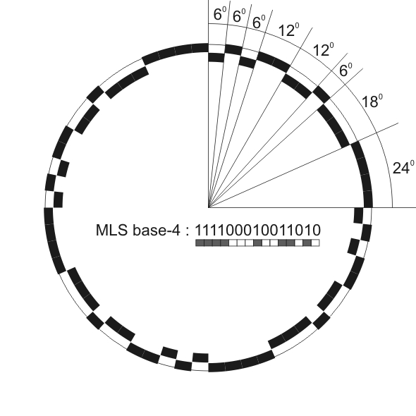

Hi Bud.
Thanks for sharing your treatment.
It works for me.
Yesterday I enabled a cheap speaker using your pattern.
Method and brand are not as you recommend, not as regulier as it would be, but, yes... it works.
Instruments are more separated, timbre is more correct and more dynamic.
An idea comes to me to use a pattern which have more random characteristic. That pattern is MLS (maximum length sequence).
So, I used base-4 MLS which give me 111100010011010 (1=6degrees painted, 0=6degrees non painted).
Your pattern looks like 1101100000 (1=2degrees painted, 0=2degrees non painted).
To my ear, on that cheap nude speaker, MLS is better than yours.
Especially on violin.
I was really surprised, how a poor nude speaker can sound like that.
Now, I'll try to find my time to treat my Fostex properly.
Again, thank you Bud.
Atok
PS: There is another pseudo random sequence known as Baker Codes.

Atok,
Hmmmm, now that is very interesting. I have a dozen inexpensive 5X7 oval drivers with whizzers I now intend to use to explore just what you are describing, along with some other ideas that have occurred due to being carefully questioned by a number of folks.
Because I am ignorant of the MLS pattern, or randomness, is there a simple and direct derivation, as that fragment you have shown, that will describe how it works out for a circle? Or am I misunderstanding and the sequence you have given is a simple repetition for a sector?
I will try to figure these out, both the MLS and Baker Codes, but any simple format you can point me to would be helpful.
I have always assumed that my scratchings on the surface of this knowledge would be quickly surpassed by folks with better brains and superior tools for analysis, once I convinced enough of those folks to take a hard look at these issues I am raising. I welcome your help and explorations.
Bud

Atok,
Delicious. I will apply it to two of the 5X7 drivers on cone and whizzer.
Thank you.
Bud
