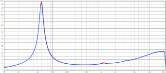

ronc said:
First obseration, there appears to be a very heavy black coating OVER the dots.
The black is under the dots.
When these drivers were started they were simply a gift to Ron in recognition for what he has given the community,
Iit was indicated that the best colour for the cones should be black to match the cabinets (SO consideration). In a normal case this coating would have been clear... it is in fact 2 thin coats of mod podge. On top of that planet10-hifi treatment are the EnABL spots (in a dark grey yo get as close to stealth as i am comfortable with). On top of the EnABL and he entire cone are 3 coats of 50% gloss, each one dimininshing in quantity.
This is the standard treatment i do, the mod podge/pva intended to deal with some of the FR anomolies inherent in a typical Fostex cone before EnABL since Enable does little if nothing to deal with these.
No pre-mod data on this pair was taken (the mod process had already started on these before i obtained ownership, so no pre mod data was obtained), and i can't find the post mod data. (i do know how it could be hidden from me, and if that is the case finding it could be difficult)
Attached is impedance of a pair of earlier FE166e -- the treatment on these is a heavier handed version of the current pretreatment, but since i do not test in a climate controlled room the 5-day separation in measures makes the error bars larger,
I am currently starting on a set of 166 that will get the same treatment as Ron's drivers and they will be documented more thoroughly.

Graham Maynard said:
Hi John.
Yes. We read you before. You obliged us to !
That is an interesting simulation you show, but what are such response curves supposed to prove ?
Loudspeakers can have similar 'measured responses' and yet sound so very different !
It does however show a typical *circular* driver peak at approx 3.5kHz - where does that come from ?
Raised dust-cap affecting wave radiation?
Are you simulating wave motion at a listening position ?
There are some differences between measured and simulated which look as if resonant too - air side resonances which are beyond simulation, and yet which would be seriously audible ?
Cheers ........ Graham.
This is a preliminary calculation of the sound radiated by a driver as computed using FEA. It comes form some preliminary work by the developer of SoundEasy. I do not know if or when it might be available. In essence it is composed of two parts: One part is that associated with simulation the vibration of the cone, surround, dust cove, voice coil. That is, simulation of the generation and propagation of transverse waves in the cone and surround. The second part is that associated with the transfer of this vibrational energy from the cone to the air in contact with the radiating surfaces. The measurement is for a driver in a box. The simulation is for the driver radiating into free space. The simulation does not include such effects as cabinet diffraction, etc. It is as if the radiated response is void of all diffraction and other external effects. Thus it reflects the components of the SPL arising directly from the vibration of the cone/surround/dust cover at a pre-specified point in space, in this case 1M, on axis, as was used for the measurement. Obviously there will be differences between simulated and real world results. However, if this type analysis were extended to the application of enable treatment it would provide a direct means of simulating the difference in the behavior of transverse wave in the cone due to application of the treatment. This is real world modeling. Done correctly it would show quantitative and qualitative differences in the results uncontaminated by external influences.
I believe that a much simpler model could be used to first investigate the behavior of a transverse wave when it encounters an enable patch. That is really the crux of the problem and where to start to gain understanding of what enable might to. How it effects the cone vibration over the entire surface and the resulting radiated SPL is far more than is currently needed.
