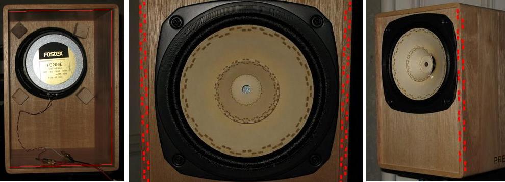

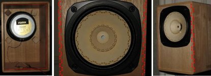

OK - there's no room on the baffle for EnABL round the driver bit - the driver goes too close to the edge, but I could EnABL round the outside. Do you think that would be as effective?
However, I know the sound of these speakers now, I've listened to them a LOT - and they would be easier to A/B because they don't weight 1 tonne each like the Sachikos will!
G'day Alan,
The bread box is probably not an ideal candidate for testing EnABL on the baffle given the tight space between the edge and driver.
Also it looks like the edge protrudes from the front of the baffle.
Here are some thoughts on what to try - see pic below:
1. EnABL inside the box where the red line is.
I have not tried this. But given that the box is open and you have no damping, based on my experience I would presume EnABL will make an audible difference.
2. Make the pattern small enough to fit on the narrow edge.
I have tried this on some old speakers - but the edge protrudes about half an inch from the baffle.
I can hear a slight difference but nothing close to the obvious change you get with a flat baffle.
3. EnABL one row on front baffle with one block space from corner, the second row on the outside with no block space from the corner).
I haven't tried this approach...just a hunch after thinking about your idea of putting EnABL around the outside of the baffle.
Alex
