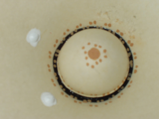

Hello,
I will apply the EnABL pattern this weekend to FE127E and looking at the pictures I found that there are 3 ring sets in the center according to this pict: (I'm not referring to the middle dustcap spots).
There is one set in the main cone dustcap border, one set in the dustcap itself and one set in between them (in the black glue).
Should them be done during the first pattern work? It seems that they are alternating, that's correct?

What you are looking at is a condensed set of rings. On these drivers, the glue is not always filled up to the cone break from VC attachment out into cone radiating surface. When that glue bead is missing you would have two complete ring sets, one on the dome base and one on the cone beginning. With the glue bead as full as it is in the picture you can put one ring on the glue and then use it as a common beginning for two rings, as shown, on the dome and the cone. In reality, for a three ring set, you should put a single ring up on either the cone or dome and offset the other two rings, as you place them on glue joint and adjacent surface.
The spots are there to eliminate the zone where transient standing waves, that arise and distort what would otherwise be a perfect flat compression wave as it arises from the cone / dome surface.
You do want to look at the pics again, there is another ring on the cone, just a bit bigger than the condensed rings and then the final ring, out on the edge near the surround.
Picasa Web Albums - Bud - Fostex 126 tr...
And, there is a mid dome ring too, one we added to the pattern sheet after the pictures were taken. I have attached that pattern sheet below.
As far as EnABL is concerned the 126 and 127 are identical drivers and both will benefit from the mid dome pattern ring set.
Bud

That is a picture of an early FE127eN. Since then construction has changed and i am using a ring pair on either side of the black glue/gunck. I will try to post a picture later.
