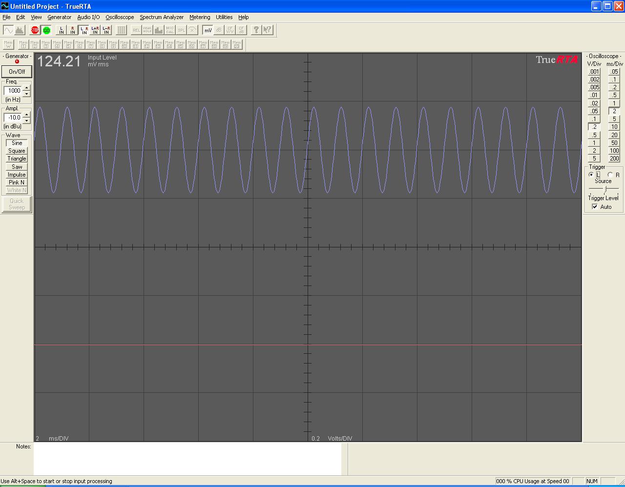

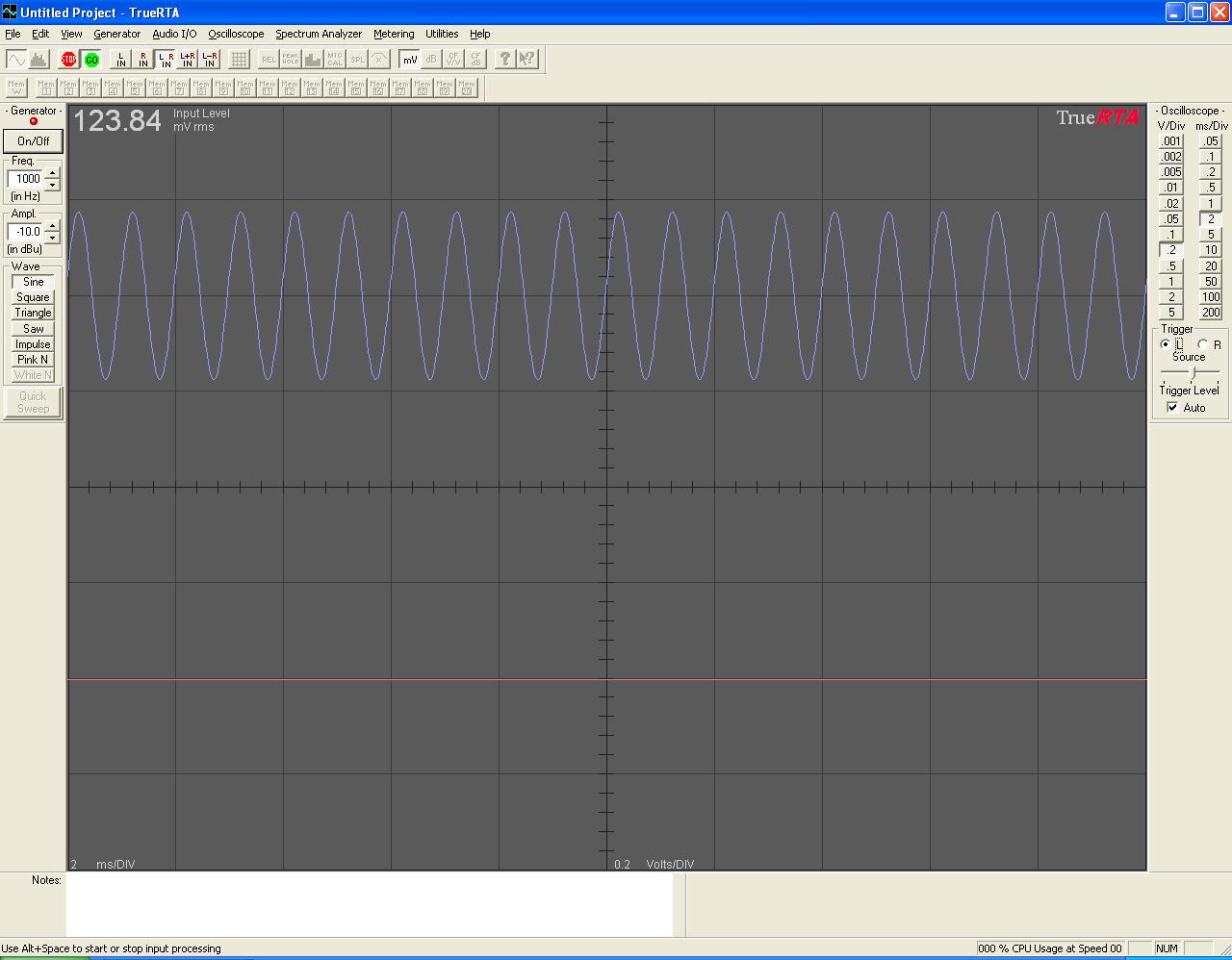

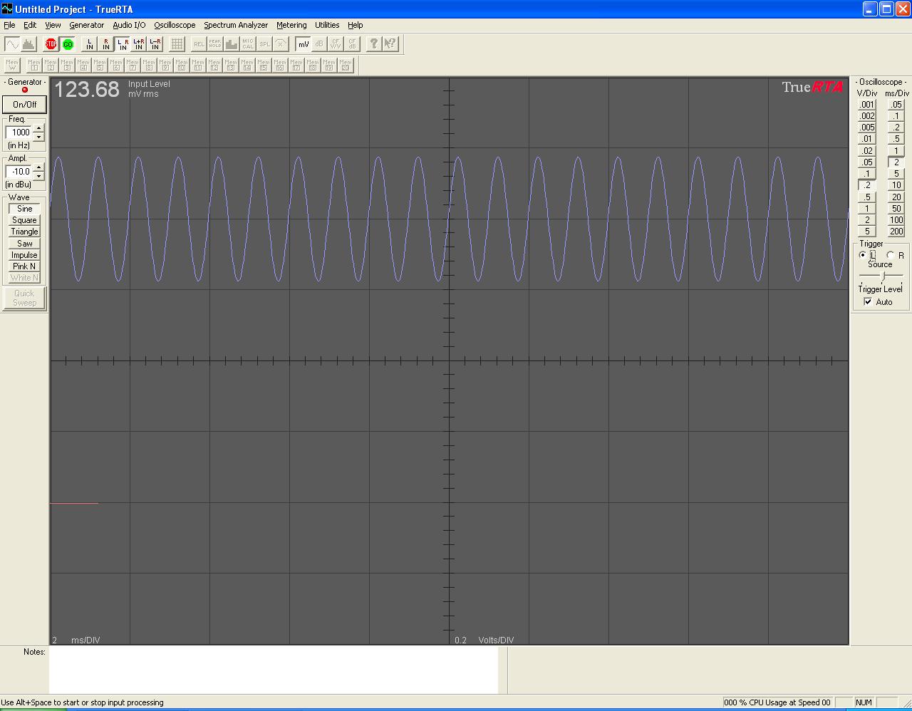

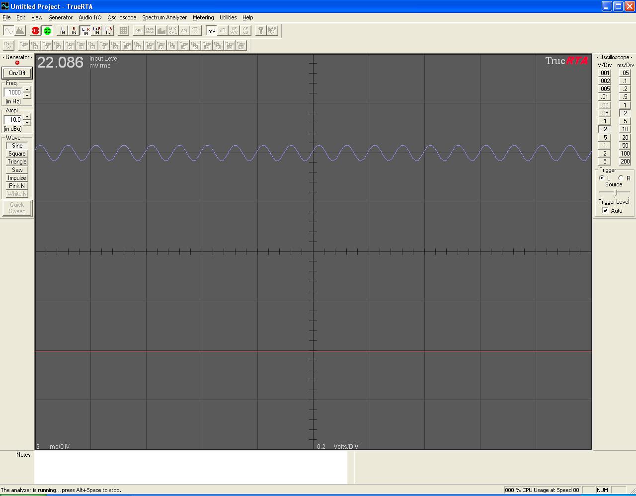

OK, I hope I made it all good.
First, left and right INPUT channels do not have same specifications, so I repeated and continued measurements on the LEFT input (so images on previous page do not relate to these images here).
Im not sure how to measure Input Level. There is some Input Level on the screenshots, but Im not sure if that is it. Measuring with Voltmeter on the connectors, all are around 0mV except the problematic one that is about 23mV.
The only think I couldn't measure is with half-way pulled connector.
What now, please?
1 Unproblematic channel
2 Problematic channel
3 Unproblematic channel with T and S soldered with wire
4 Problematic channel with T and S soldered
5 Unproblematic channel with R and S soldered
6 Problematic with R and S soldered

Hello,
now if you are positive that image 4 is R and S connected, than positive side of your balanced signal has a problem. The only problem now is that any further work will require some better test equipment and some surgical skills. If you look at the circuit picture you posted, you will see two opamps JRC 2068 and four SMD transistors. What you would need to do is to trace backward path from connector for that problematic positive side of the signal. The best way of doing it is if you have the very same sine signal going on and than by using scope probe observe at what point you are loosing the full signal. The way how to do that in such a tight environment, is to attach small wires that you could hook your scope probe to. Without having schematic, my guess is that opamps are used to buffer/amplify signal and transistors are used for mute function. Obviously I could be very wrong since I have no knowledge of the circuit, but just my guess. At least the first thing you would need to do is to download data sheet for transistor and opamp.
I have to warn you that really without proper equipment any further work is almost impossible for you. Even if you find out what is the source of a problem, than you will need an smd workstation (hot air) to unsolder this opamp an example, without loosing any resistors or caps around it.
Maybe is better to take this to someone else who does have a appropriate equipment and ask for help. That way you will see how it is done and have your problem solved.
Best of luck

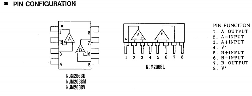

Hello,
This is what I did:
made a cable with 2 TRS connectors; wired R+S on one (output) connector with wire to a S on input connector; T from input connector wire, jumping to pins 1 and 7 on output opamps. During the measurement I did not replace the input/output channels: all was setup, the only thing that I moved between measurements is the 1 probe wire (between opamp pins). I am not sure if this is ok? Anyway, the results are exactly the same on both output opamps on both pins (1 and 7). All 4 screenshots are the same.
If the measurement is ok I would say the DAC and output opamps are ok?
This is what I did:

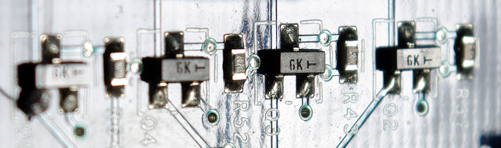

All that is written on top of transistors is "GK" with one letter "T" but "T" is rotated for 90degrees, so it looks like "GK |-"
Here, I found something similar: the dimensions of transistor are approx the same, but the pins are B, C and E, which I dont understand: DDTC114GKA-7 datasheet, DDTC114GKA-7 ?????, DDTC114GKA-7 ?????, pdf datenblatt - Diodes Incorporated - NPN PRE-BIASED SMALL SIGNAL SC-59 SURFACE MOUNT TRANSISTOR ::: ALLDATASHEET :::
I see which of the 3 pins goes to the connectors pin, so I can measure there, but, if I got it right, I should get same results like measuring on the connector?

B- Base E - emitter C - collector
No we cannot go like that on transistors, by size and look.
Good, you see there was no need to move around opamps. Now since we know that opamps are OK there are only two variables - transistors and connectors. Now I woud do the same test but behind transistors. Find where signal leads toward output connector and measure there. That will be AFTER transistors. Same test same cable, just different location.
OK, measured all 4 transistors. 1st gives bad results, 2nd gives no result (because it is connected to ground on the connector I made), 3rd gives ok result, 4th ok.
Thats it? 🙂
Now what? I need new transistor! Ok, but what exactly to look for?!
1st, 3rd and 4th (from bottom to top on the posted picture od board) transistor result in attachment.

OK, congratulation. You did very fine job and you find out what is the problem. Now, that transistor has to have some markings. We ether need schematics or you have to carefully inspect with loop to find out what is written on it.

try to inspect are those transistors mute ones ;
you can check that - is any of pins ( on all 4 ) connected to gnd ?
in that case - if another pin ( of all 4 ) is connected to output , they certainly are mute transistors
in that case - just cut trace going from that suspicious one to signal , then try quality of signal

measure resistance between output and legs of transistor and between output ( that's also general ground on card) - with card pulled from PC
hold your horses for replacing transistors - first we need to figure their role
