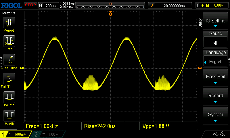

The distortion is not low. It's some 0.1%. Plus the headphone out started clipping (1st attachment).
Yesterday I replaced four dual OPamps, two at line out and two at headphone out. No change.
PSU is OK. I guess it's either the diodes or the FEts.
There are many of these 3 legs. 11 at line out, 7 at headphone out. Marking 10XUJ and 15Du
The distortion as probed on main level pot is on 2nd attachment.
I don't know what has happened. The output distortion was normally at the third decimal place. In general the EMU was a slightly better performer than a new Motu M2 which I have borrowed from a friend.
