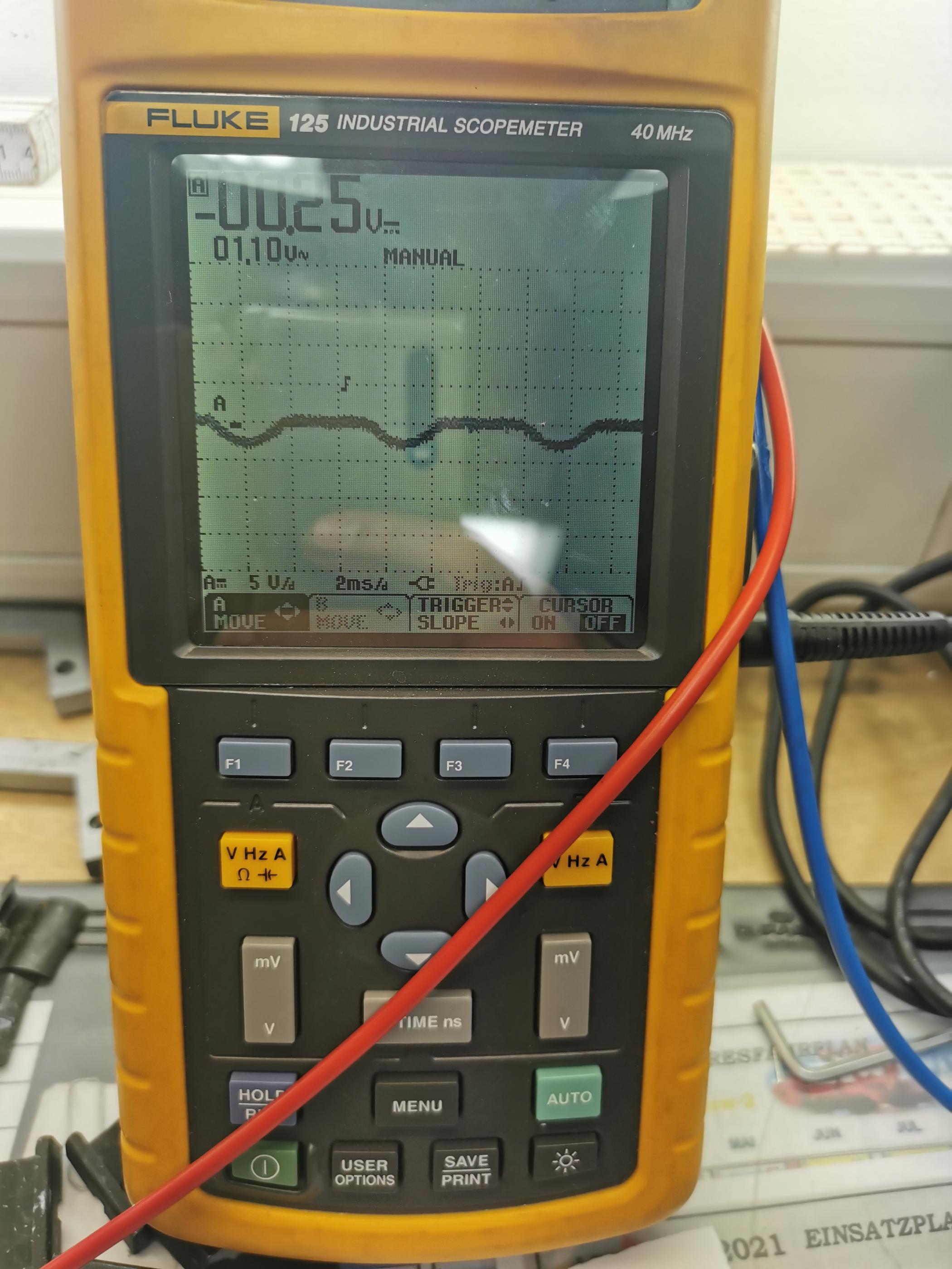

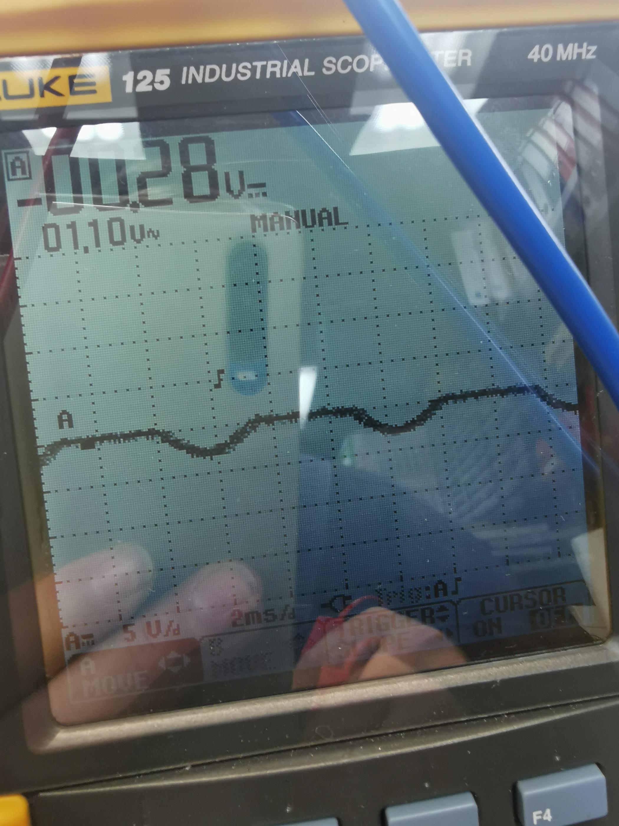

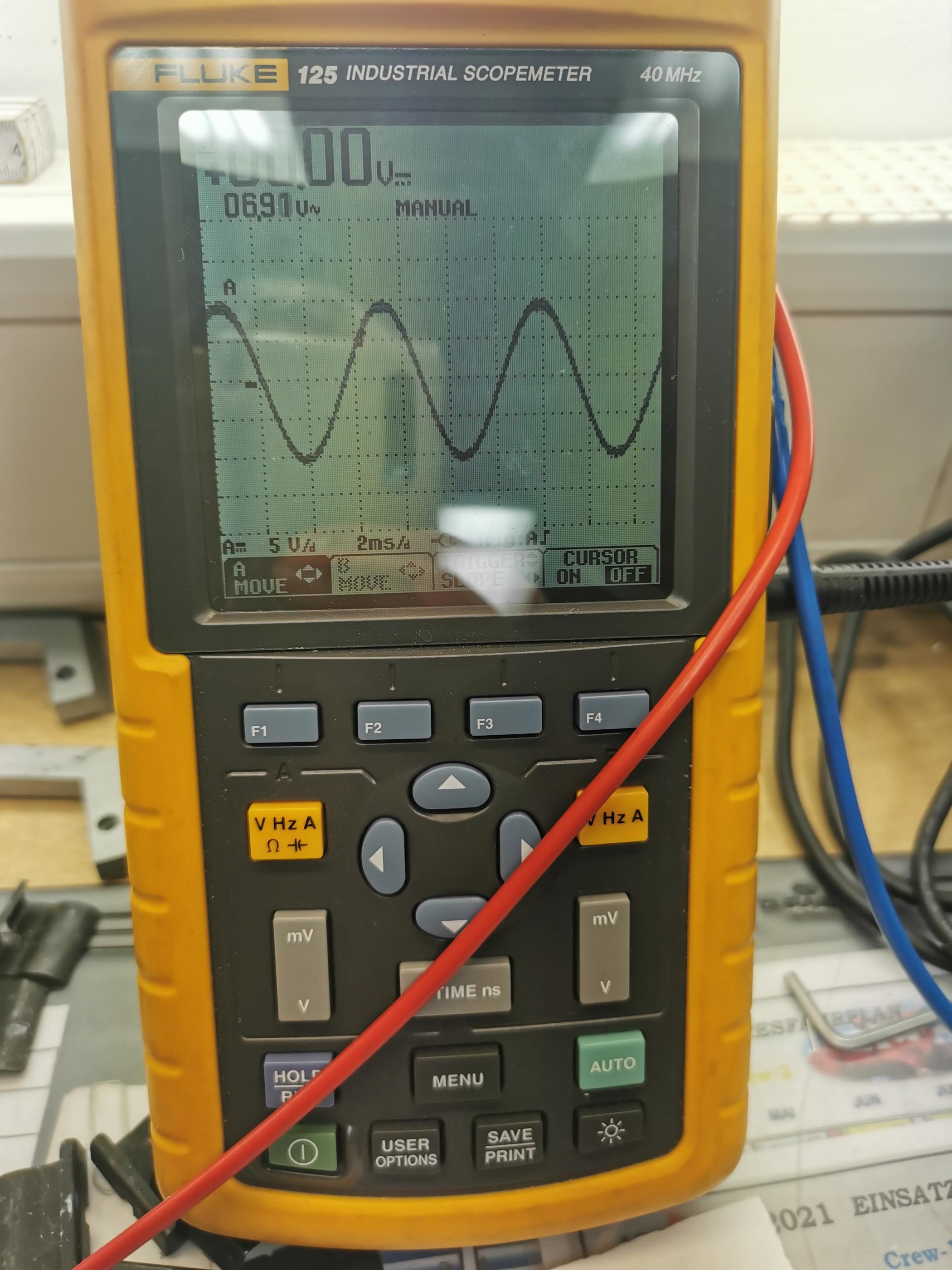

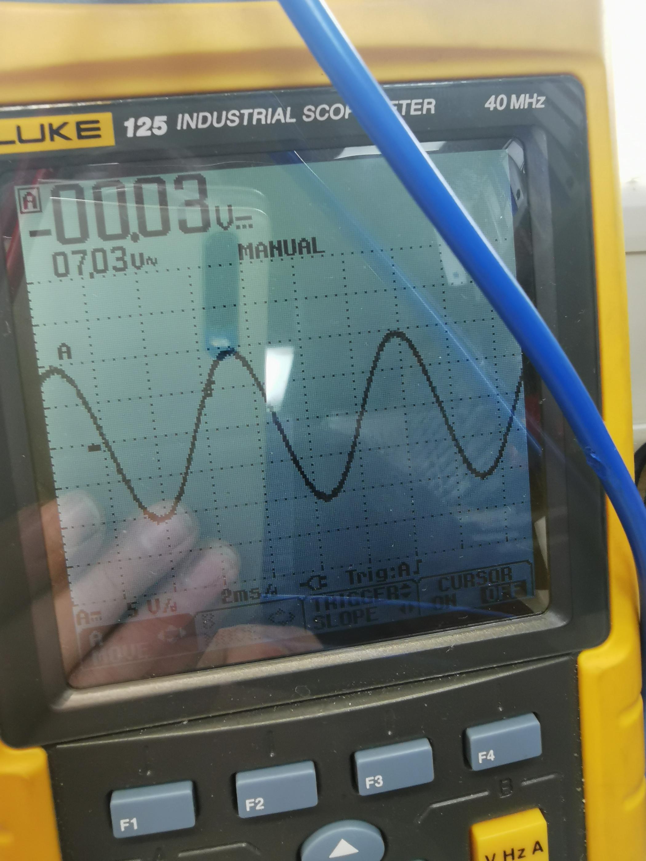

Yes, it's only a small signal, if I turn the gain, you can see, that it's working, but the amplification is not enough. It seems also, when I turn the gain full in, that it's clipped. But only 2 v. The amp draws all the time only 0.6 amps
That's the maximum I can reach with my smartphone and gain full in.

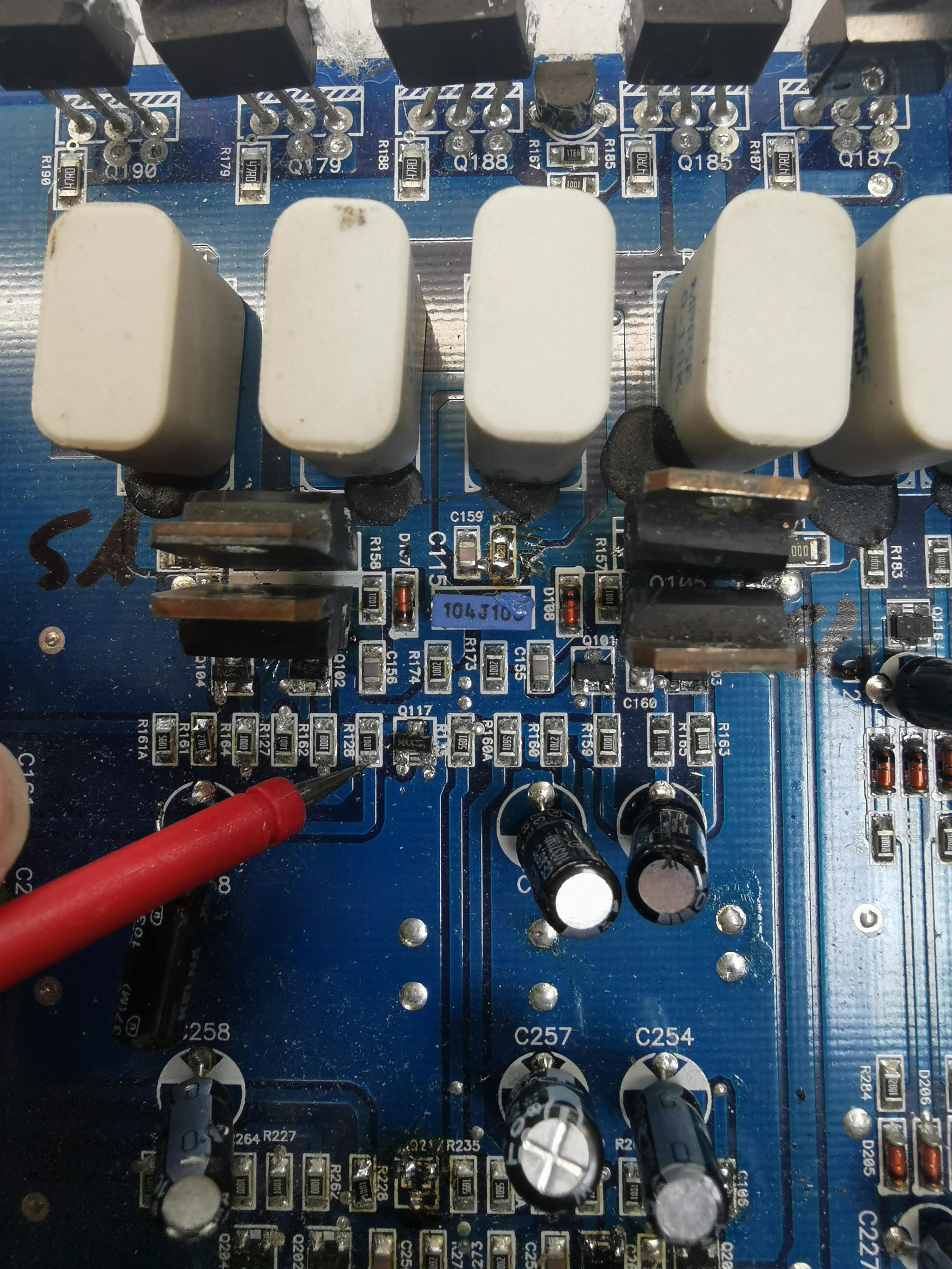

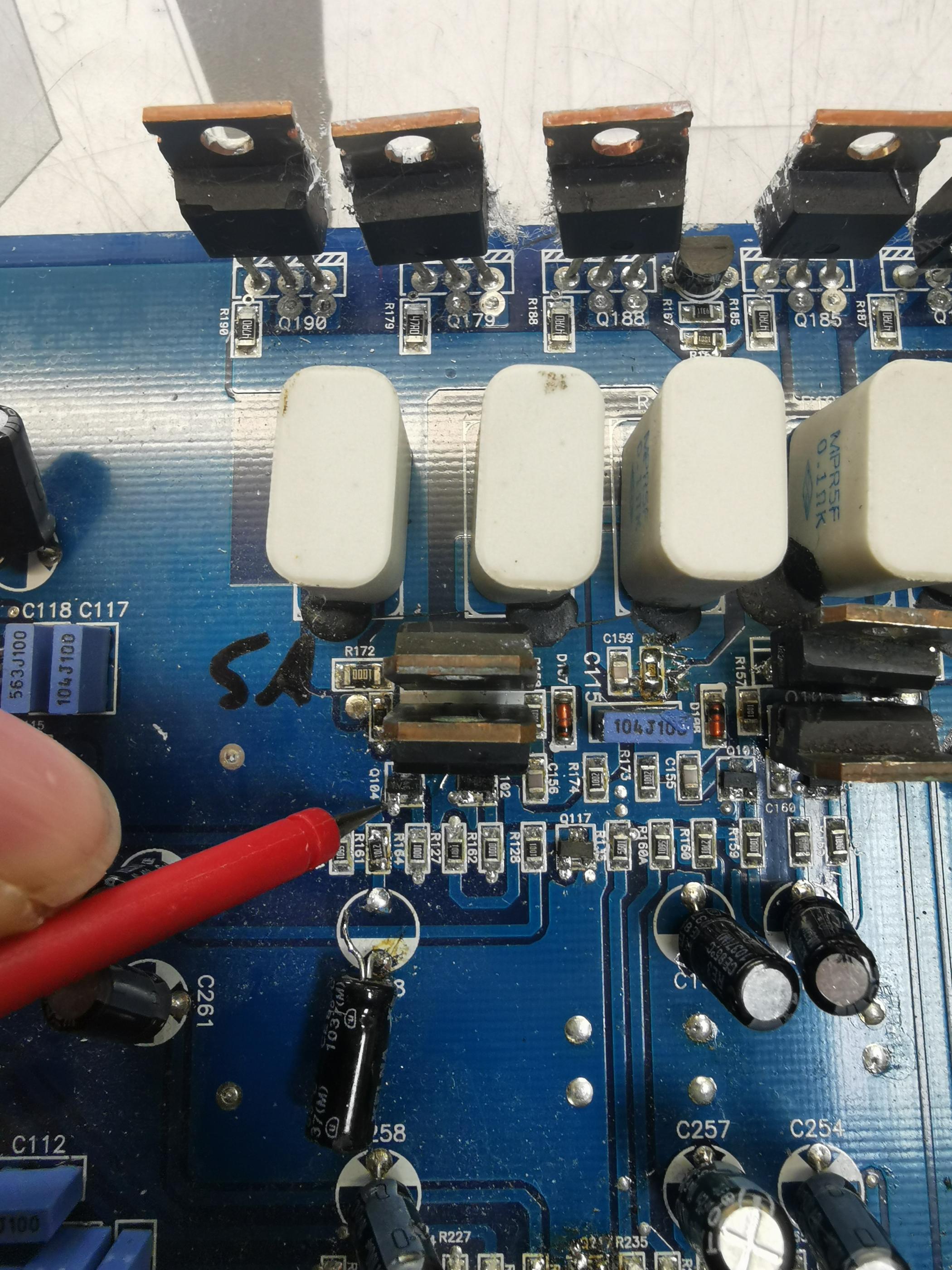

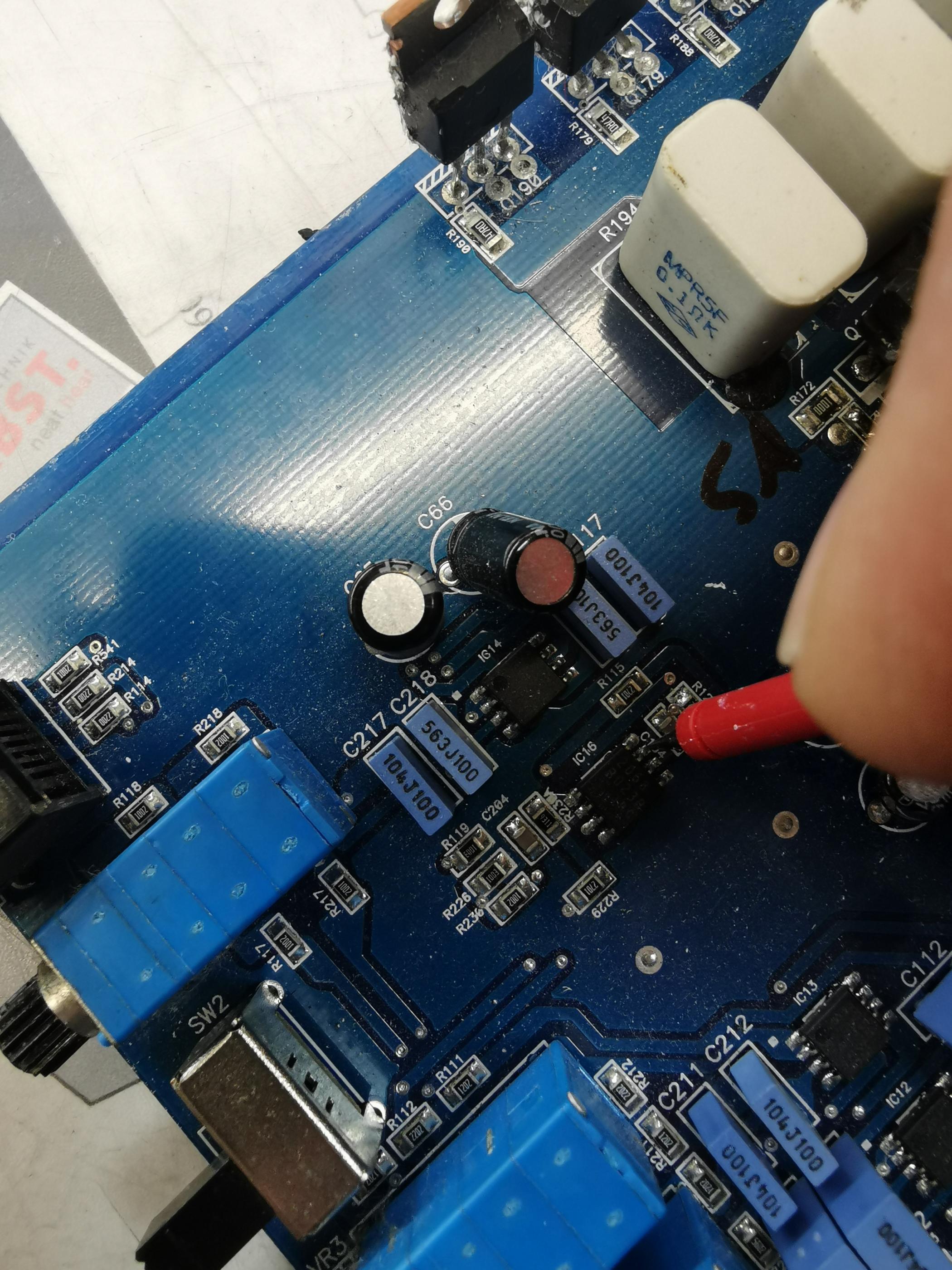

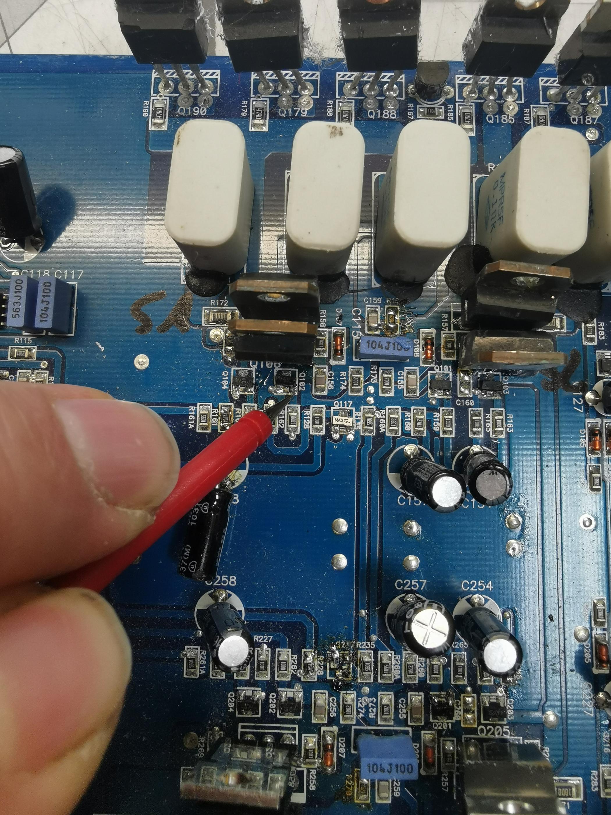

Yes, it's better. R161 2.1k is the one with 5.8v. This resistor goes to audio ground, and the other pin over a cap (+) to sec center. The connection from the resistor to +cap is also connected to resistor r161a. It's a 5.6k. The other end from r161a has 15v.

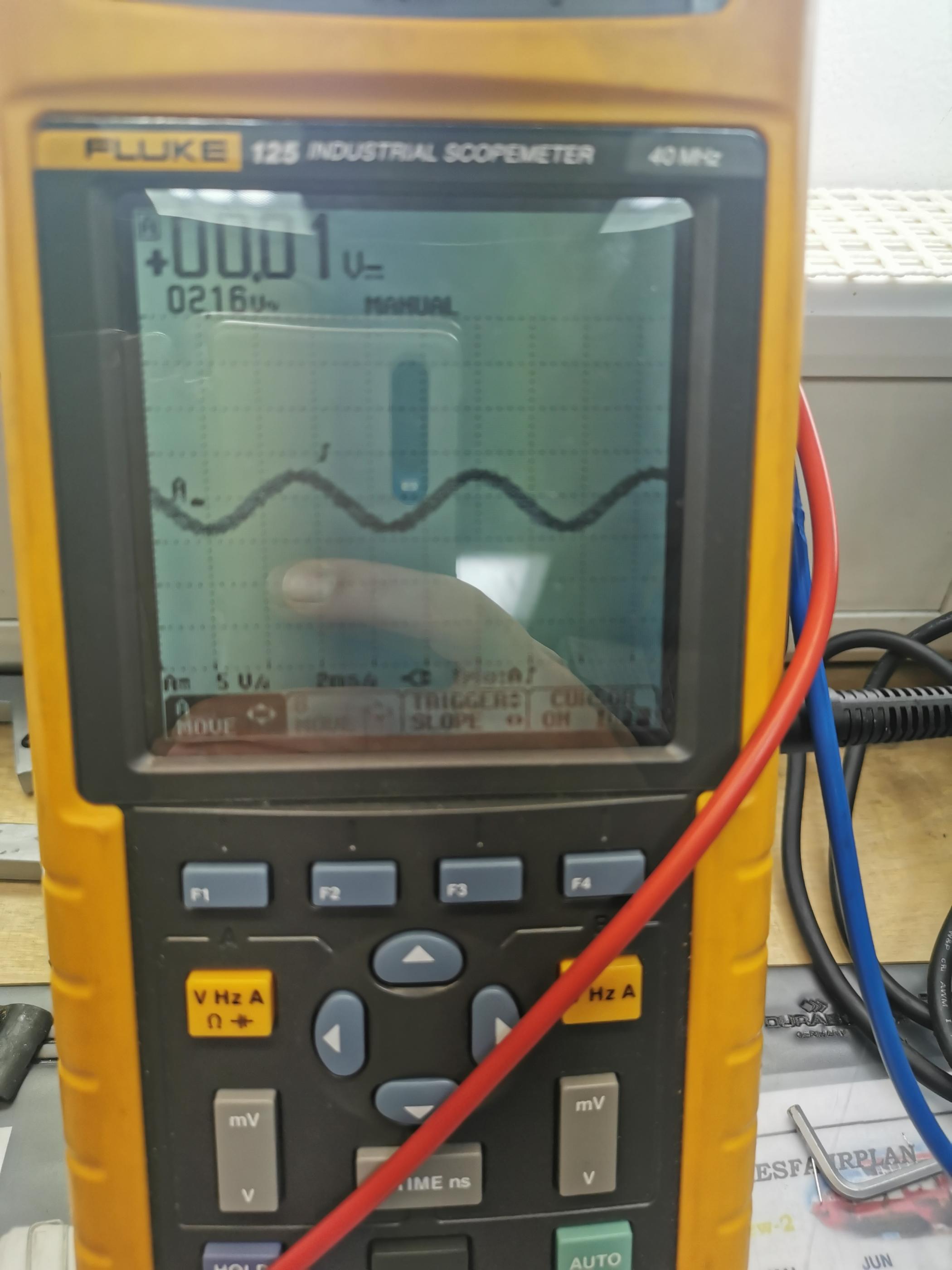

It's the same, but the half wave is on the opposite side. I lifted all four transistors from the diff. Amp, now I have 15v at the resistor. As soon, I connect one transistor, the voltage drops at this side to 5.8v.. The transistor are ok.
The signal is going over a1k resistor to Q117. From this pin also it goes to r162. From there it goes to the both diff amp transistors.
