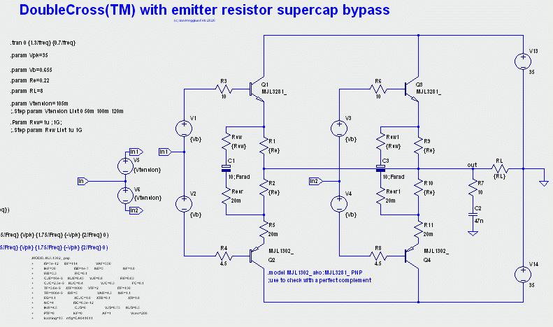

Supercap bypass for DoubleCross emitter resistors

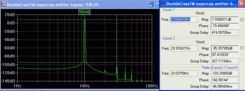

So supercap helps reducing distortion with both HexFets and BJTs.
The THD improvement is actually slightly less than 10 times because I compared an optimized bias supercap stage with an un-optimised bias standard stage. This was because of the simple way I stepped the circuit between two cases with one run.
But still the improvement backs up my claims that with virtually no emitter resistors you get significantly lower crossover distortion with vertical MOSFETs. With supercap bypass the two sources effectively get shorted together by the capacitor above a few Hertz; the 10F supercap I specified has an ESR of 20m ohms between the sources for AC and the MOSFETs have another 20m to 40m ohms in their wire-bonds and metalization so you can't completely eliminate the degeneration and get distortion much lower in a vertical MOSFET stage.
For the BJT output stage we can use two parallel stages and displace their center point either side of zero to get Bob Cordell's DoubleCross(TM) using supercap bypassing on each stage. The circuit is below:
attachment.php
Biased for a total idle current of 330mA (same as for the vdmos OPS in post above) with a displacement voltage of +/-105mV below shows the near zero distortion region extends to 4W peak (2 watts average).
attachment.php

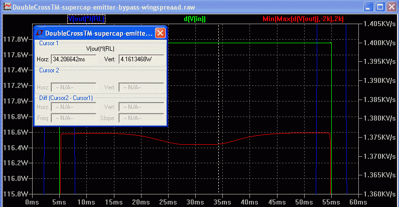

and the FFT below at 1 Watt average and THD is 0.0008% at 1W.
attachment.php
Looks promising for a no global feedback power amp.
The advantage of using supercaps to bypass the emitter resistors for AC in this circuit is the dynamic current sharing between parallel pairs is not impaired yet distortion is reduced.
As a reality check I still need to compare this output stage without the supercaps to check how much reduction in distortion is gained (if any). An electrothermal simulation might be able to answer this concern.
Also still unclear is whether a large 10F capacitor has any electrothermal side-effects with BJT's in the 1Hz-10Hz region. Vertical MOSFETs are probably safe (due to their lower Gm's). So it's still early days with BJT's for dynamic thermal stability with these large supercaps.
  • DoubleCrossTM-supercap-emitter-bypass.zip

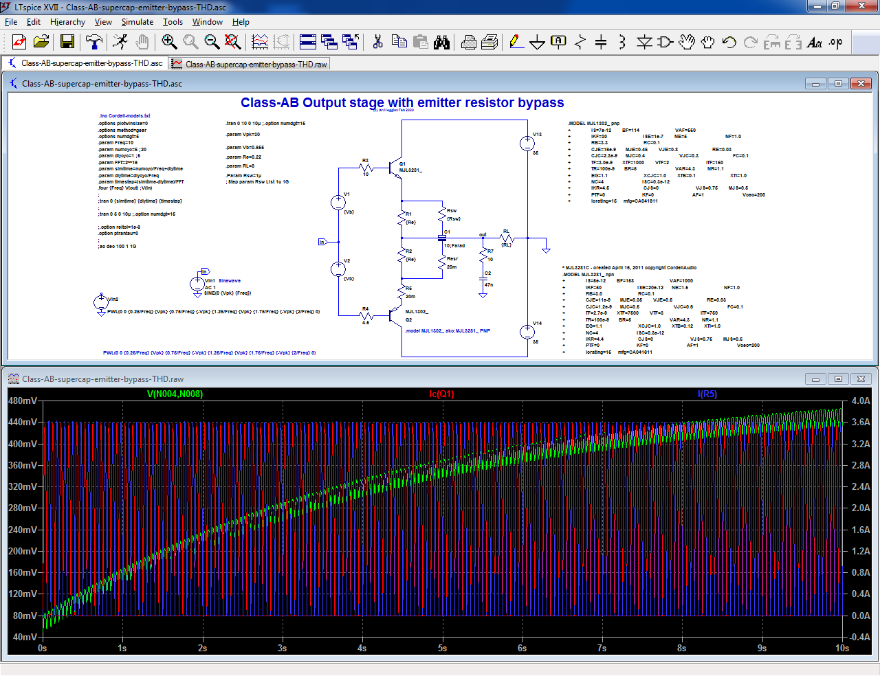

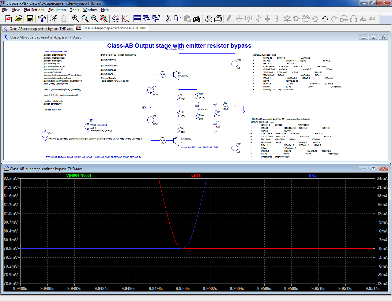

I do not see how capacitors can work with a class B OP: due to the rectification effect of the class B, the capacitors will progressively charge up during prolonged high output periods, and shift the bias of the OP towards cutoff.
During the loud passages this may not be noticeable, but if a quiet period follows, the program will suffer heavy Xover distortion until the capacitors have returned to their idle conditions.
With a class A OP, the average current remains the same for all output levels and there will be no such problem

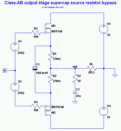

Perhaps this is also the query by Keantoken Post 47 (and others). If a capacitor is placed across each source resistor then, sure, you get rectified DC charging each capacitor with signals.
So I have been negligent to provide the circuit image in my post (I'm getting lazy). The VDMOS circuit is below.
attachment.php
With one capacitor across both resistors the DC components cancel out over whole cycles. My sim circuit available in Post 41 shows this with a burst of 2 cycles then nothing changed on the DC of the capacitor or bias currents.
For DC you have degeneration (as usual) for improved thermal stability. But for AC you have the two sources connected by a very low impedance (~ESR~20mR) which means closer to squarelaws which means closer to zero distortion.
Also for AC there is Rs/2 feeding to the load so the total gm is slightly higher giving even lower distortion from a follower..
And, when paralleling output pairs you have better AC current sharing due to this series Rs/2 for each pair.
This idea was not my own, it was suggested by Mark Aitchison who I did my engineering course with in NZ. He suggested it when he was proof reading my squarelaw amplifier article for Linear Audio Volume 1 around 2010.
Unfortunately supercapacitors were not suitable then, but now a low ESR capacitor of say 20 milliohms is only 10mm dia by 30mm for a few dollars ($5 1off in Aus). And the extra bypass electrolytic (5mF) is about the same size is only about one dollar.

That will happen to some extent, but maybe not too badly when, like Ian, you connect a single capacitor between the emitters or sources rather than one across each emitter or source resistor.
Indeed, it won't be as bad because the charging path will see one of the emitter or source resistors in series, but the discharging path will have both and the asymmetry will generate a charge accumulation.
How bad will it be in reality? I am not going to venture an opinion: after all, the Visch scheme has been (and probably still is) highly regarded.
This is a sim for a period of 10s, at near max power:
attachment.php
The green trace is the voltage across the cap: the bias shift is just under 400mV.
This is a zoom on the Xover region after the 10s period:
attachment.php
Iq clearly falls to zero. After a very loud passage, it might not be noticeable if the recovery time is sufficiently short, but I wouldn't bet on it

Indeed, ... the asymmetry will generate a charge accumulation. ... Iq clearly falls to zero.

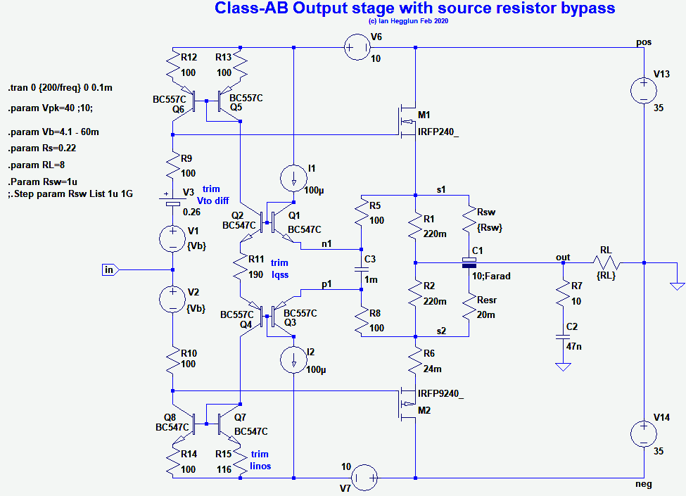

Hi Elvee,
Thanks for spotting that. It is a serious effect and needs a fix.
One way to keep the bias point about the same independent of signal level and duration is to bootstrap the bias voltages. See below (for proof of concept). You can run the attached circuit to probe the crossover points and try different signal levels to check how well it works.
attachment.php
V4 removes the idle voltage across R1+R2. For the bias used 338mA this is about 147mV. R5 and C3 removes most of the ripple from C1 ESR.
V3 and R6 are part of the previous unbootstrapped circuit to trim p- and n- mismatch (so 2nd harmonic doesn't dominate in THD).

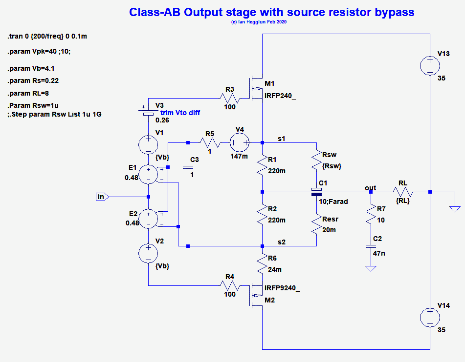

Following Post 57 here's an implementation of bootstrapping to remove the supercapacitor displacement with varying power levels.
attachment.php
Trim R11 for the bootstrap gain (~0.9).
Trim R15 for mirror symmetry (nulls out input current offset).
None of these are critical adjustments with trimpots assuming additional stages are used. For a no global feedback amp at least one trimpot or a servo will be needed to trim out the output offset voltage.

It does seem to solve the issue, which is good, but it requires several layers of additional complexity, which makes it moderately attractive.
A full Iq servo would probably have a comparable level of complexity, and have a better, more deterministic control over the Iq without emitter/source resistors
