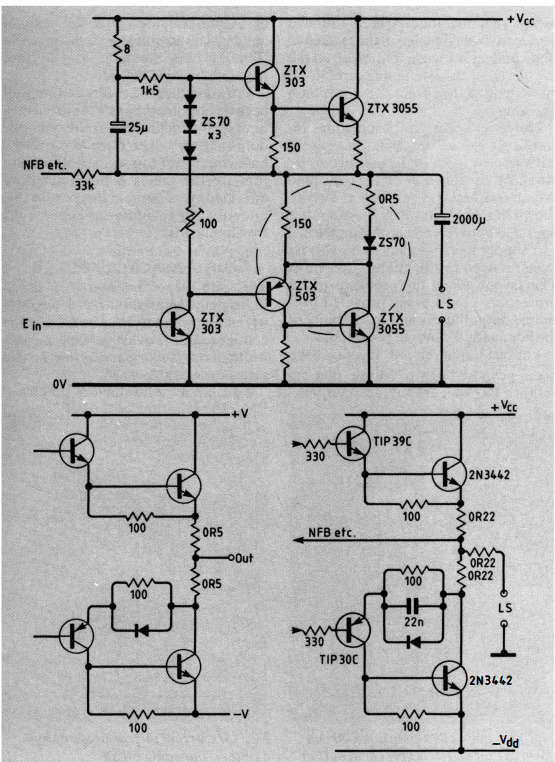

The JLH has Q1 with R3 and Q2 on the emitter. Q3 has D1+R5+C1 on the emitter these extra components are an attempt to load both drivers with the same impedance.
D1 is the Baxandall diode. C1 is the JLH capacitor. R5 is from Shaw if I remember correctly. Three stages of improvement to the quasi comp stage to bring performance upto and some would say exceed a complementary output stage for performance.
The un-named has both drivers with R1/R2 and D1 to mimic the transistor Q4. It is to the Baxandall style. Probably pretty good for driver loading.
Read up Shaw, Baxandall and JLH modifications to quasi complementary output stages.
BTW,
the Shaw+Baxandall+JLH modifications are probably at the best of all the quasi output stages when set up correctly. That means the right diode, the right capacitor, the right resistor and the right currents.
For reference please: Top one is (a), Bottom left is (b), and (c) is bottom right.
Fig. 7. Shaw's improved quasi­-complementary design from 1969, which used a diode to improve symmetry, is seen at (a). At (b), Baxandall's variation further improves symmetry, and (c) shows author's use of small capacitor to simulate effect of base/emitter capacitance.
Fig. 7. Shaw's improved quasi*-complementary design from 1969, which used a diode to improve symmetry, is seen at (a). At (b), Baxandall's variation further improves symmetry, and (c) shows author's use of small capacitor to simulate effect of base/emitter capacitance.
So I remembered wrongly.
I was attributing the resistor to Shaw. He suggested the diode.
At least I got his name right so that you could find the example to keep me right.
