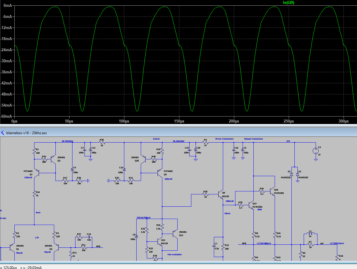

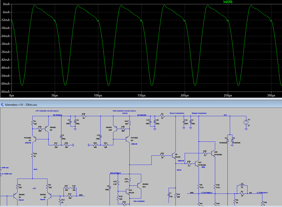

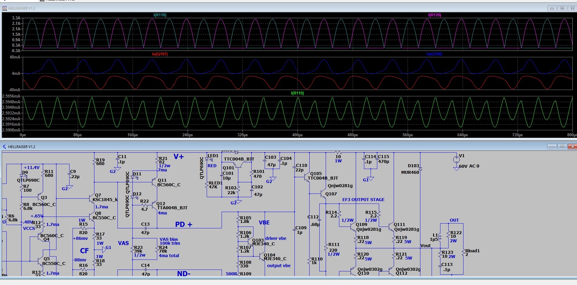

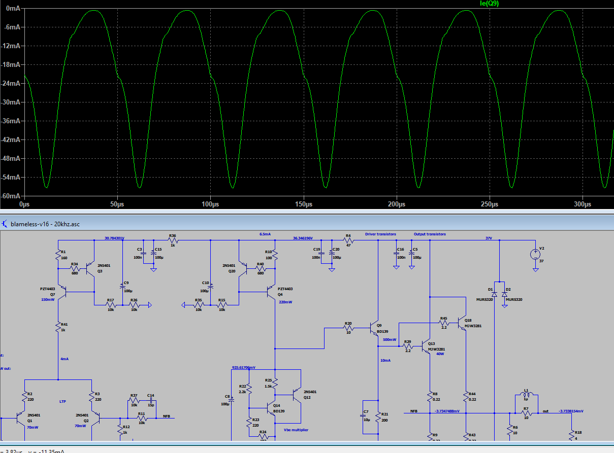

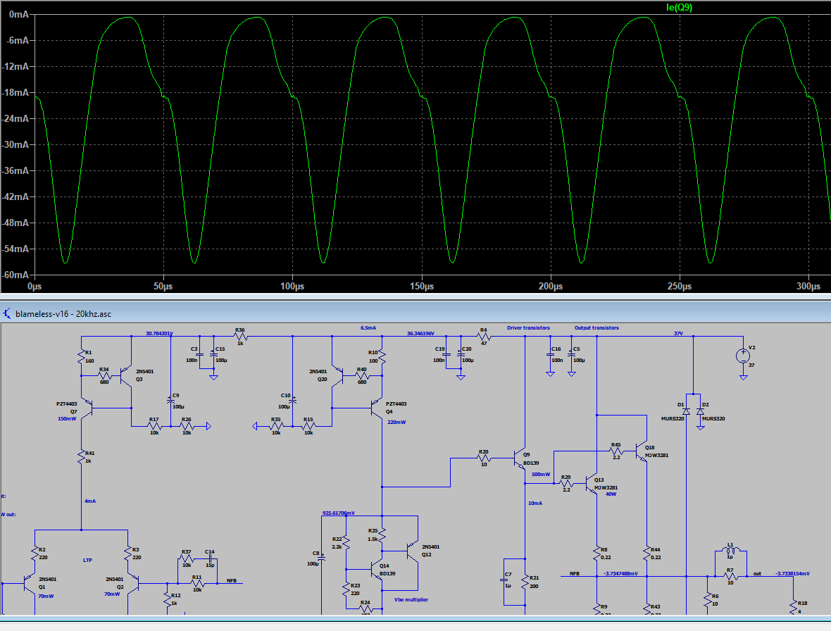

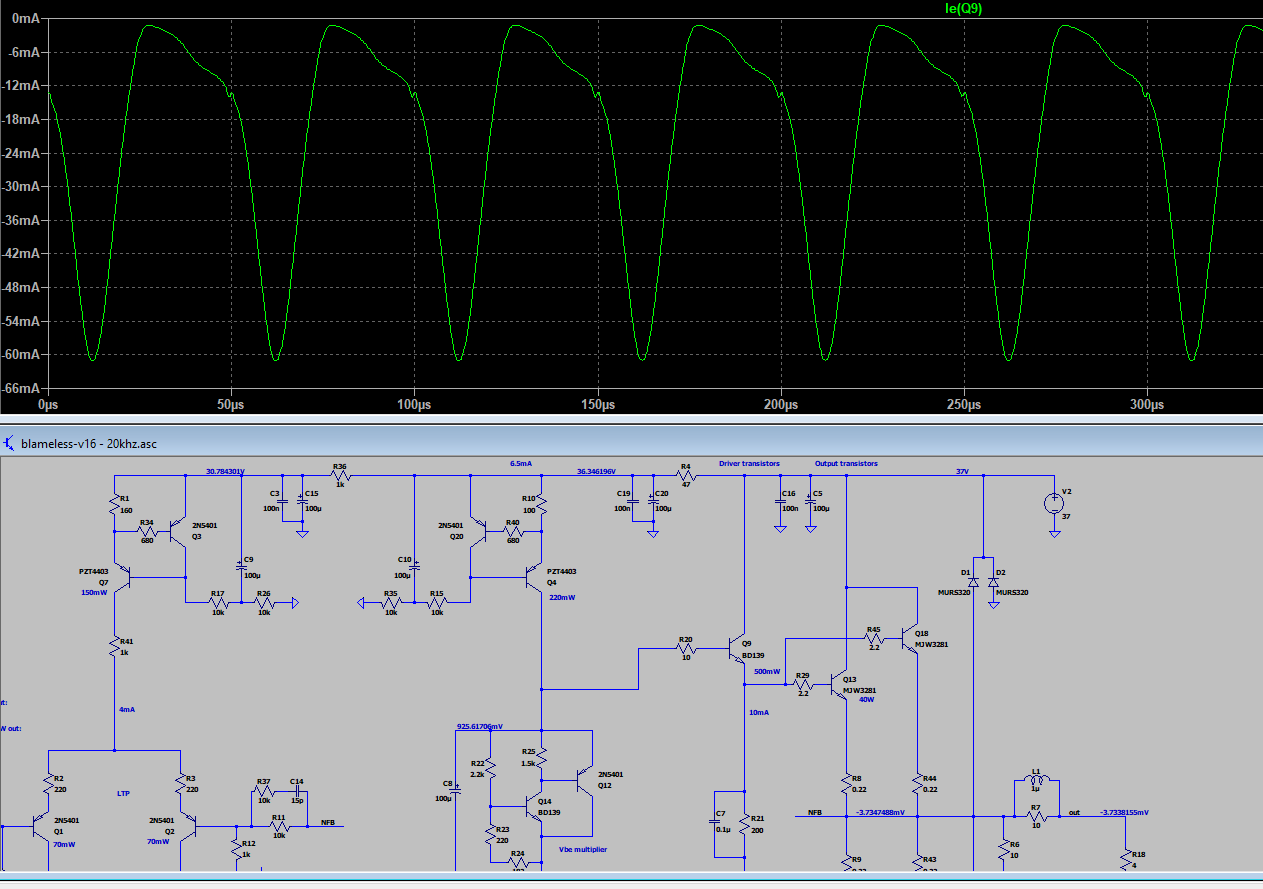

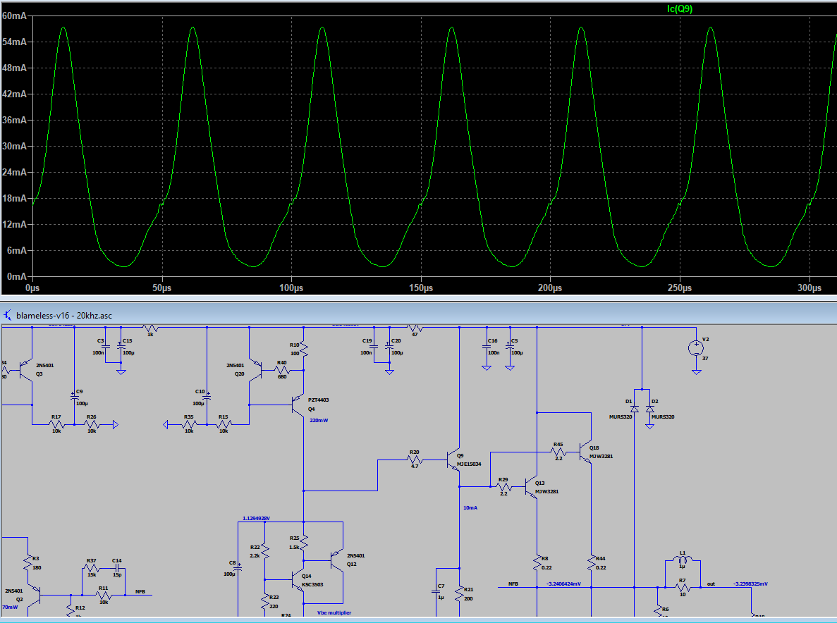

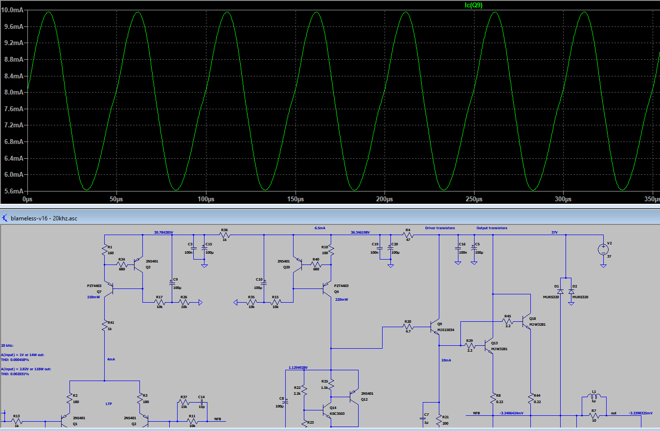

I am having too much fun in a simulator and discovered that by measuring collector currents for transistors in the output stage can show if it distorts the signal by deviating from the perfect sine wave. Also, spikes of current apparently indicate of quasi saturation operation.

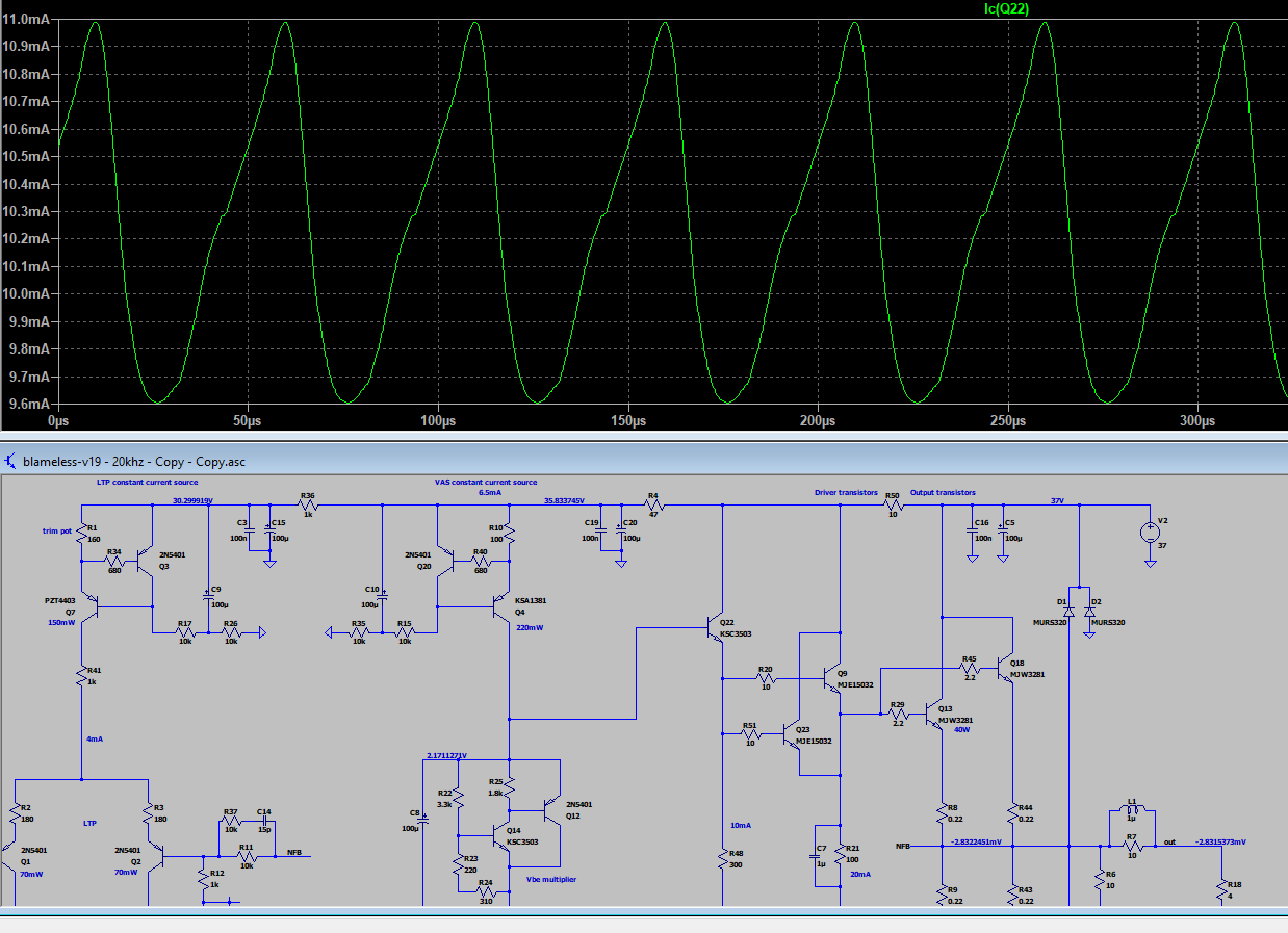

Throwing together 3EF with two output pairs I have measured currents on all three transistors: pre-drivers, drivers, and outputs.
What I observed was that out of the three - driver transistor was working the hardest with current spikes up to 80mA while driving 4 ohm load with 20khz sine wave signal at full power.

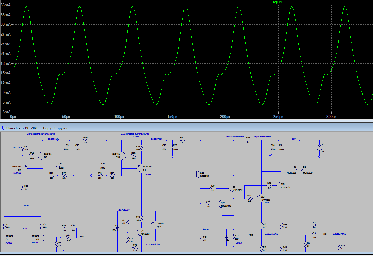

I therefore was wondering how to fix it and got an idea - what if I add another driver transistor in parallel?
I measured currents from pre-driver and driver collectors and attached are screenshots to compare both.
Visually comparing between both it can be seen that spikes were reduced to under 36mA for driver transistors.
Just a though for discussion.

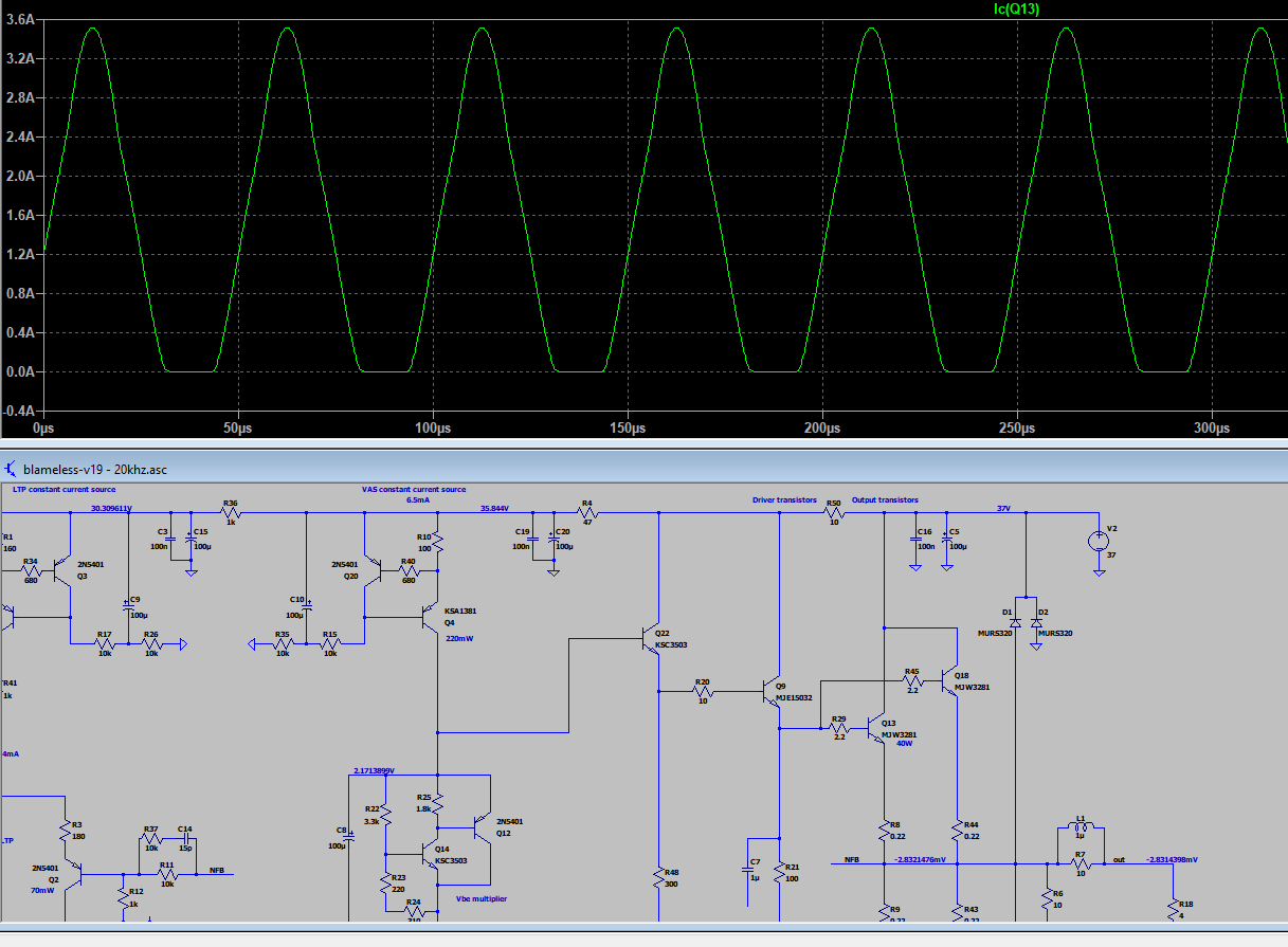

It seems that driver transistors will operate in quasi saturation region regardless if it is EF3 or EF2.
Or if it’s MJW1302/3281 ,
MJE15032/33,
TTC004/A004, or
BD139/140
All those were simulated and showed same peaks in current up to 60-80 mA.
Just an observation.
Those peaks can be reduced in the same way as paralleling output transistors I think.
Interesting. 72mA is not a problem. The problem I see is the blip on the way up. That is distortion.
I don't use capacitors if they introduce reactance at audio frequencies. I bias the drivers at somewhat higher current.
Of course, my amp has had neither simulation nor full-power testing. 😉
No difference , drivers will still have the same Ic regardless of what (group of semi's) they are driving. Output load is the major factor.
Amp i'm using now will get hot with to-220 drivers at a 2R subwoofer load. TO-3P runs cool to the touch. Output Hfe makes the difference ,
OEM's usually use the highest Hfe Sanken outputs to overcome small drivers. My HK680 has NO heatsink for the drivers , at all. They just get slightly
warm.
I blame @printnik for pointing me to the quasi saturation concept lol
I just learned it myself.

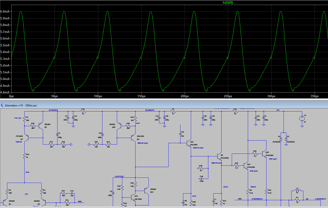

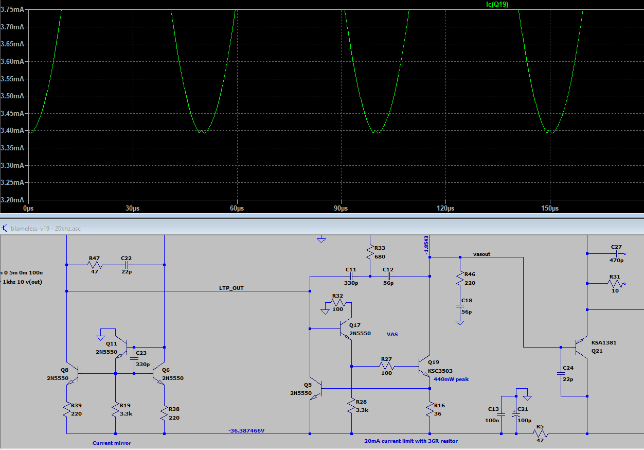

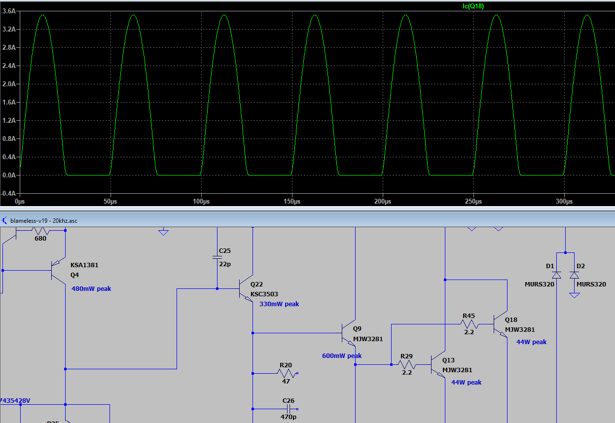

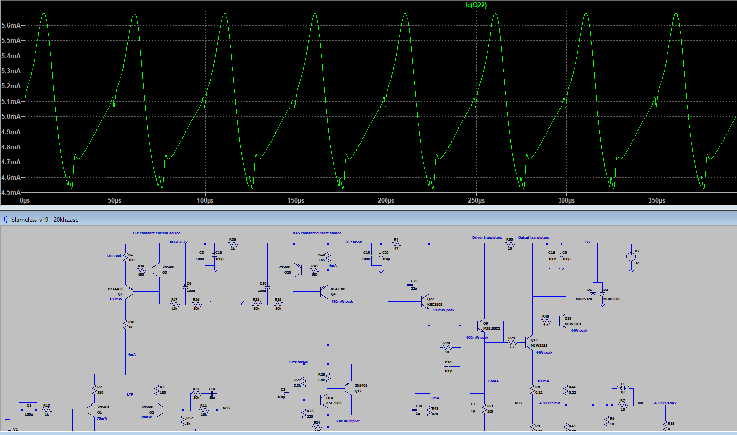

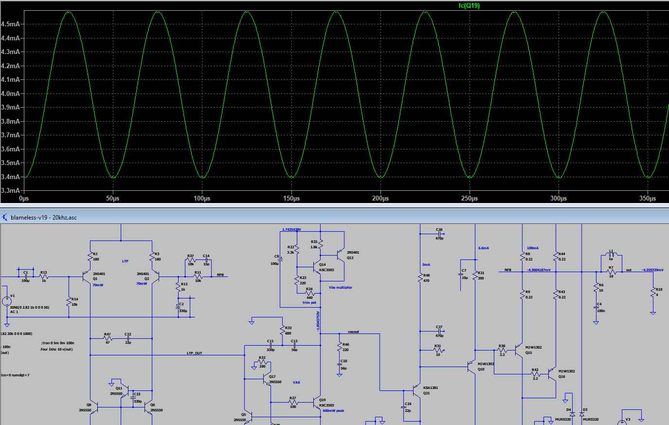

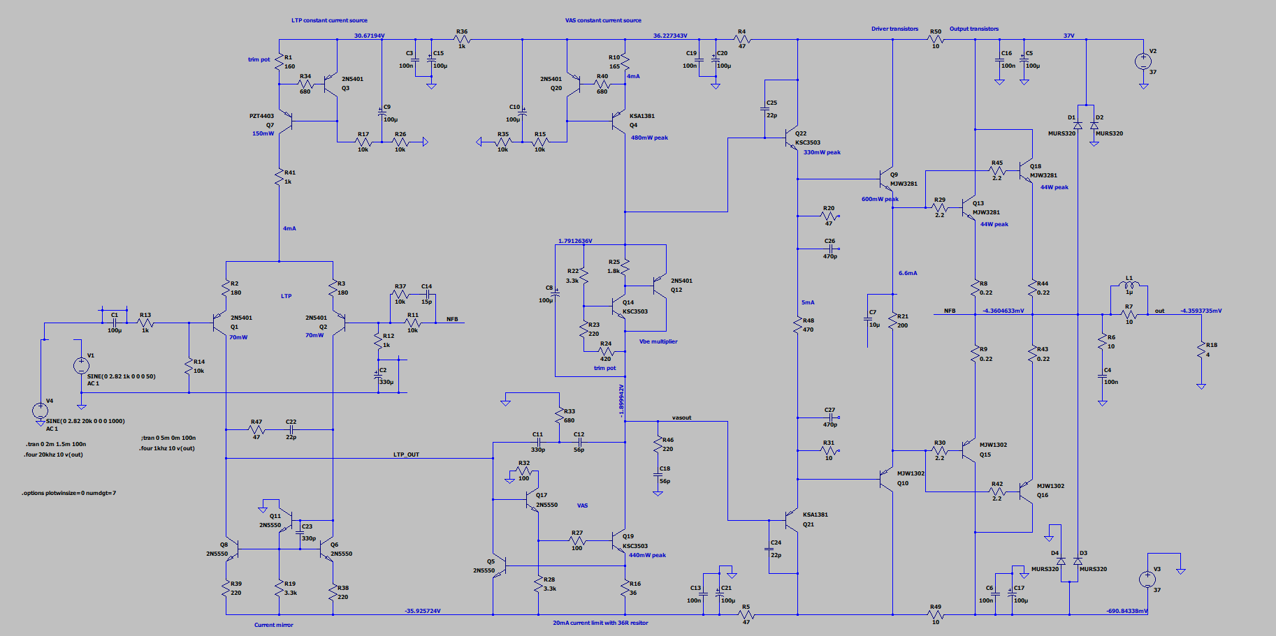

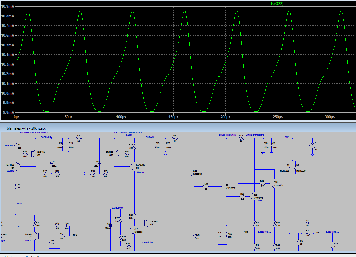

That is not too bad comparing to what pre-driver has to go through at 20khz max power out.
Attached are plotted collector currents for VAS, pre-driver, driver and outputs.
No switch-off speedup capacitor was used.
Note that currents were all set pretty low but not as low that transistors go into cutoff region. Seems to work with 4ohm pure resistive load. Bias for output transistors was set at 100mA.
Lastly attached current plot for VAS zoomed in. Note a notch at the bottom.

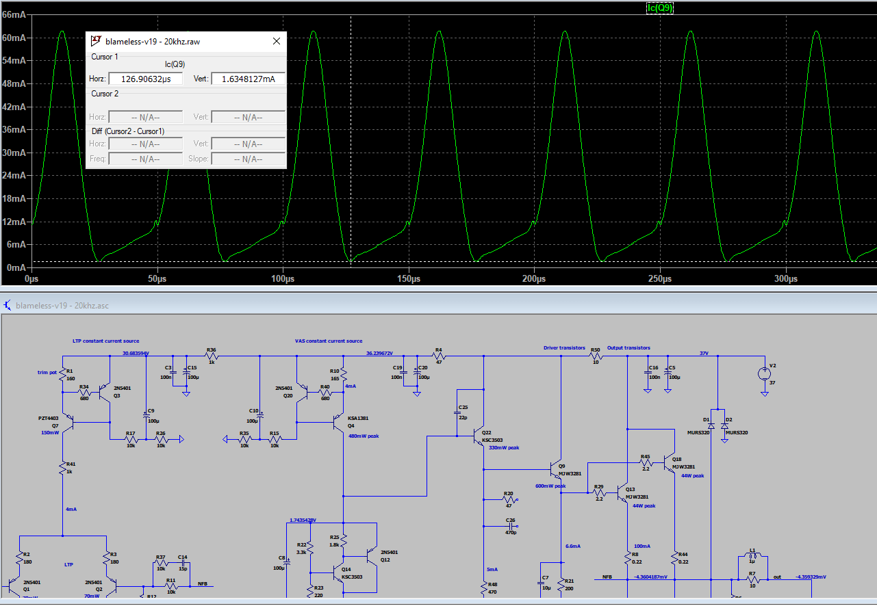

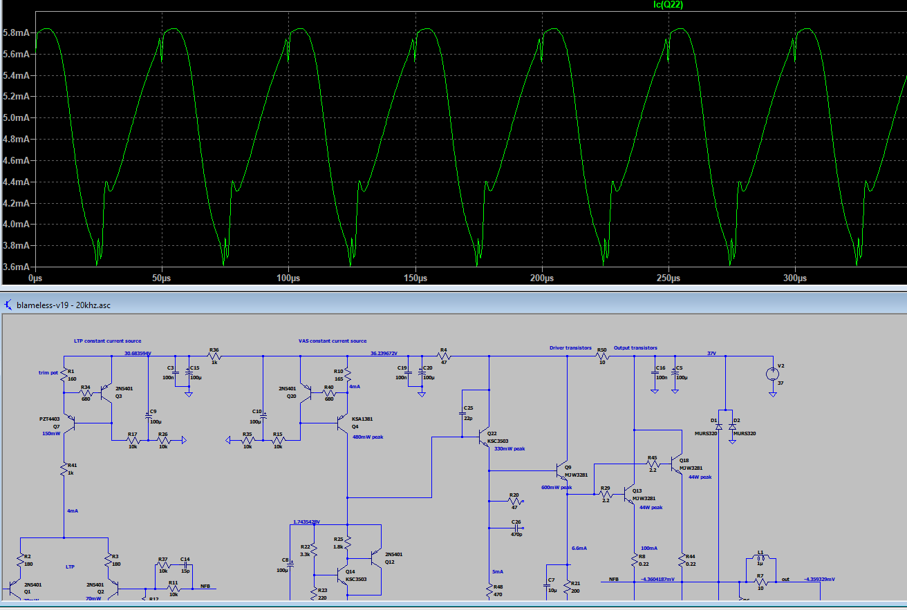

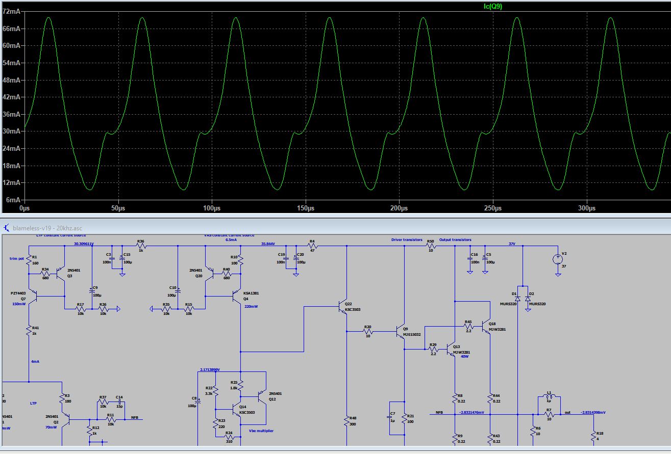

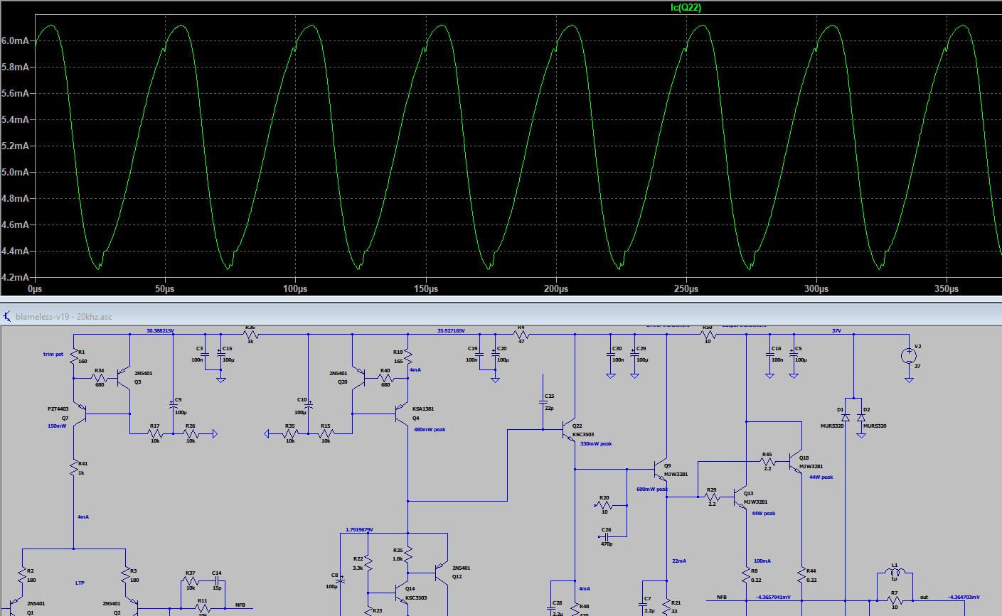

And switching driver transistors to 15032/33 worsens the life of the pre-drivers even more...
Note after adding two 2.2u caps to pre-driver and driver current setting resistors the situation was improved somewhat, but far from perfect.
Adding caps introduces an extra non linear component to the audio path though... It's a catch 22 🤷🏻‍♂️

The amp is missing supply decoupling capacitors on the pre-driver and driver supply. The driver is causing a 0.6V drop which couples into the signal through C25.
In addition to avoiding capacitors with reactance at audio frequencies, another rule is to avoid capacitors that couple supply noise into the signal. I see the latter mistake in many designs.
Ed

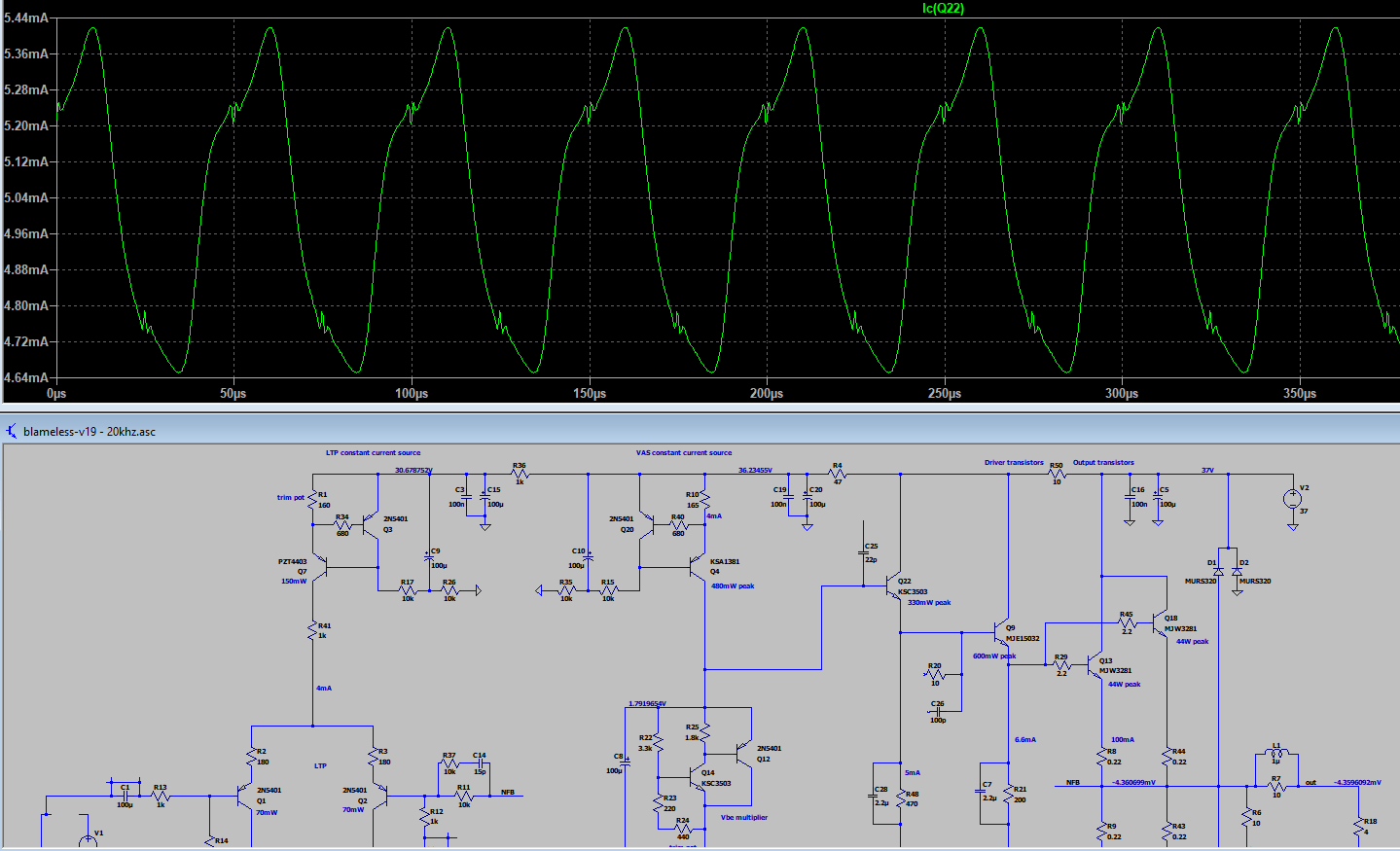

Added decoupling capacitors but it did not improve simulation.
What really helped to reduce non linear behavior of the pre-drivers collector currents was increasing the current for drivers MJE15032/33 to 20mA.
Running VAS at 4mA, pre drivers at 5mA, drivers at 20mA, and outputs at 100mA. Much much better behaved output stage.
Attached is collector current plot for pre drivers.
For MJW3281/1302 drivers current needs to be increased to 40 mA to allow for minimum non linearities of the pre driver stage. Results in the second attachment.
