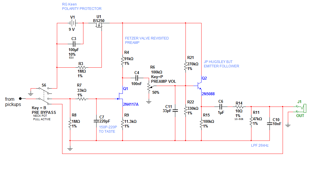

emitter follower for onboard guitar preamp
looking for a BJT buffer to follow the Fetzer Valve Revisited possibly like this emitter follower
i understand some basics of transistors but i could use some help.
Does Q1 need a bias resistor from gate to V+ ? (the Fetzer design does not use one)
Q1 Zout seems to be 14k according to Multisim. is the volume pot in the best place, impedance wise?
the pot wiper position seems to change the voltage at the output of Q1 (loading). i could eliminate C4 if i knew & can count on the voltage at Q2 to be steady. otherwise i have to bias it, is this correct?
any way to make this simple 2-stage amp more elegant?
any other suggestions are welcome! thanks.

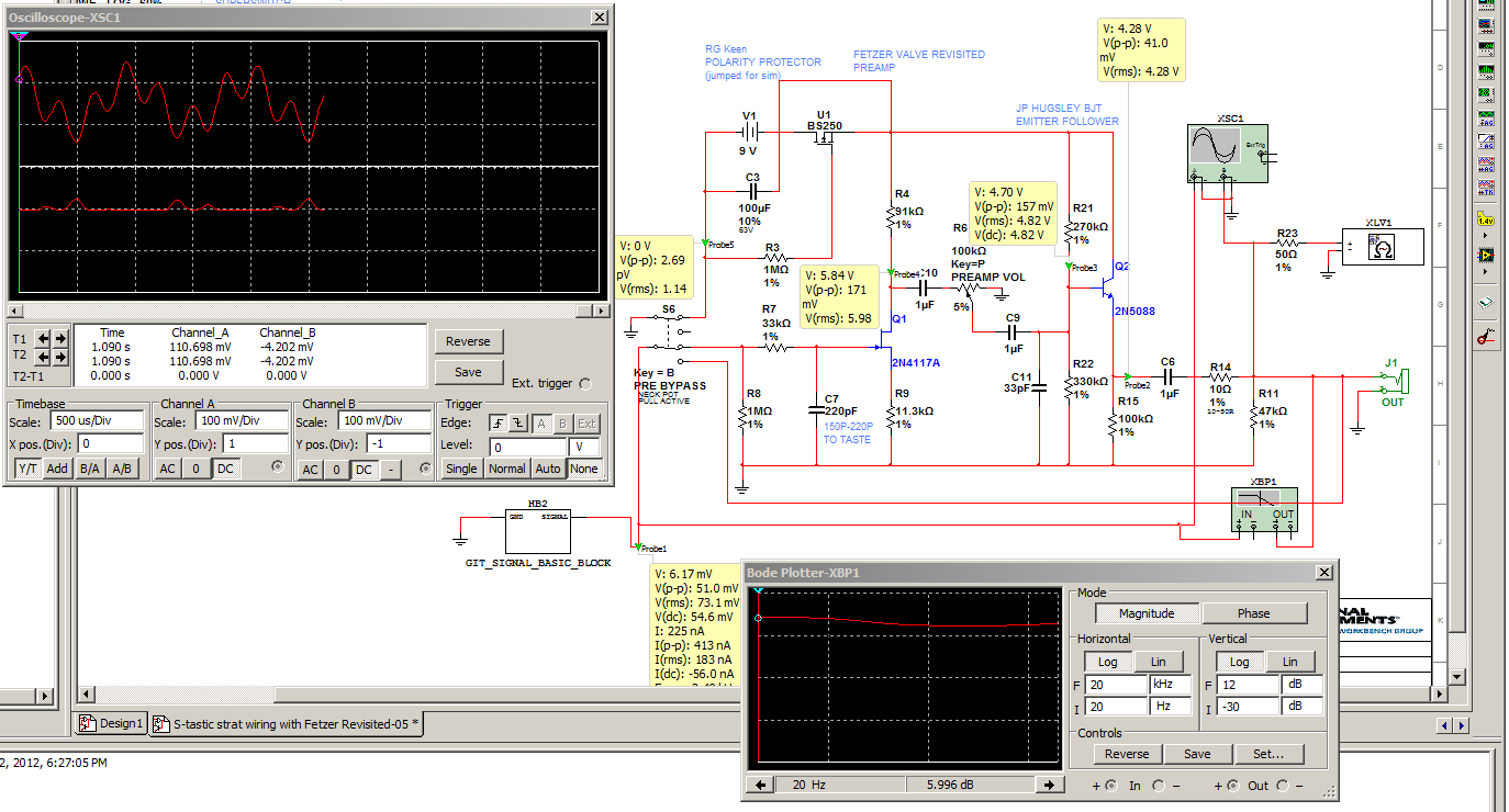

i am still getting strange interactions between the 2 stages although they simulate fine separately. and now i see a half-wave rectified type of output on the scope.
i have tried removing R6 pot & C9 coupling cap (and rebiasing), no help there.
Reducing emitter resistor R15 to 10k makes things even worse, creates a strong LPF at about 1kHz.
I am new to transistors and am just trying to add a low Z buffer to the Fetzer stage. I am lost..
any advice is really appreciated!!

thank you Loud, i have added coupling caps and voltage probe points.
when i reduce R15 to say 10k, i get a full waveform on the scope. but the Bode plotter then shows a huge frequency dip -10dB centered around 4500Hz, i can't find where this filter action is happpening. when i looked at either transistor stage alone, they seemed to be ok, not totally sure about this tho.
Note that I chose the 4117 FET based on desired specs for Idss and Vp specs according to the Fetzer Revisited article. I am not sure if I should take more gain in this stage, however (or how to do it). I would like to design for a volume range from pristine clean tone with maximum headroom, to a slight overdrive, if possible. I want a Zout of 600-1k after the emitter follower for plugging into a console/audio interface. I am open to changing anything you see. Thanks so much for taking a look.

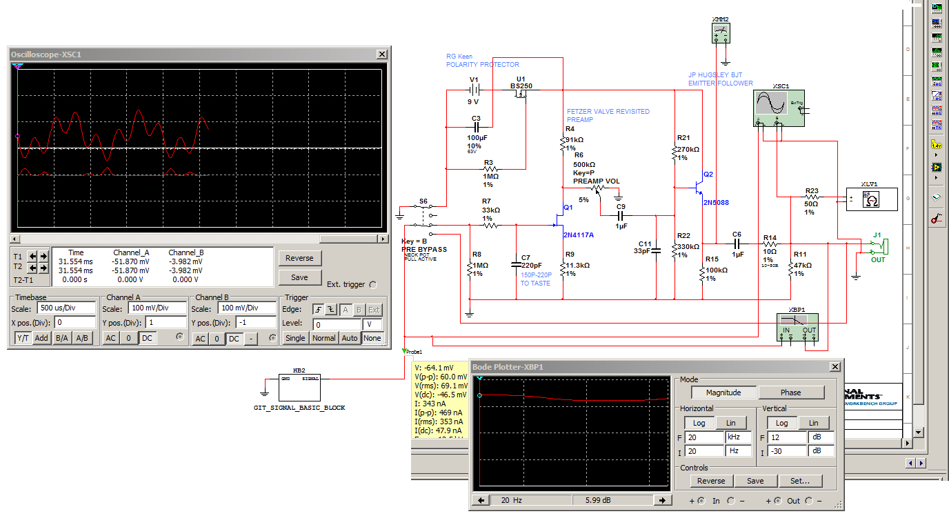

this shows what happens when i change the pot to a rheostat type of style, and change emitter resistor R15 to 10k (approx. 1/10th of the R21 || R22 which i think is more textbook)
is the pot even in the best location? considering i want very low Zout, i thought this was the best place for it instead of at end of circuit. if i could have something like a ~5k pot on the very output, then that would also get my output impedance within spec, since the Zout of the pot would be 0-1250 ohms max. even this is higher than i had hoped for though.

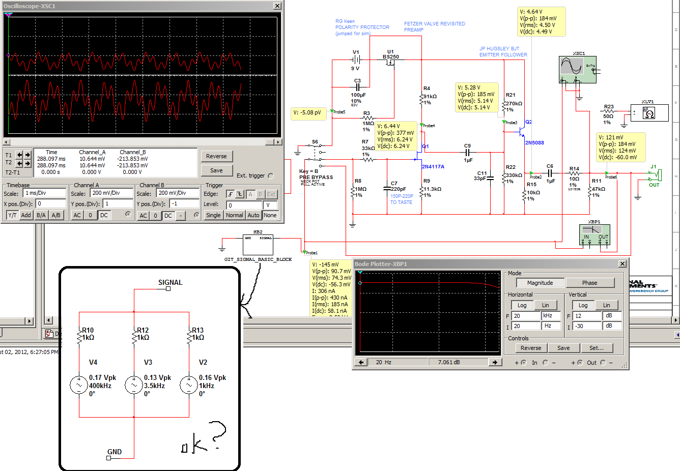

GOT IT
now THIS is what i am talking about! :) :)
the Multisim impedance meter (with the recommended 50ohm input resis) was causing that huge drop in level in the high freq's. makes sense, a 50ohm load just doesn't sound right at all.
i also temporarily got rid of the volume pot and biasing resistors for the EF and everything seems to be fitting into place now. very encouraging.
now, how do get the volume range i would like (clean/max headroom to slightly overdriven. slightly overdriven (driving a console input) is what, maybe 2-3V pk-pk? i probably need a better guitar circuit model (see inset) to start with. mine is a guess.
and then, to find the best place for the volume pot. i am also considering adding a passive 2-pot tone circuit between the 2 transistor stages.
thanks, hope this thread helps someone else too.

Hi n0nspaz,
I attached a jpg schematic of your design with some suggestions that will fix some of the biasing issues you mentioned and improve the gain of Q1. Please let me know if this was helpful and/or if you have any questions.
Good Luck, JP

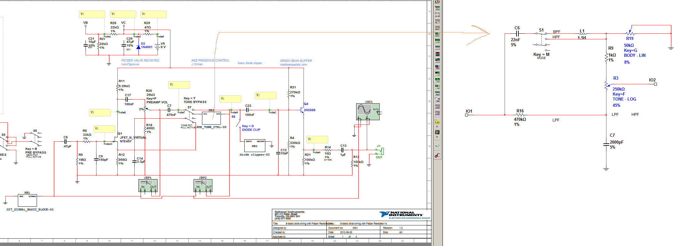

trying to insert a passive EQ circuit after the vol pot now.
although the 2N4117 uses VERY low battery power i am thinking of using an NTE457 (Vp 1.26, Idss 1.09mA) instead. this will give me a Zout (R4 in your schematic) of 5.3k according to the Fetzer calc. thus my vol pot can be 10k or 25k, reducing noise and allowing a passive EQ using reasonable Zin, to follow it. still drawing this up.
love to hear your thoughts! thanks again!
i had the idea of switching in C14 to make up for the passive EQ loss (when EQ is engaged). maybe i should just put a state variable in there. if anyone knows of a small footprint EQ that will give me HPF, LPF, wide mid scoop 'acoustic' guitar sound, and modest mid boost (Clapton or whatever)...this is what i am after. what you see is the closest i have come.

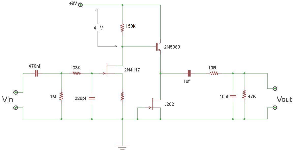

Hi
The 4117 J-fets I use in my projects have Idss from 40-60uA. So a class A bias of 20uA is reasonable, could even be more like 15uA. Expect Vgs @ 20uA to be around -0.2V so 11K for the source resistor should be fairly close. Because of the variance in J-fets, this resistor value may need some small adjustments.
Add too many caps and filters to such a high impedance circuit, in the real world:rolleyes:, and you might end up with a radio reciever.:D
J-fets are well suited for direct coupling to BJT's. Why capacitor couple the J-fet to the BJT? In this similar circuit I just made up, the drain resistor drops 4V resulting in 4.6Vce on the 5089. The 5089 transistors I have, has a current gain of about 500. J202 Idss is about 2 or 3mA. 3mA/500=6uA, so the drain resistor would be 4V/(20uA + 6uA)= 153.8K or 150K. For 15uA Id, 4V/(15uA + 6uA)= 190K.
Hi CBS240,
I agree, I like your design for it's elegance (without the coupling cap), very cool. The only reason I would suggest the more complex coupling cap and extra biasing resistor(s) configuration would be due to the slight variance in biasing parameters for the average JFET. Unless you predetermine what those biasing levels would be, you might have a symmetry issue with the output biasing point of the emitter follower stage. Probably not an issue for this application though. Simpler is almost always better. Thanks, JP

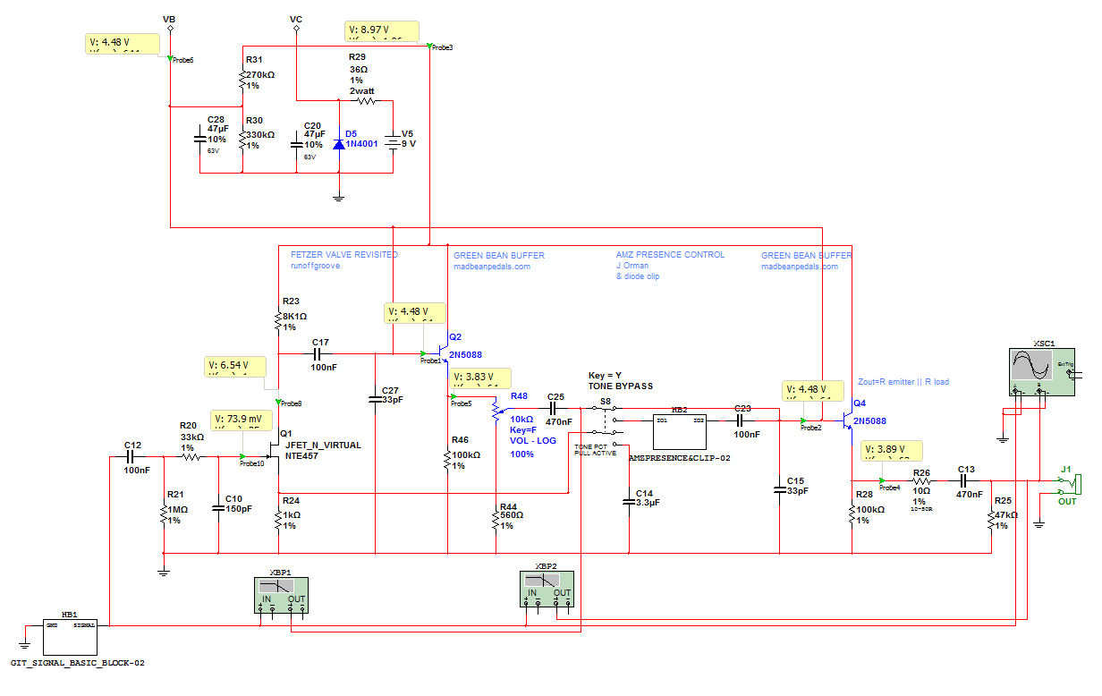

is it possible: Fetzer preamp + EQ + simple diode clip + Zout <1k
with:
- noninverted signal at output (in any switched position)
- using transistors, not opamps if possible (just because i want to learn more about them)
thank you guys
cheers
so JP, if i measure the actual Idss and Vp (pinch-off) of the exact transistor i am using, which i am doing using the circuit at the bottom of the Fetzer Valve Revisited page, are there caps or resistors that can be eliminated from the circuit?
i am new to transistor circuits (but am famil with opamps) so i apologize if some of this really basic.
other curiosities:
1. How do the 4117 & 4118 draw such low current but provide so much gain? what is the catch? it does have a high Zout. but does it sound nasty or something?
2. i am thinking of switching to an NTE457 for lower Zout, which will allow me a smaller series volume pot before the EQ (less noise?). do you guys think this is wise?
3. is there a noninverting buffer with Zout of <1k using a transistor?
here is my latest attempt
1. i moved the GreenBean Buffer biasing resistors to the 'power supply'. is it ok to create a Vb like this and bias the 2 emitter followers like so, or do they need dedicated resistor dividers for each tranny? also- how do i know these values are what i need. do i calculate current flow for ~1mA per tranny? i am new to transistors.
2. is this the best place for the volume pot?
3. i am still seeing loading effects on the passive EQ circuit (The New AMZ Tone Control) I am trying to isolate each section with caps, etc. but i must be missing something.
thanks
